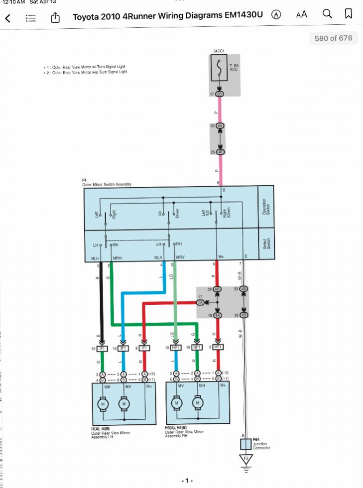

What fuse is tied to power mirrors?
2010 Trail Edition 4Runner. Owned for 8 years. Switch all of a sudden stopped working for both driver and passenger side.
All other switches work.
Driving me crazy
If I read the wiring diagram correctly (and that’s a BIG if) it’s the 7.5a fuse labeled ACC on the interior fuse block. I think that fuse powers other stuff too. If the problem were the fuse I think other things wouldn’t work.
Sadly I can’t get the screen cap to show up.
