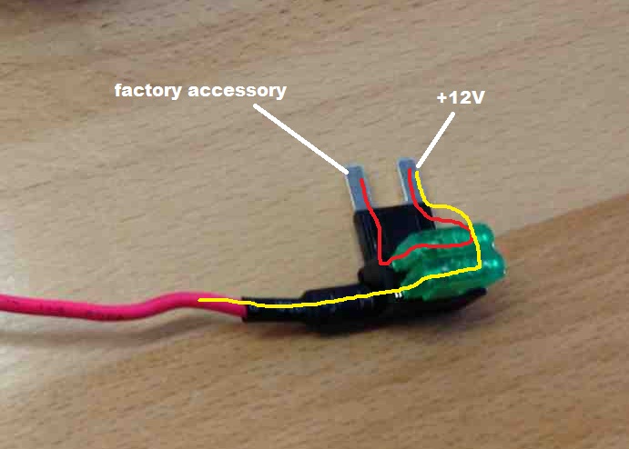

Hey Vegas, I made a quick photo to hopefully clarify how the fuse tap works, it's a real simple concept once you visualize it.
Basically the red line is the original path for the power of whatever fuse you are tapping into, and the yellow line is the path you are shooting for to protect the newly added accessory. So do you see how if you happened to insert the tap in the wrong way it won't be pulling the power correctly?
If you follow the direction on the back of the packaging I think you can figure it out from there. Make sure to only have the accessory fuse in the tap when trying out which orientation to plug in the tap (with both fuses in there it's going to work no matter what since it's effectively one solid wire all throughout :))
I hope that helps paint a clearer picture for you!

If you install them the wrong way you basically bypass the fuses and run a direct line.
Umm, can you explain this to me.... I'm not seeing it clearly.
Even looking at the beautiful photo of how it works, I don't see how if it reversed that the fuse(s) would be bypassed.

Sure. Take a fuse out of the fusebox. The pins that the fuse plug into are now visible. One side supplies power (source) the other side sends power to something(feed).
If you plug the tap into the fusebox and the source side happens to be the side of the minitap that has the output wire, you effectively bypass the fuse. Power needs to travel through the fuse to the output wire in the tap.
Make sense?
