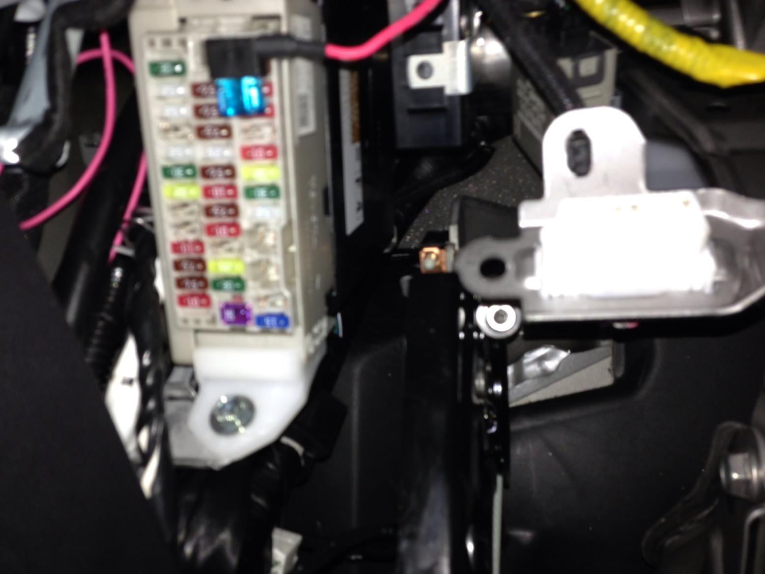

Arrrrrrgggggghhhh..... I thought I had it installed the correct way, keep in mine first time using a voltmeter (had to get a quick lesson from janoforhire) but after read a few more post I need to double check I wish the fuse panel had a plus and minus side for dummies like me... Below is a pic of the way I have it installed. But I am in London for the week so I had to put the build on hold... My GF said I can't play with you guys right now :(

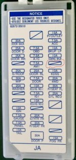

I have done that a few weeks ago and found an unused switch circuit in the fuse box under the dash...just under the "towing bkup" circuit.

I think you were correct, at least in the sense that you are using the "wrong" (as in, opposite) pins.
Since flipping the tap-a-fuse will put the red wire (leading to new item) on the opposite female slot inside the OEM fuse block. Considering that both will have power assuming the (OEM) fuse is not blown there would be no serious impact. The red wire can ONLY get power thru the new fuse from the male tab you drew, regardless of which female slot it is plugged into.
If anything, installing the tap "backwards" provides added safety in that it now double-fused (ignoring fuse ratings as installed).

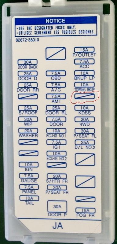

Curious to see if the empty fuse location below 10A ever worked out for a fuse tap? I'm looking to do add in a 12v line for a aftermarket BU camera and need powah.
I just did a tap a fuse in that location on Saturday and it works fine. Switched on with the ignition. Go for it!
Spot #1 (which is blank) is +12VDC all times, 10 amps
Spot #2 is +12VDC controlled by headlight switch, 7.5 amps
Spot #3 is +12VDC with ignition, 7.5 amps
Instruction for the add a circuit are pretty obvious and are discussed by others in the last 5 years of posts in this thread, but I thought the above notes and below pic might be of assistance to others looking for a certain fuse output.
