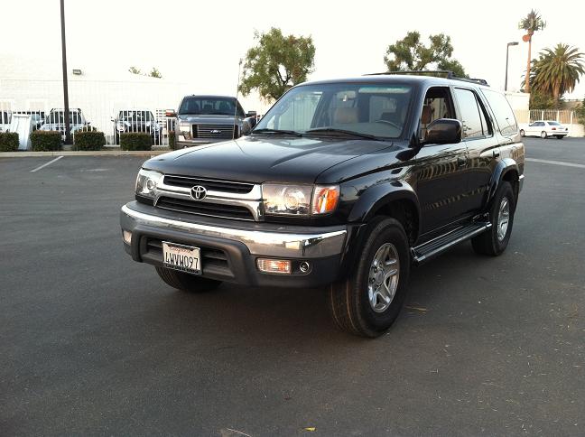

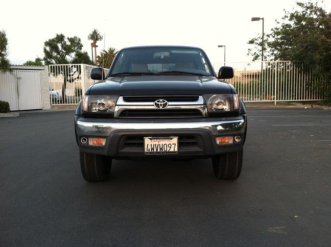

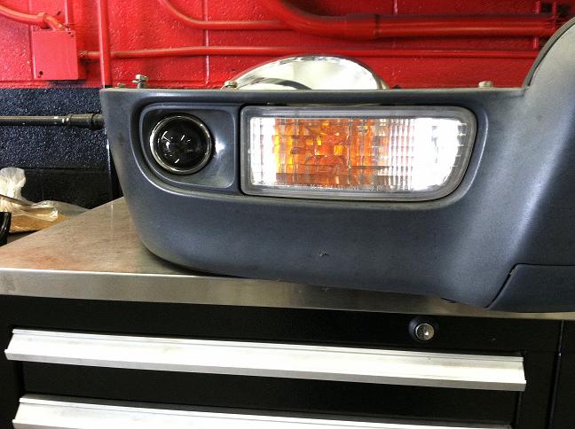

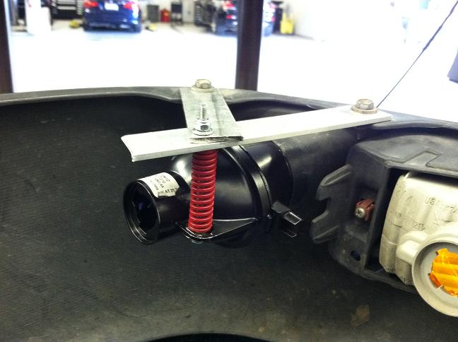

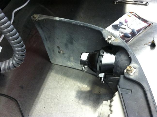

Has anyone done it on the 3rd gen? Just finished my fxr 3.0 with Philips 85122+ about a month ago and just got my fusion fogs in. I am going to attempt to install these fogs in the tight space of the 4runner and run morimoto 4300k bulbs with it.
update of the fusion fogs on the 4runner and the fxr 3.0.

It looks pretty straightforward from the pics. Just need to fab up a bracket for the light and splice in a new plug for the bulbs. I'm curious if this is much of an upgrade over the stock fogs.
Thanks guys, probably won't write a write up because it is pretty straight forward. You just have to trim a little off the bumper and then the fogs will be able to slide in an it sits in good, then just do a custom bracket and mount the fogs. My 4runner didn't come with fogs so that's why I bought these since oem are way too expensive.

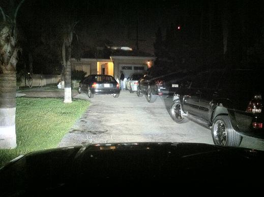

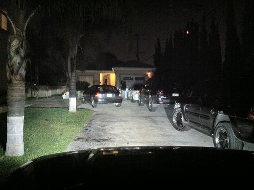

output shot of the fusion fogs with morimoto 4300k bulbs and cheap xenon ballast, ignore the crook, the car was on unlevel ground.

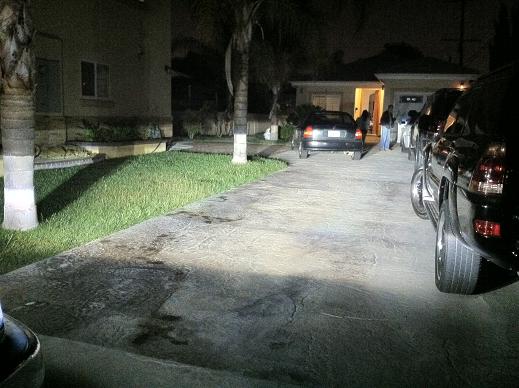

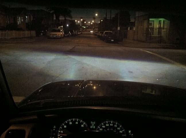

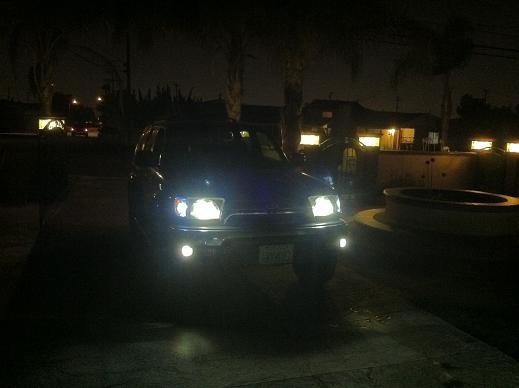

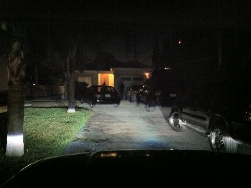

here's more pics.
first and second picture if fxr 3.0 + fusion fog
third picture if fxr alone
4th picture is fusion fogs alone.
lights are as bright as the picture, camera just made it super bright, but the lights are amazing though.

I am actually about to do the fxr 3.0 retrofit myself and i was wondering what mounting method did you use? Also, where did you get the fusion fogs from? I wanted to compare prices between those and the Hella Micro DE since those fusion fog lights seem to be just as good if not a little better
i used jb quick to mount the projector on and then jb weld for final mounting. the fusion projector i got it off of hidplanet.com off a guy for about $90 shipped brand new. they are really good, you can also modify it to have more foregound light.
