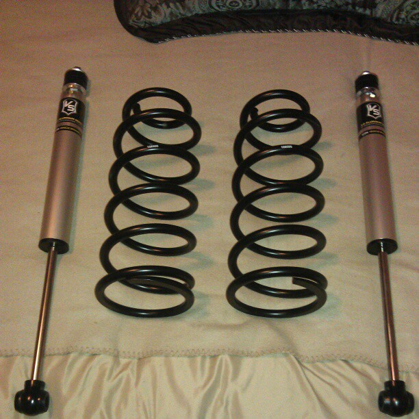

***update 11/07/2012: Purchased icon rear coils and rear shocks along with toytec eibach height adjustable coilovers and differential drop.***

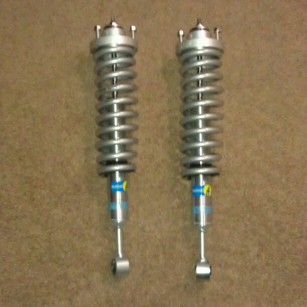

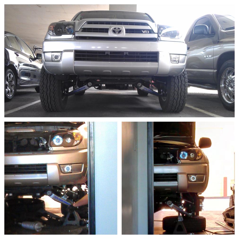

Well, I decided to go with icon rears and toytec/eibach height adjustable up front with a differential drop. :biggrin2:

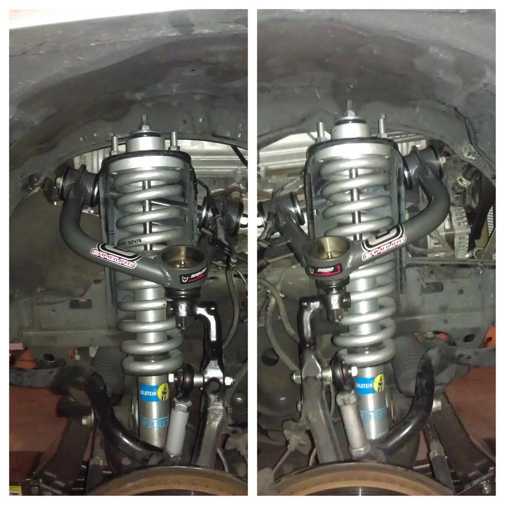

So far I have done the 06 blacked out head lamp mod, fog light mod, installed the t1809 head unit and...
Finally installed camburg ball joint uca's that I had laying around since last summer.
