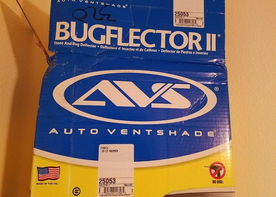

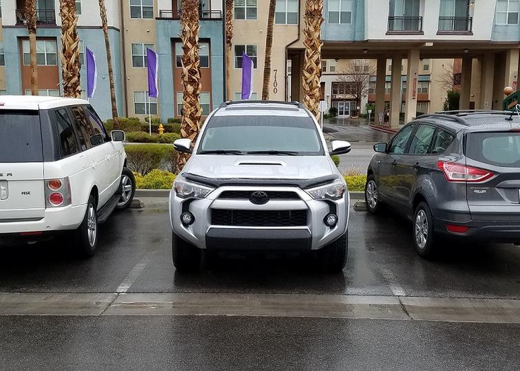

So I ordered the other part # 23017 and it fits perfectly. Five minute install. The label stated 2010-16 4Runner. I think the one that did not fit said 2010-13.
This one is the low profile. Thanks for posting the info.

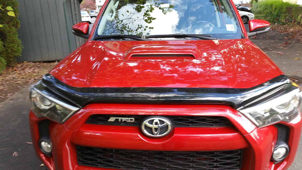

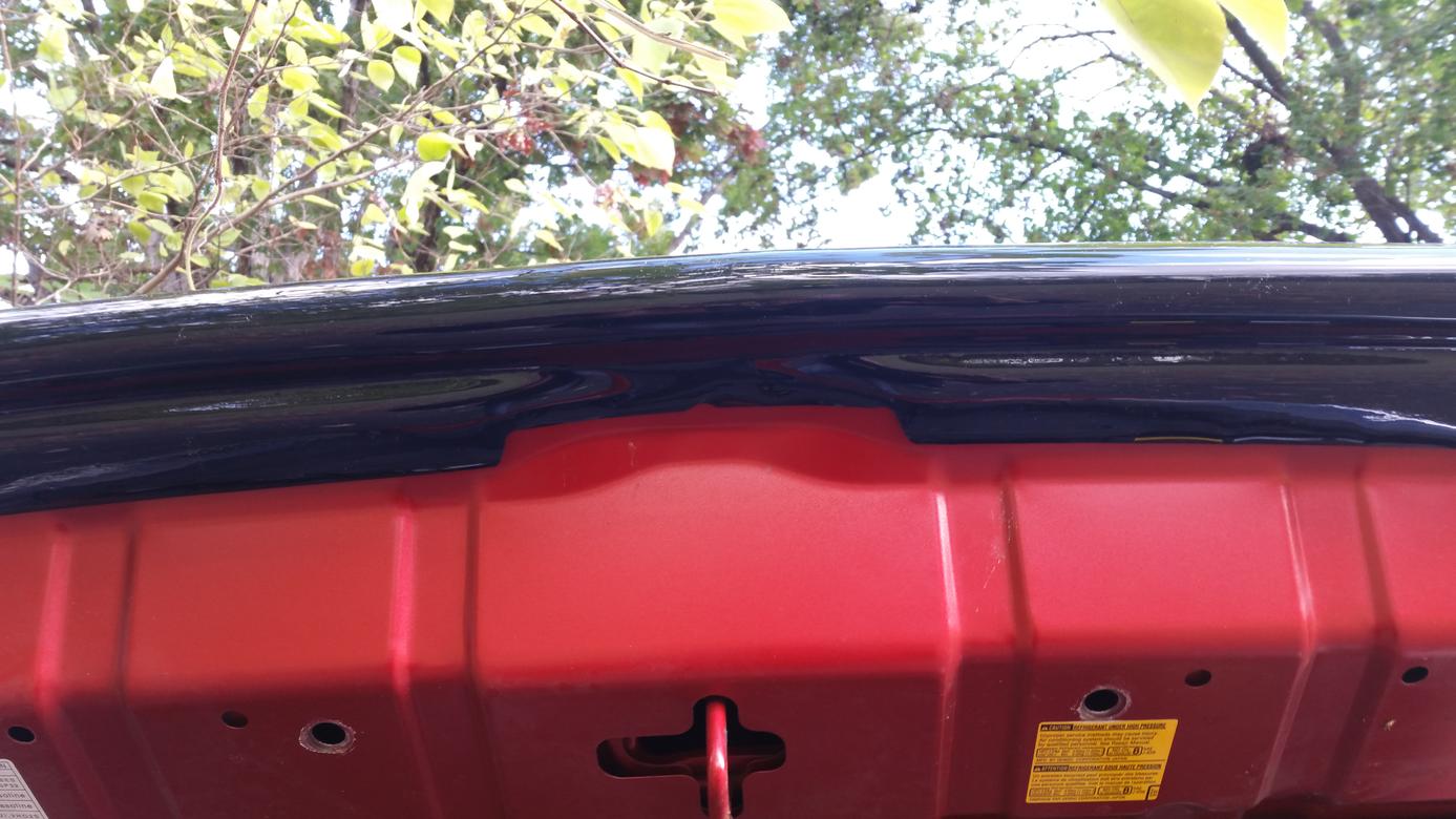

This one fit mine no problem...2016 TRAIL PREMIUM, This one uses metal screws /with plastic fasteners. Also comes with bumpers, but I did not use them. This is the higher profile model. As for bugs ...It's not going to stop a whole swarm of bees crossing my path on the highway in the summer from hitting my windshield and roof top. But I'm sure it helps some. Works fine in the no touch carwash after several washes.
