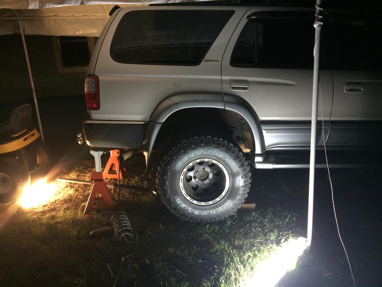

Thanks and you may have seen it but it was pretty stock before tonight. Here is a mock up of the rear. The damn techs at Kauffman gouged the mess out of the inside of my wheels. Trying to figure out how to handle that.

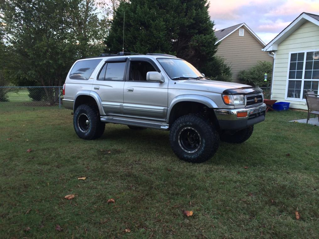

I finally finished the lift, trimming, grinding, diff drop and coil adjustments. The hardest part of the entire job was removing the damn rear shocks. Here a a a quick pic.

So just a little update since the install. The truck feels great. I feel like I have the perfect set up for what I wanted. I do think I will need to add a 1" body lift to get complete clearance when cornering hard or backing up turning. Its really not to bad as long as I am self conscious of the way I am turning.
As for the goodyear duratracs I am very satisfied. Minimal road noise and the ride is great. The fact the wife is cool with it makes it even better. She just laughed when she sat in the drivers seat. Oh yeah if I haven't mentioned it yet she is 5' tall. So it is a bit of a jump to get in. Hence the reason the steps are still installed and trimmed for clearance :)
