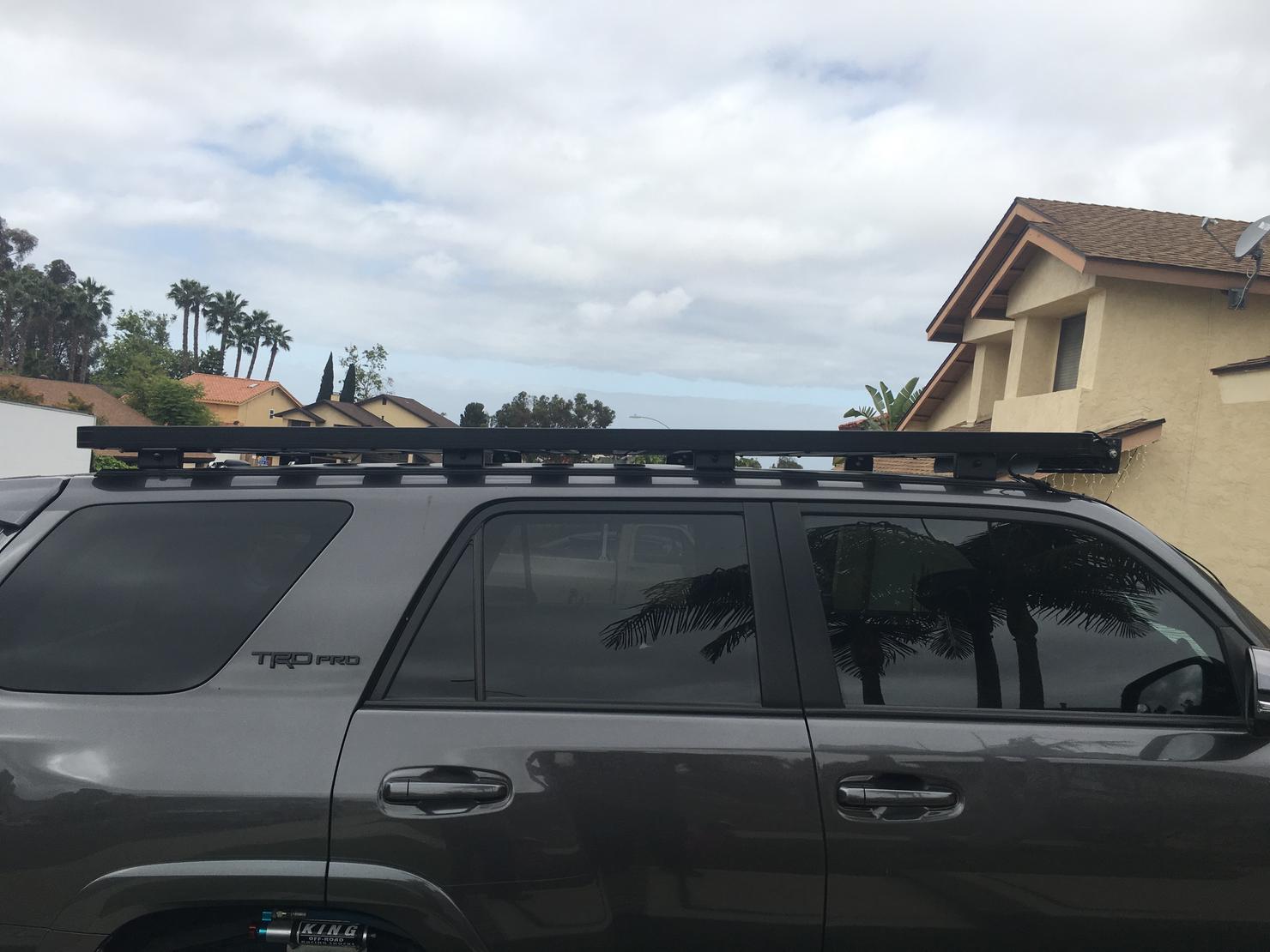

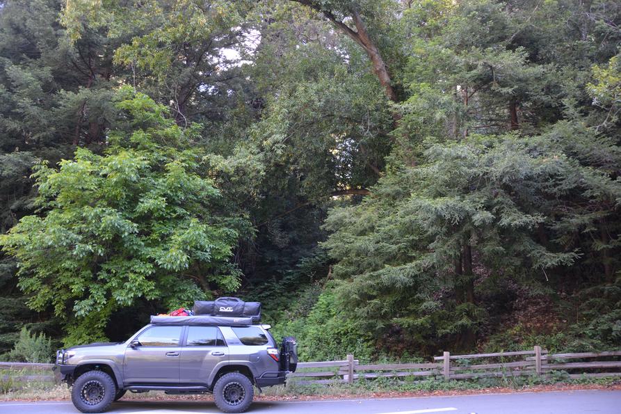

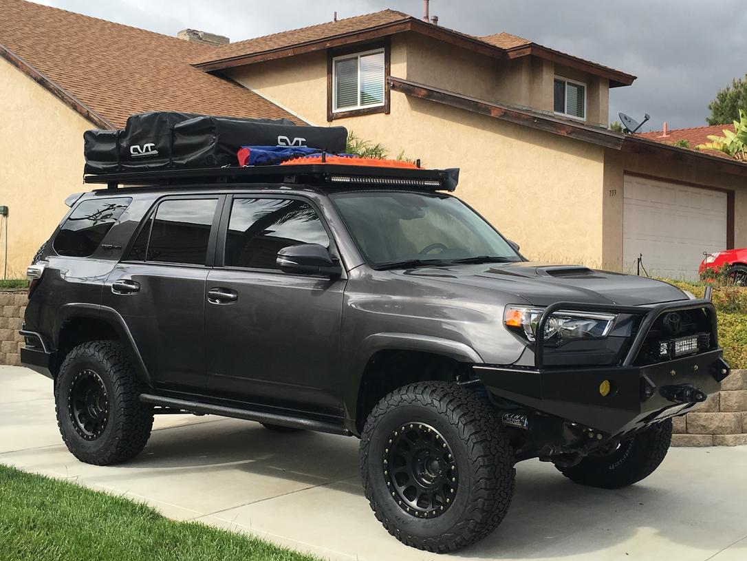

Shortly after the big bear trip I ordered and installed a full length FrontRunner rack. Besides it being lighter, having more usable space, and being aluminum, i wanted the lowest profile for my future tire plans. i originally had the standard 60mm and 70mm (Front) feet but quickly opted for the low profile 40mm and 50MM feet.

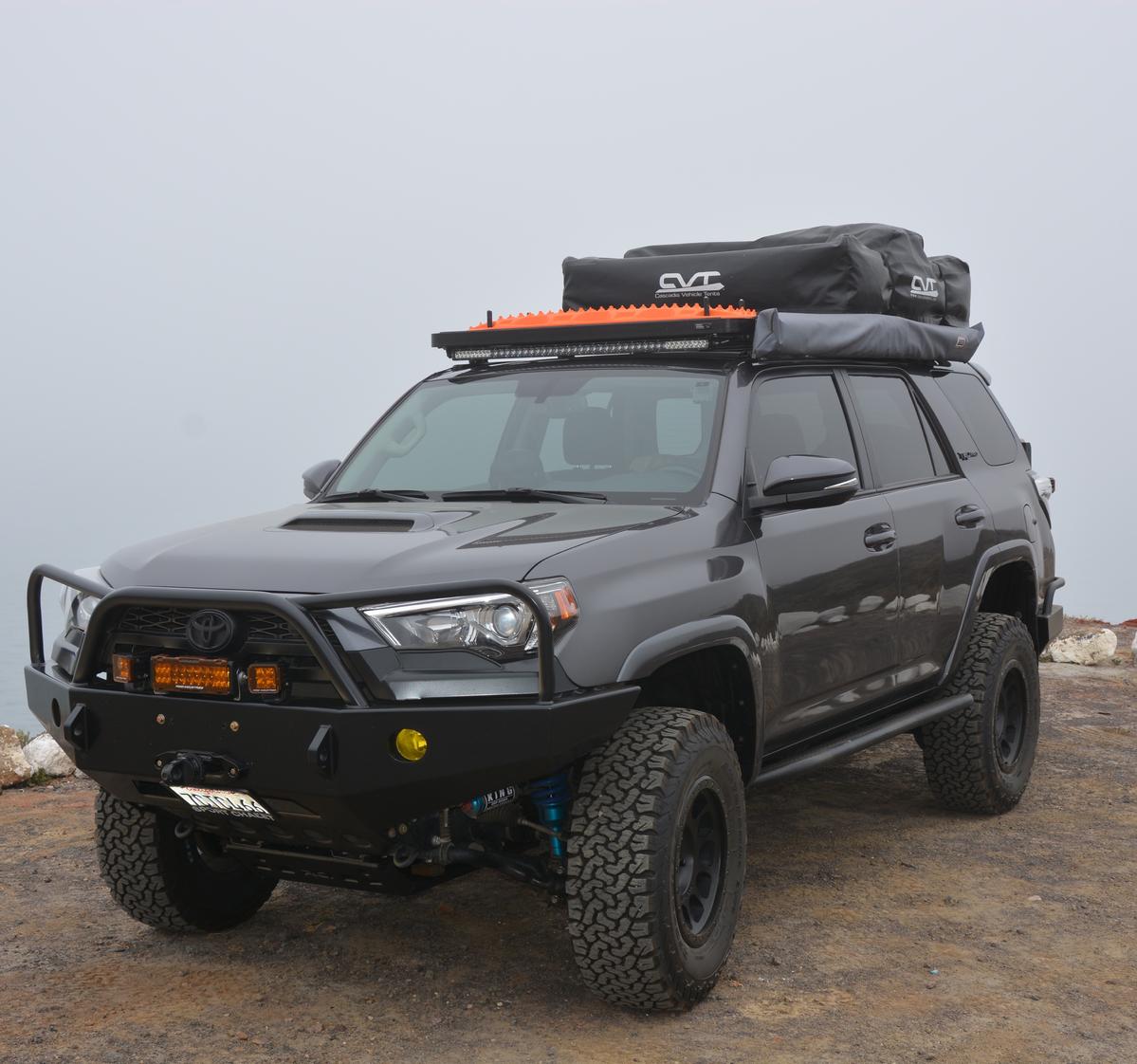

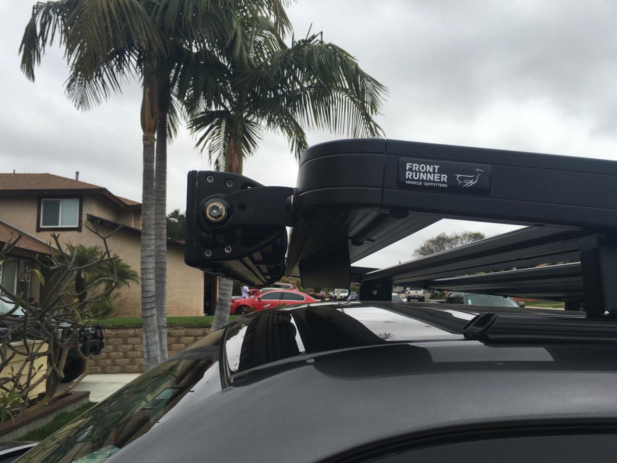

with the lower profile feet, the 40" E series light bar didn't fit underneath so i mounted it to the front. I got a tremendous amount of noise out of it so i ditched it and got a 40" SR2 mounted on the bottom leading edge and it works perfectly.

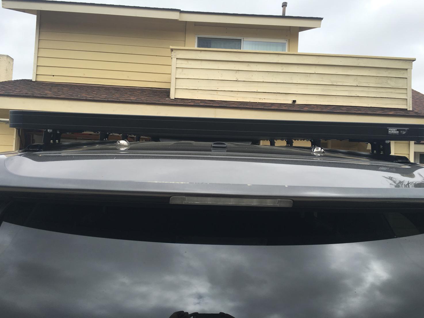

Here you can see the clearance you get with the 40MM feet and the low profile XM radio antenna.

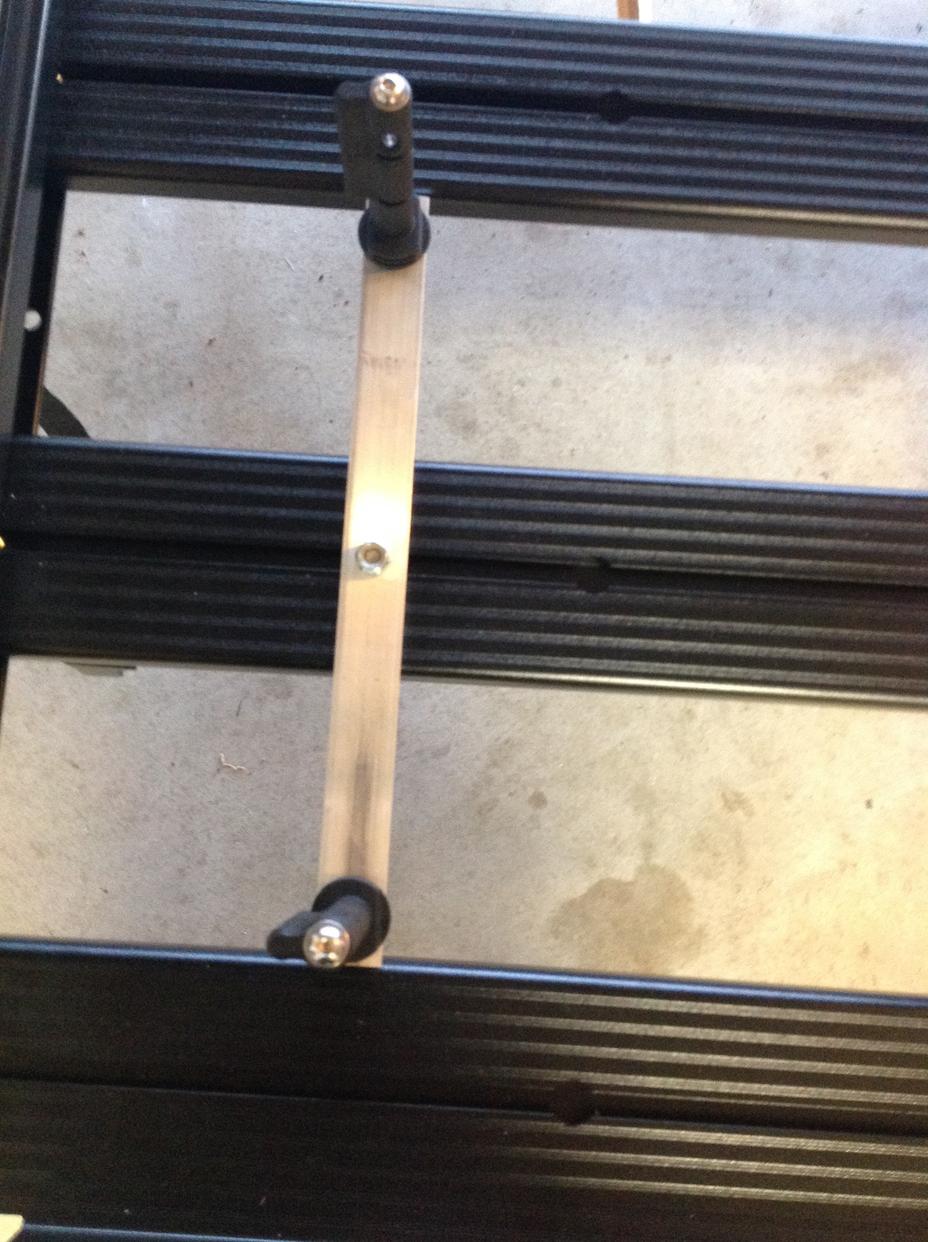

built some simple Maxtrax mounts out of aluminum stock and the matrix pins.
overall, i couldn't be happier with the setup. there are some pros and cons of course, i can't fit the FR table under the rack and it's a pretty tight fit for install but I've managed to get a system down to remove it. The truck is reckless most of the time unless i have a trip planned

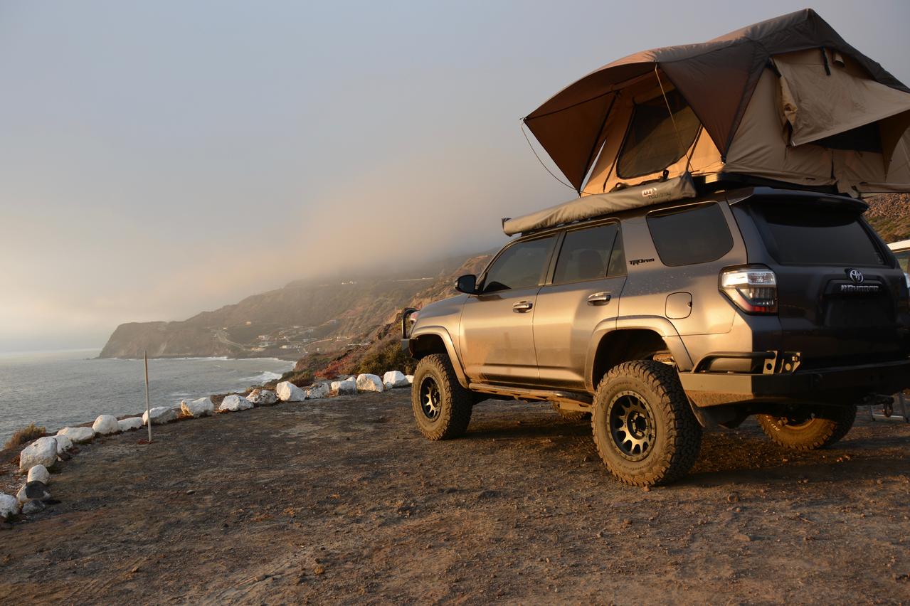

In May, My wife, Daughter, and I took a quick weekend trip to camp in Big Sur.
We stopped in Santa Barbara for breakfast, played for a couple of hours in Pismo and ended up in Big Sur about 12 hours later.

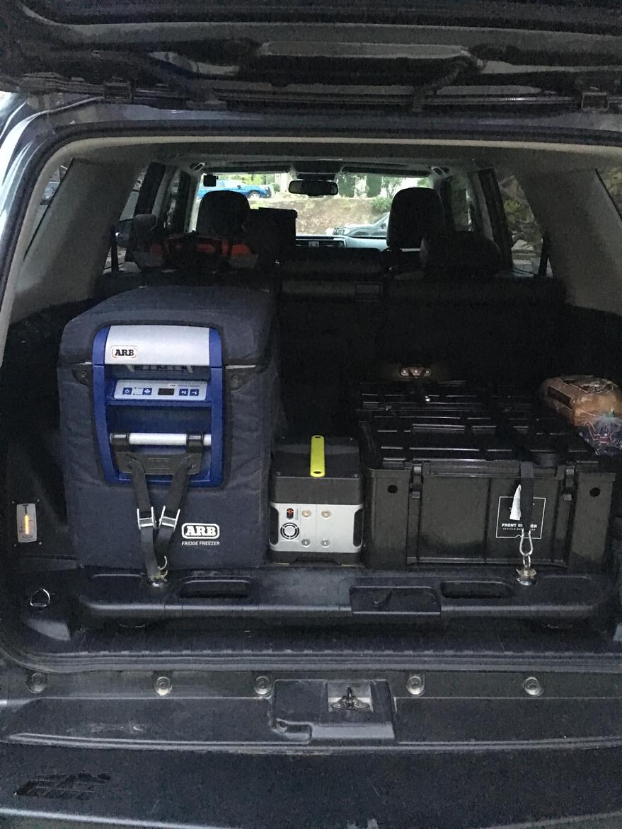

Packed up the rig with all its new goodies and tried my best to keep things organized on this first official family trip.
We camped at Pfeiffer Big Sur State park and it was awesome. i highly recommend it for people passing through.
It's experiences like this that get me excited to take my wife and daughter to places we normally wouldn't go. Building the truck up gives me the piece of mind that if we decide to take it off the beaten path, we can enjoy ourselves and more importantly, make it home safe. Looking forward to many more trips with them.

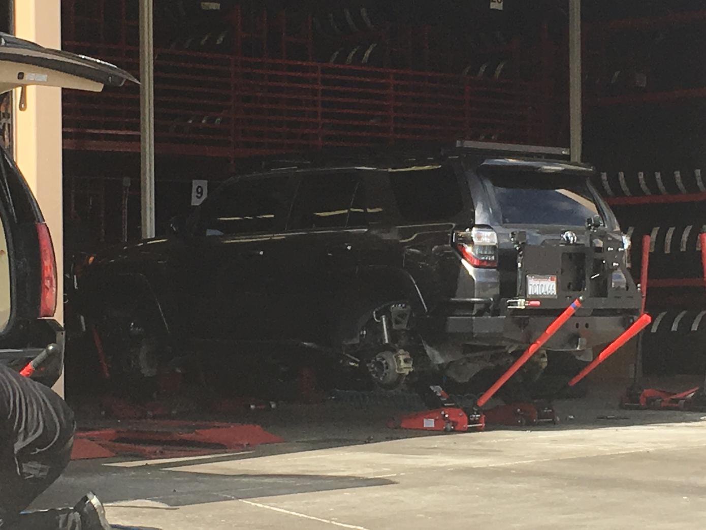

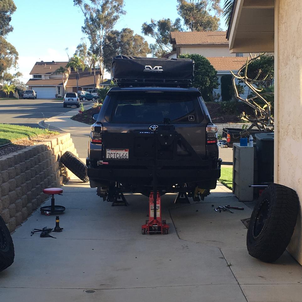

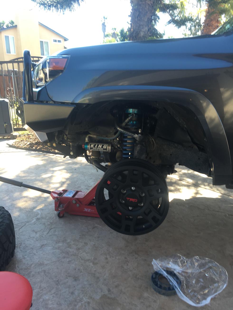

After the Big Sur trip, i decided that the OME 896 rear springs weren't quite enough for the full load and decided to go back to the OME 897's i had purchased last year. its quite the stink bug when completely unloaded (No rack, swing out, and accessories), but i'm old enough to not care so much about looks alone and went with functional.
I played around with the idea of switching wheels but the 7" width of my buddies TRD wheels killed it for my future tire wants.

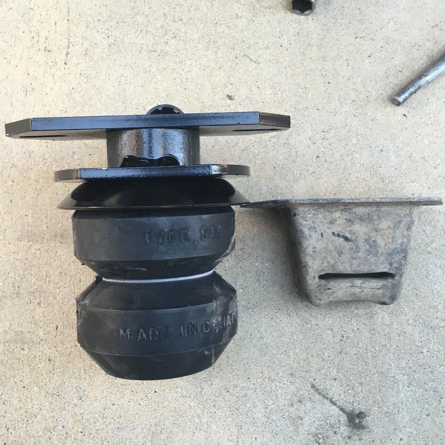

I also decided to upgrade my rear bumpstops since it was getting pretty heavy and desert go-fast is still something i enjoy doing.
I also decided that with the plan to lighten up the rig, i wanted to get some All Terrain tires. I was going to, and still plan to after this set, go with some 35" ATKO2 but will have issues with the way my KING reservoirs are mounted right now. so i ended up with 285/70-17's and am happy overall.

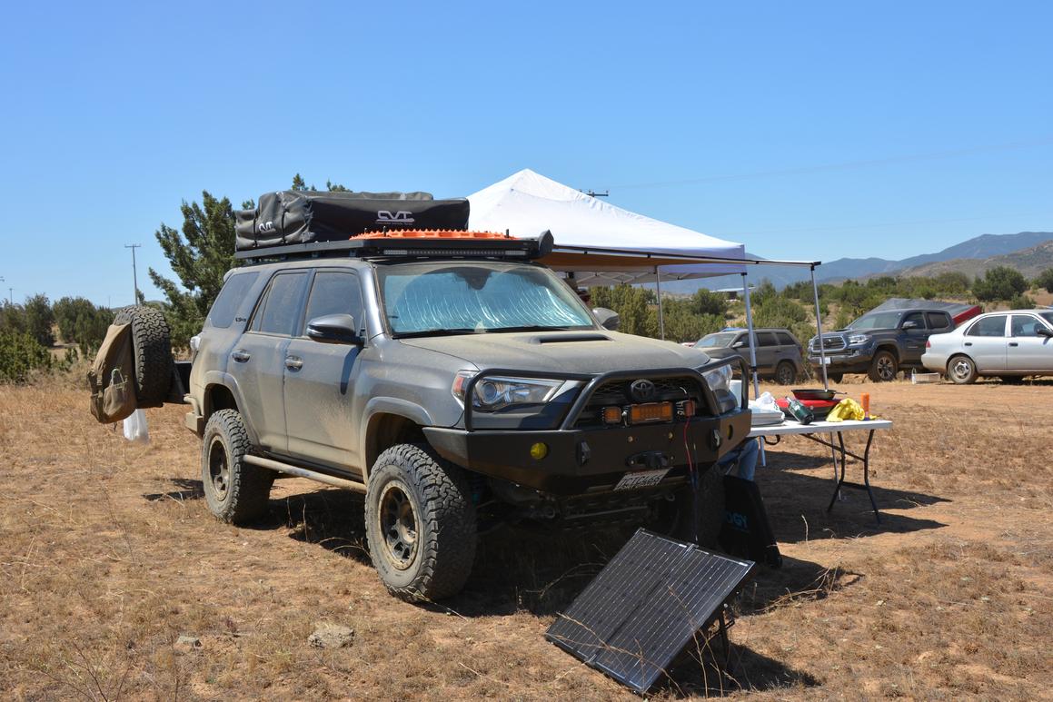

In June, A couple of buddies and I went to Baja for the 500.
We camped at this place along the main highway to Ensenada called Playa Saldamando and it was pretty great with fantastic views and a $15 camp fee.
After we checked out the tech inspections in downtown ensenada, we made our way to the scorching turf known as Ojos Negros. Had a chance to test the solar panel and came away happy with my overall setup. Thanks for the idea [MENTION=44305]weeeee[/MENTION]

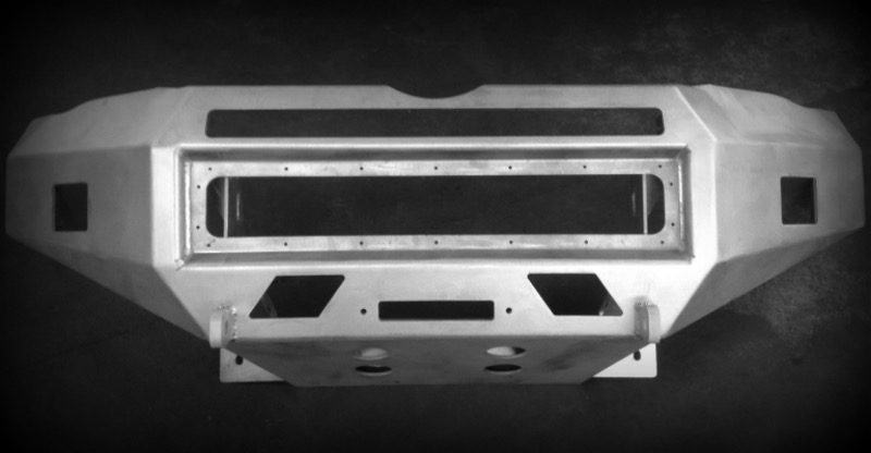

I ordered up an aluminum Pelfreybilt bumper since they are having a sale right now.
i will have my Shrockworks bumper available for sale if anyone is interested.
