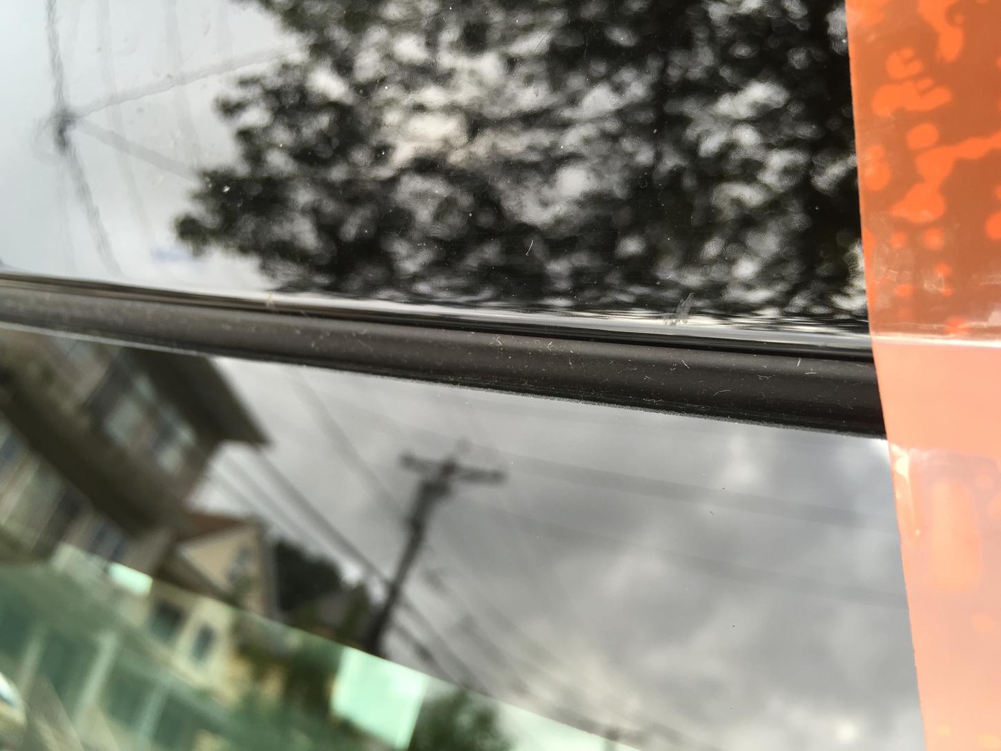

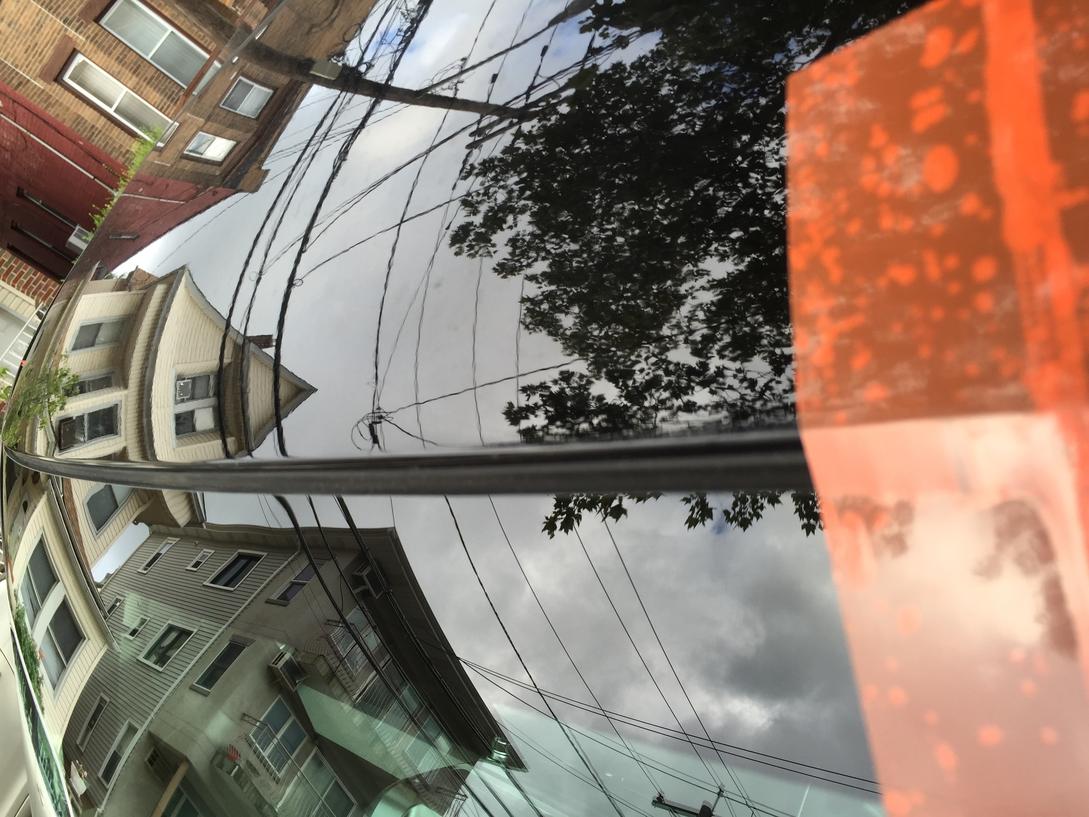

I just had to get my front windshield replaced. An 8 inch crack developed on the top of the passenger side, just next to the rearview mirror. Safelite quoted $326. I got the work done for $315 at a local, reputable auto glass shop. Looks like OEM glass, with the heating element and correct attachment for the auto dimming mirror.
There is a 1/4" gap now at the top of the windshield. Photos attached. Is this gap normal? I didn't check the gap before I had the work done. Can anyone look at their vehicle to compare the size of the gap?
I'm worried that there should be some weather stripping in the gap and that I could have issues with rain if I leave this problem unchecked.
Thanks.

There is no weather strip. Mine has a gap, probably a bit smaller, but it's there. It collects bugs. Not much you can really do about it.
I have three 5th gens in the household, and the 2014 had to have a new windshield. As with you, after replacement I noticed a gap and compared it with both 2015's. I even used calipers. Turns out, the factory installation has a lip (or something) on the gasket/adhesive that the aftermarket does not. Although the gap is slightly wider than factory, the appearance suggests more of a change than actually happened. In my instance, after measuring, I found the windshield to be slightly crooked, so that the gap was bigger on one side than the other. Fortunately, I dealt with a very reputable shop. They pulled the windshield and reinstalled. Lesson learned: skip the convenience of having it done at work/home and take it to their shop. When asked point blank "what it the best way to insure an accurate installation?", the shop manager acknowledge that "in my shop, with two people is the right approach." It's now all academic, since we just had another crack and are repeating the replacement tomorrow.... AZ is very tough on windshields.

Noticed the exact same thing after I had my windshield replaced. Couldn't tell you if it was there before because I never thought to look, but you sure notice it when you go to take the tape off. Perfectly normal apparently, and haven't had any issues.

The gap is somewhere between 3/16 and 1/4, so I don't think yours is out of spec.
(from the photo above it looks like the replacement gasket is thicker so there is LESS room for crap to build up ...)
