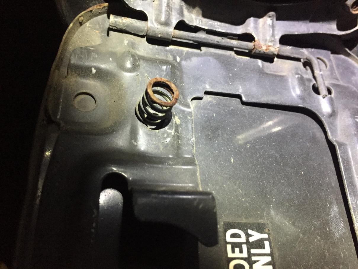

No need to even go to the dealer. Dig around and find a small spring and screw it into the hole. 5years now and it works perfectly

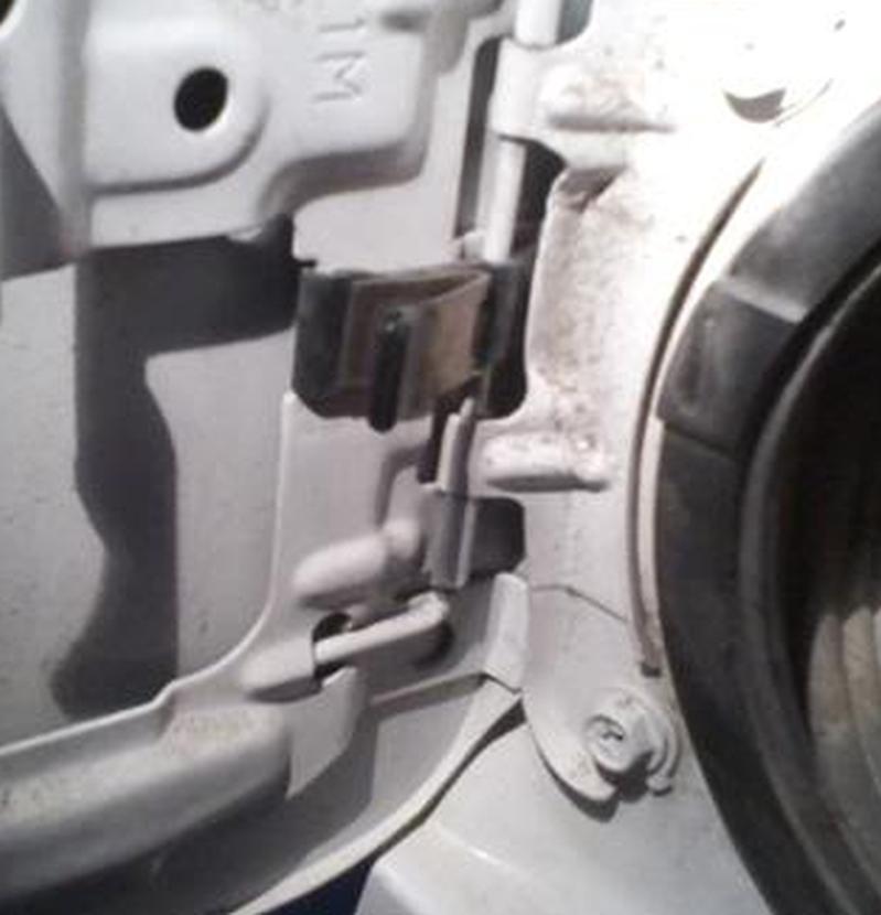

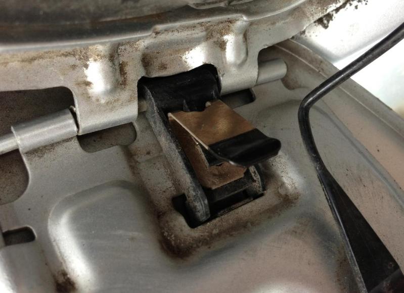

You must still have a spring which is just week.
Mine is totaly gone so it would take two people to open it.
With one person the latch pin prevents prying it open.
Some people have the clip broke in half.
Others have the plastic broke.
Some just the clip falls out on the cement floor.

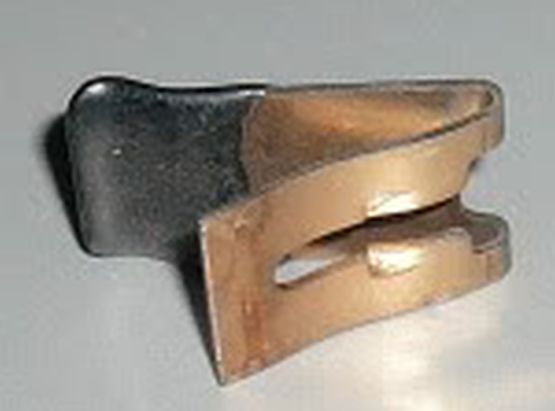

The clip is cheap from the dealer. Pop the old one off with a screwdriver. Slide on the new one and snap it into place.

Correct replace your clip. I used half a ballpoint pen when my snapped and I need a new spring clip
