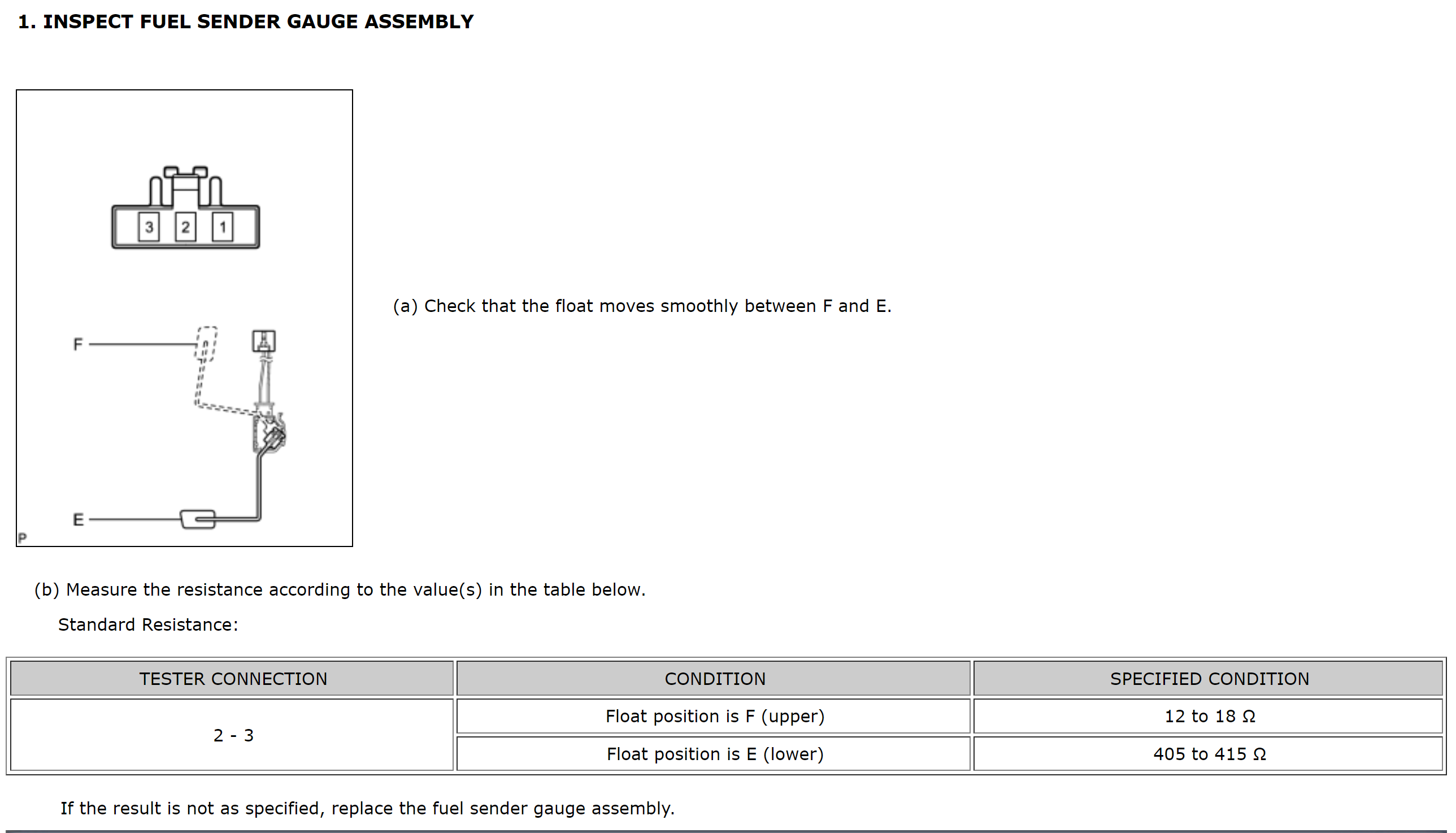

If you're interested, I have the fuel gauge troubleshooting procedure saved from TIS, it shows some tests you can do with a multimeter to check the circuit without dropping the tank. Or you can shoot in the dark and buy a sending unit and replace it. Some of the more advanced tests require Toyota dealer tools.

I'd very much appreciate it if you could post the Toyota procedure for troubleshooting. Thanks
Here's the diagnostic procedure.
