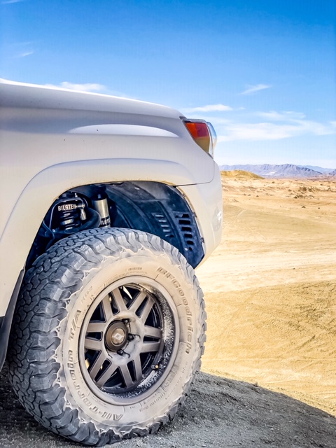

I think this theory is correct. I recently went from Bilstein 6112/5160 to 8112/8100s and saw a drop from ~16.0 MPG to ~14.8 MPG. With the 6112's, the 4Rrunner had slight rake, but with the 8112's, it's now pretty much level. Everything else has remained the same; the suspension has been the only change. I'll be asking Bilstein the front a hair and report back. Obligatory pic:
