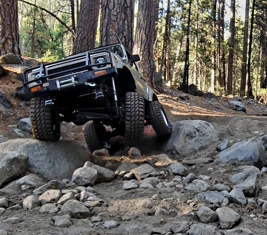

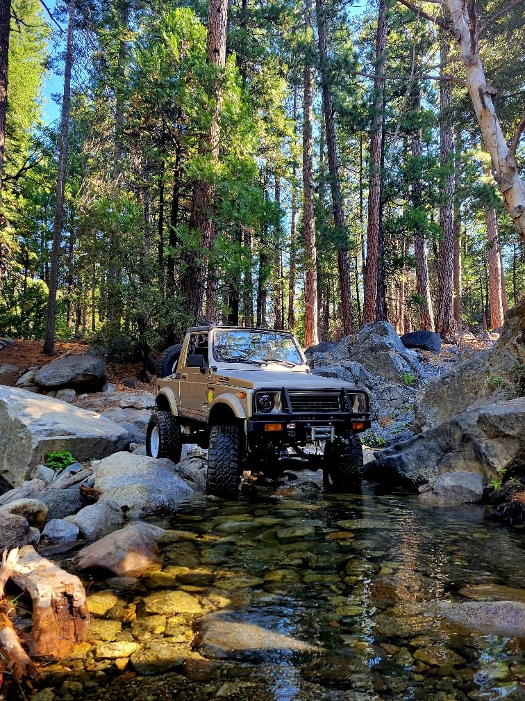

I made it twice running Alpine to Utica. First time solo through the new section with no issues. Second time, broke the CV coming down the gauntlet of the new section.
This is how i roll now...
