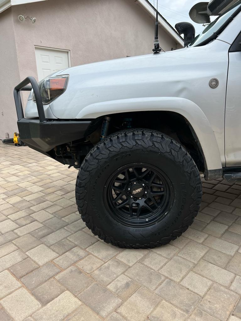

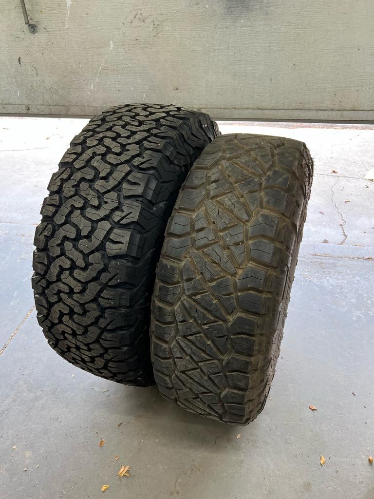

Mounted they stood just about 34” tall. Here is one mounted on a wheel next to an unmounted 285/70/17 Ridge Grappler with about 99% tread left.

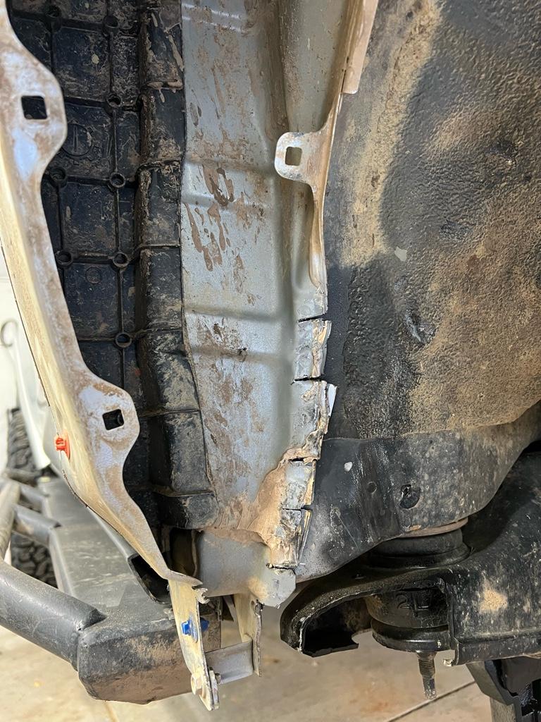

As you can see once mounted it was really apparent I needed to do a ton of clearancing for these to work off-road.
So off I went to grind down more body mount and to flatten the pinch welds.

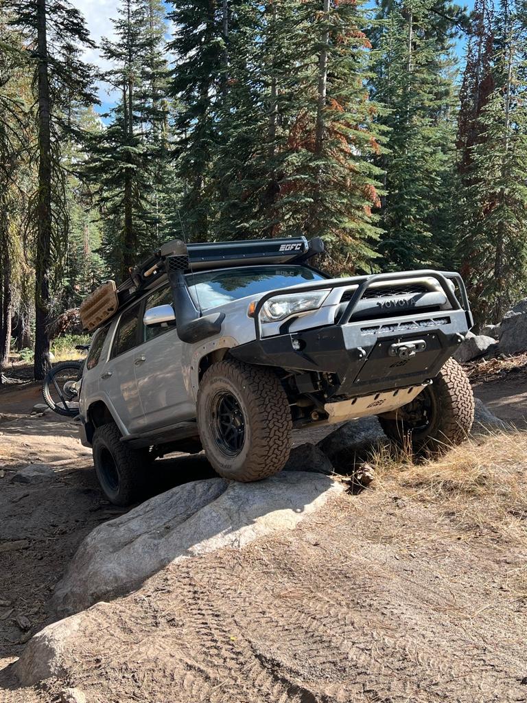

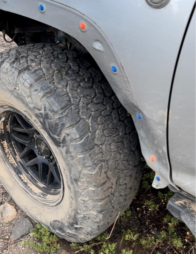

Now it was time for some off-road driving impressions. We had a weekend up in the Western Sierras for some mountain biking and moderate wheeling. So I thought it would be a perfect opportunity to test clearancing. I removed my fender flares ahead of time because I knew they would be a problem.
So off into the mountains we went to find some great campsites and rocks and ruts to play on.

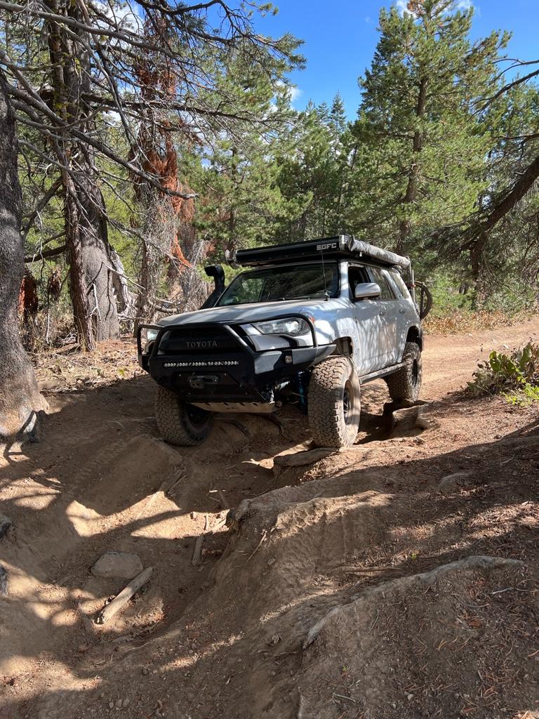

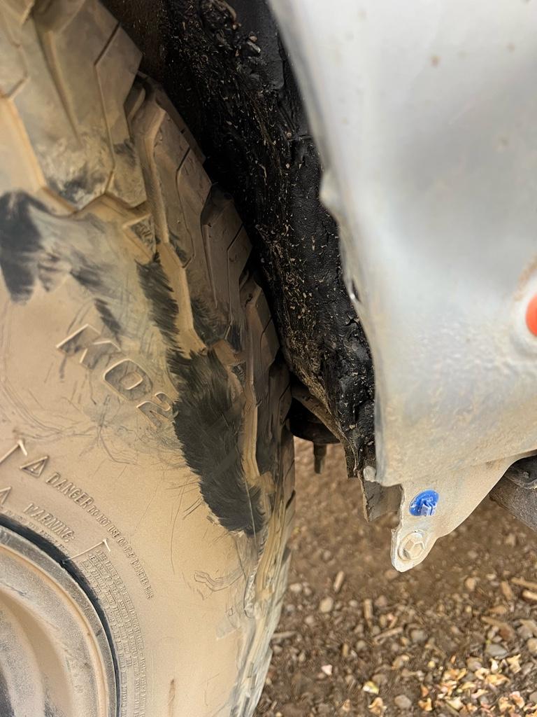

As expected the tires showed me where I needed to do more clearancing at full compression. Fenders need to be cut, BMC dialed back and firewall beat back.
So the real question was how did they do off-road? Here is what I think:
1. Steering - I definitely felt an increase in bump steer when going over rocks. Not surprising since these larger tires have a lot more rolling mass.
2. Clearance - It was nice to be able to roll over larger rocks without tagging my skids and rear bumper. I’ve done the rockier part of this trail many times before and there was definitely a difference there.
3. Crawl Ratio - When in 4 low the negative impact of messing up my crawl ratio was felt. The truck was rolling faster especially in 2nd which meant much more brake modulation descending steeps and crawling rocks. Obviously this will be corrected with gears later down the road.
4. Traction - Traction felt it was a bit reduced on dry loose rock vs. my Cooper ST Maxx I ran previously. Not surprising since these have a much less aggressive tread.
So for me the jury is still out on this size tire from my perspective. It required a lot of work to fit and will need even more in the future to do this really right. I also question the durability of the stock steering components now that they are turning such huge tires. I foresee also having to upgrade the rack in my relatively near future. Although I heard upgrading to an LC200/Tundra rack doesn't really solve things either.

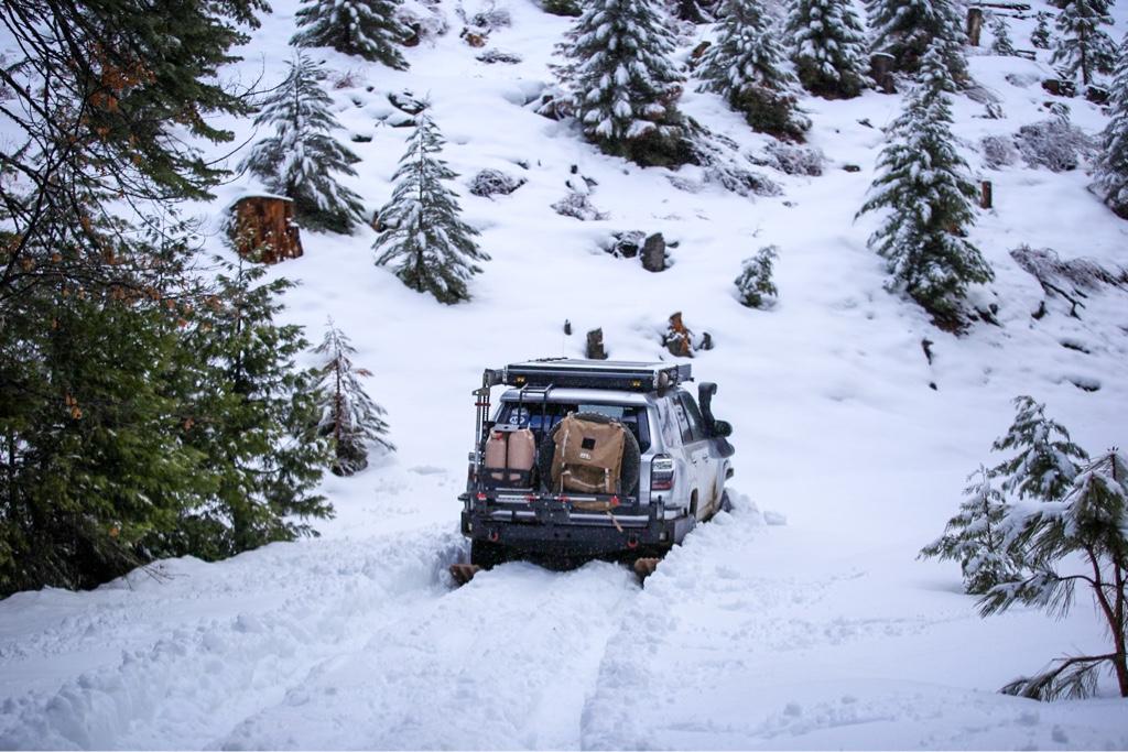

I went with 315s because I do a lot of snow wheeling in conditions where the snow is very deep and I need flotation. Also mud is pretty rare here outside of the PNW and most of my wheeling is over dry rock which K02s are great on.

Understood the float on snow. Thanks for posting the pic. ON mine I went the opposite way and went skinny and thin on snow. My area is like yours, not a ton of mud, but lots of gravel, rock and crap with tons of snow thrown in.
Skinny tires work on snow that has pavement underneath it so you can cut down to the bottom. Not so much in snow that is 10-20ft deep in a lot of the off-road snow wheeling situations we have here. At least that has been my observations
