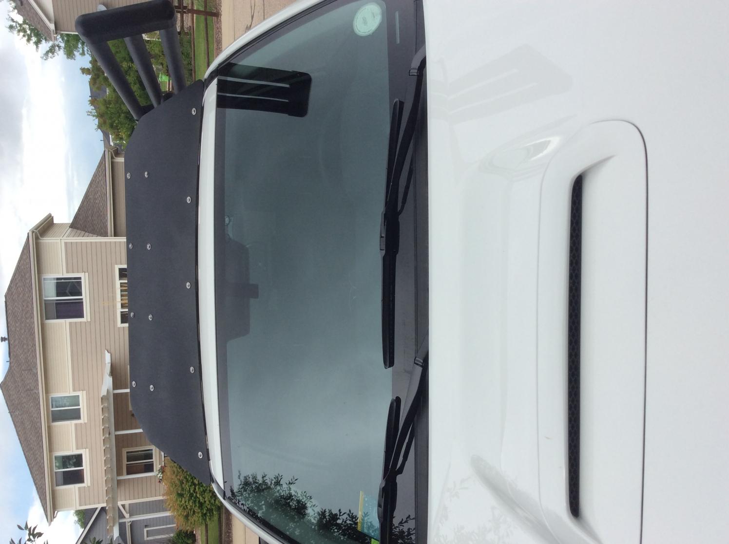

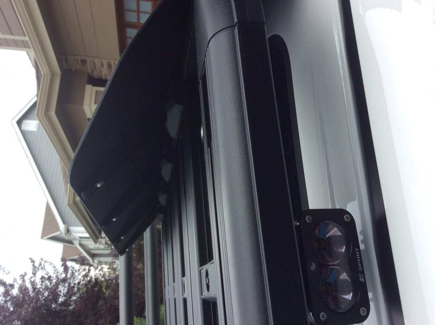

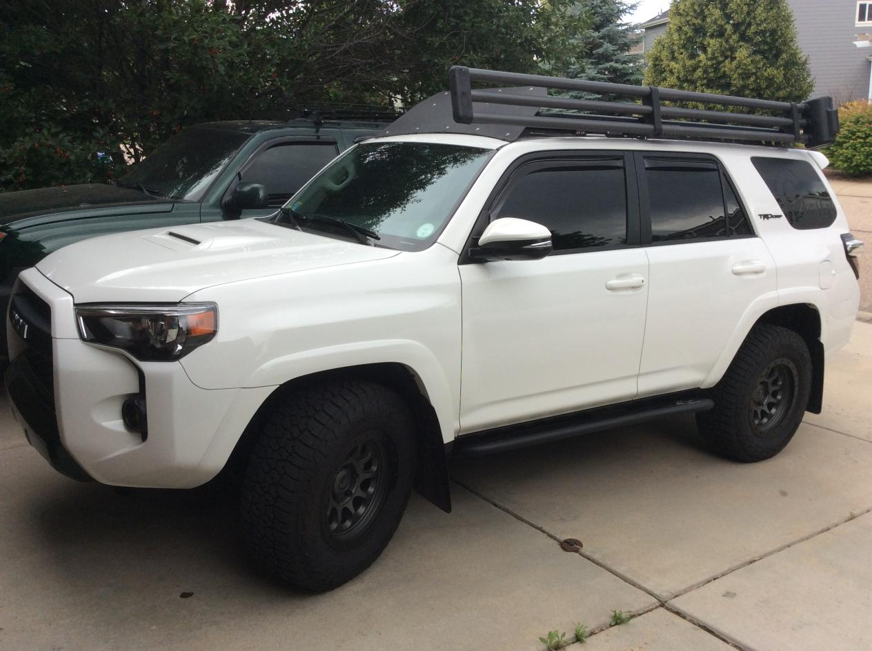

so you MADE your own faring? or purchased it? does it just go from the roof rack to the roof? or does it extend to protect stuff on the rack from wind as well? any pics?
From the roof and up and over the rack to protect stuff (stuff, RTT, skis) as well. Water jet cut aluminum, bedliner, hardware is black now. Huge difference in wind noise as well. Modified hardware from Rhino racks fairing (theirs was terrible)
that's a nice job!
