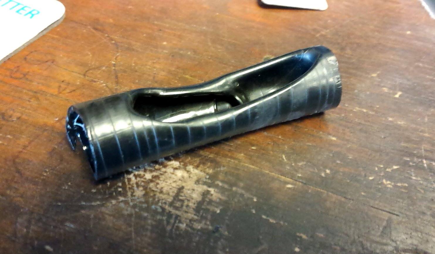

I had this same issue last year. Mines a 2002. Prior to the fueling issue coming up, I had an on and off CEL that pointed towards the charcoal canister needed to be replaced. I didn't worry about it til I could no longer put in more than 1 gallon at a time into my tank. I replaced the charcoal canister and still had the same issue. A couple weeks before that, I had an exhaust leak which ended up pointing a section of the exhaust up in to the cabin. The heat from that ended up melting a section of vent valve that exited the tank. Not sure if that will help at all or if I might have just been an outlier.

I am going to crawl back up under the vehicle and double check that no hoses are colappesed. Last time I checked nothing was, but I may have missed something. Its also really hard to see whats on top of the tank. Could be an issue up there.
