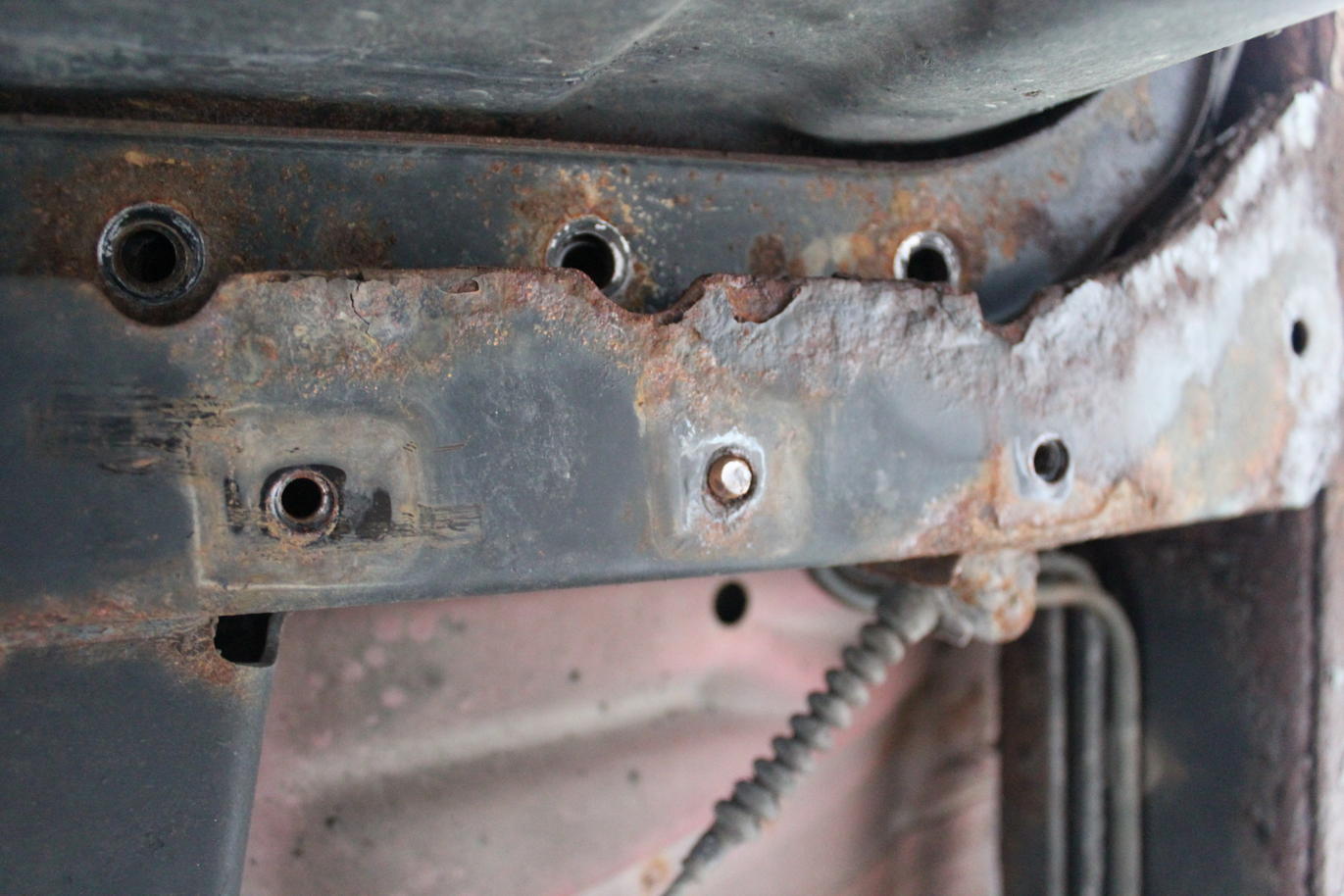

Instead of starting a new thread I figured I just pig this one. I wish I could have found it BEFORE I started!!! Had a gas leak on my 93 and couldnt tell where it was coming from but down the frame and tank.

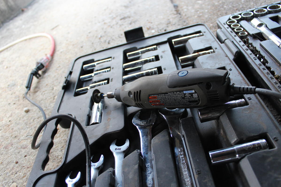

After spending 3 hours trying to get rusty screws out the tank cover. I made a new best friend. DREMEL
THKS 77'911

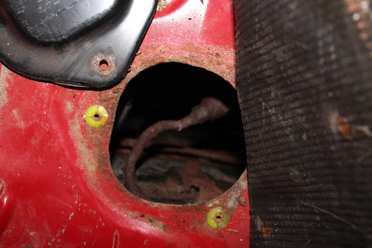

Went top side for the glory hole and found my dam leak. 2 cracks in the rusty fuel line
