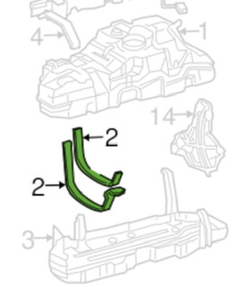

I ordered gas tank straps from RockAuto today and it says it comes as a set. The picture on the rock auto site shows 2 straps. I just went on the Toyota parts site and the parts diagram shows 2 separate pieces for front and back. It appears there is 4 pieces that go for replacement of the straps.
Did I order the wrong/insufficient items??? The part I ordered from rock auto is Spectra Premium (part no.ST316). I hope I’ll be ok. I told the stealership to order the mounting hardware.

Not sure what image you are referring in the SM, but mine clearly shows the two fuel tank straps. What's not clear is the fact that there are two rubber / nylon sleeves (one for each strap) that insulate or protect the metal straps from directly contacting the plastic fuel tank itself.
I've actually removed my fuel tank so I am speaking from first hand experience as well.
Not sure what image you are referring in the SM, but mine clearly shows the two fuel tank straps. What's not clear is the fact that there are two rubber / nylon sleeves (one for each strap) that insulate or protect the metal straps from directly contacting the the plastic fuel tank cover.

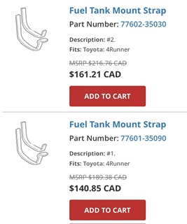

https://i.imgur.com/j1H4rHa.png[/img
[/QUOTE]
From toyotapartscanada site.
[url=https://parts.brantfordtoyota.ca/search?search_str=Gas+tank+strap]Search Results | Brantford Toyota Parts[/url]
I guess it’s the nylon sleeves I’m seeing, hopefully they will come with the straps I ordered from Rock Auto.
