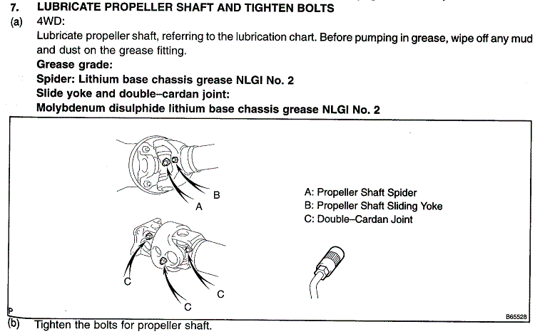

sometimes i feel it might be the drive shaft lube issue, cos sometimes while driving and accelarting/decelating...i still get a slight lag/thump from the transmission.
