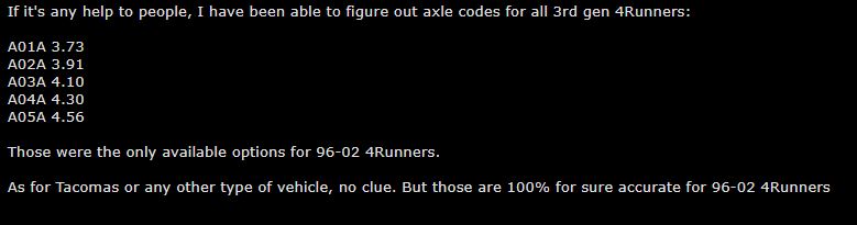

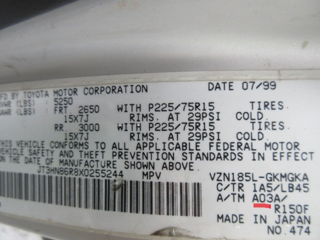

Check your vin sticker, get gear code, and thats the ratio. Heres mine an "03" code shows as 4.10 gears. You can double check with a spin test, and also count the gear teeth. Heres a gear chart I grabbed off the net a while back, not sure where I found it.

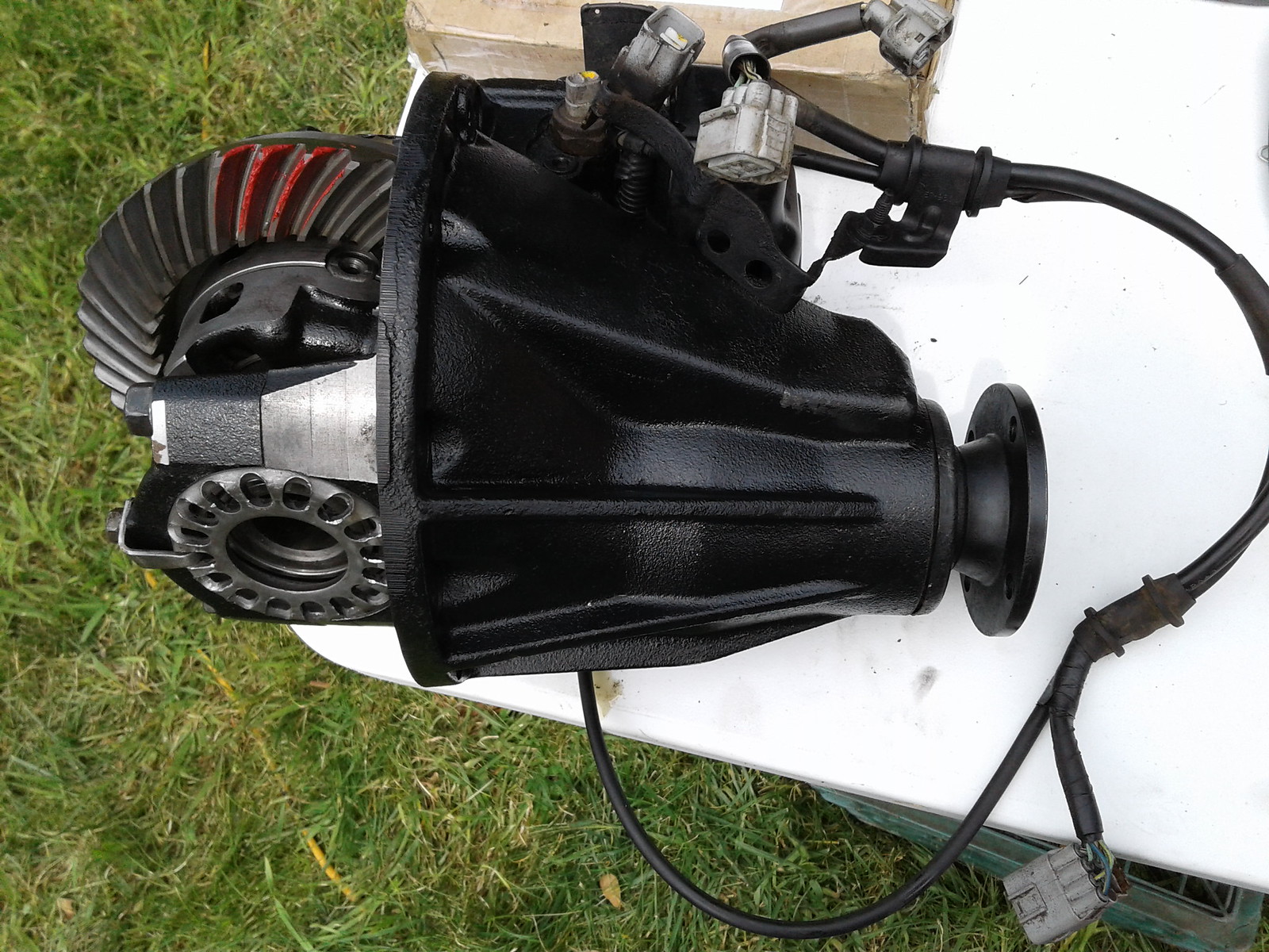

I finally put the front to use after adding Harrop locker, finding a 2k E-locker axle swapped to 4.56 in the 01 that replaced 96Red. Break in miles finished last month, for how I use it 4.56's with dual lockers is sweet.

4 cylinder 5 speed 4x4 elocker got 4.56 (ultra rare) and 4 cylinder automatic 4x4 16" wheels got them too, can't confirm yet but 15" wheels might have got them.
