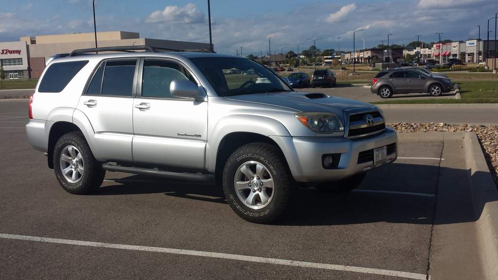

they dont level the front 100% perfect with the rear but they do add about 1" over stock height. i have an 08 sport that had xreas at 140k miles, they werent leaking or anything but they were very tired & the front was sagging quite a bit from stock. the KYB gave a nice lift to the front & have an excellent ride on the street. very happy with them after 2+ years. heres a pic of the stance.

That looks great. I’m not too much of an off-roader, so those would probably be perfect.
