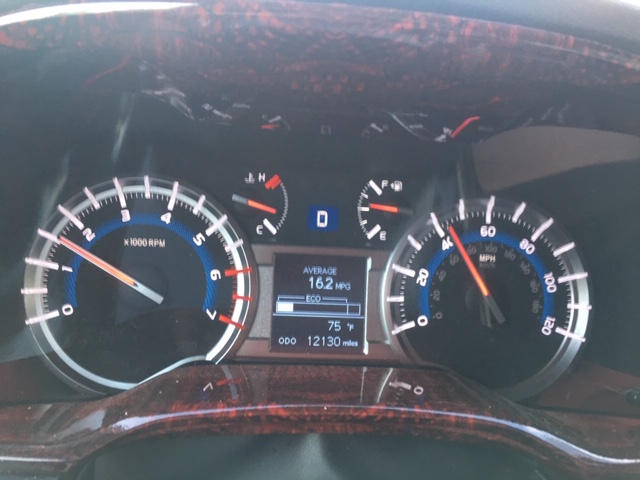

2018 with factory elocker and I went with 4.88's from ECGS, they send you complete built diffs, you swap them out and ship your old diff back to refund the core deposit.
Im on 33's and with the 4.88's I am getting 16MPG which is as good as mines ever gotten since Ive owned it. Mix of in town and highway. Shifts so much better now.
