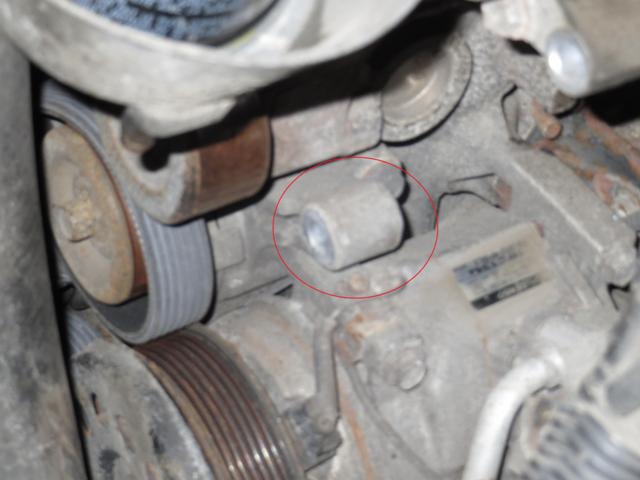

I can answer my own question: The bottom is a through bolt on a pivot. Pics to follow when I put it back together.

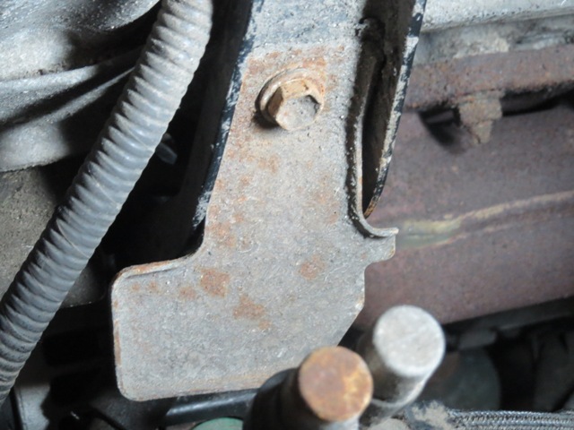

Step 5(a)(1) - This bracket ("stay") is bolted into the side of the battery support.
Step 5(a)(2)&(3) - It is easier to get at the wiring connector and terminal cap & nut if you remove the metal "flap" attached to the upright support above the alternator, as in the pic below.
Pic 1 - remove this bolt & flap

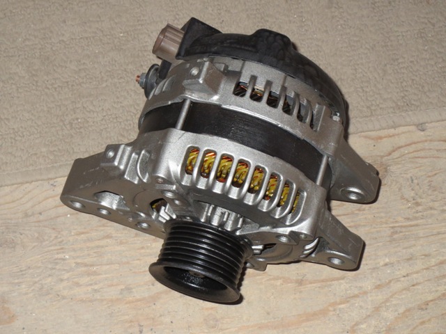

Here are some pics of the rebuilt alternator (1 day turn-around; C$120 +tax) and the lower mounting point (red circle) just above the A/C compressor. The 2 prongs on the bottom of the alt. "hinge" on this point. That is what was giving me the original grief above.

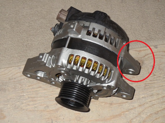

Pic 4 is a close-up of the connections.

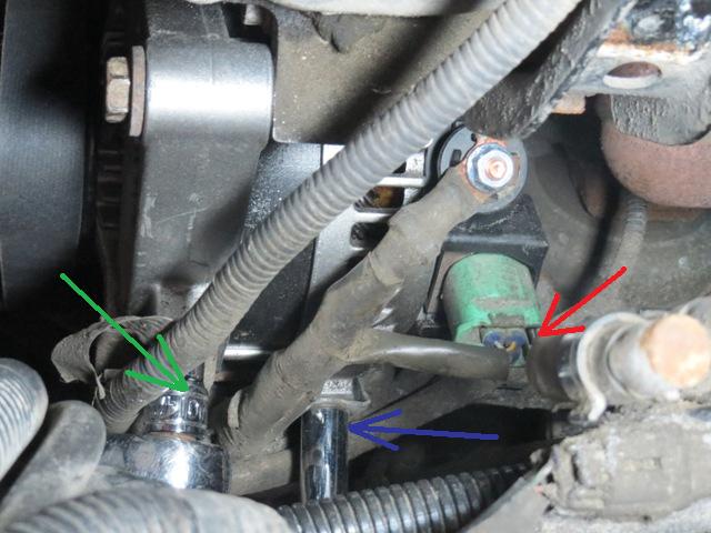

FSM Page 19-26:
Step 5(a)(2) - disconnect the (green plastic) wiring connector by pressing in or depressing the tab on the side that is facing the rear of the truck (red arrow) and then pulling/wiggling the connector up and out.
Step 5(b) - the green and blue arrows point at 10mm sockets on the 2 bolts holding the wire harness clamp bracket. It was easier to get at the rear one (blue arrow) by going through the wheel well with an extension.
Once the alternator is free to remove I found it easier to flip it around, back to front in place, before trying to lift it up past an existing A/C line.

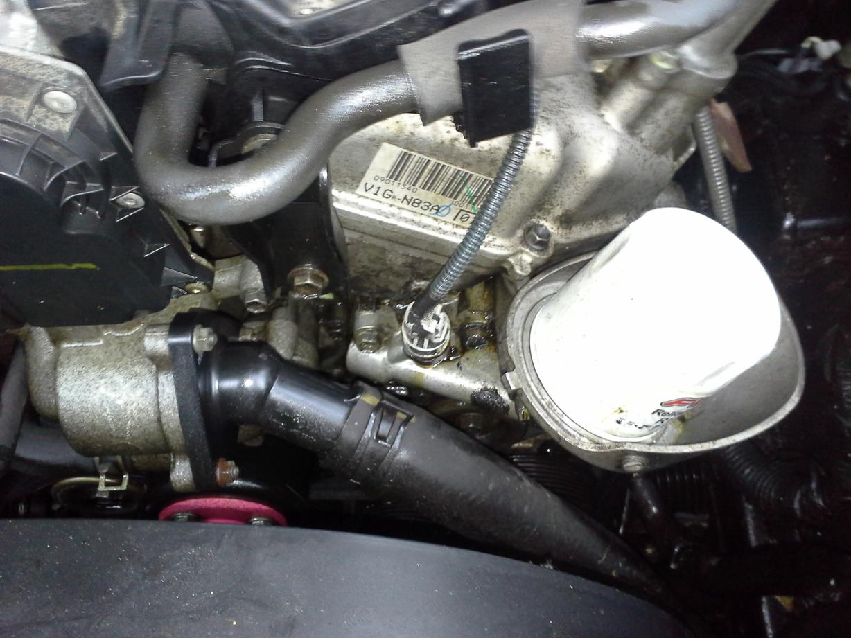

removed :
1) engine cover
2) overflow bottle
3) fan shroud & fan together
4) upper rad hose at thermostat- left bottom connected & wedged at top of rad
5) thermostat housing
6) oil filter housing(pictured above by Sabaka)
7) serpentine belt
8) idler pulley in front of Alt
9) 12v & plug from Alt
10) 2 10mm wire harness bolts on side of Alt (only 1 went back in :-))
I only lost about 1 cup of coolant & 1/2 of eng oil- all gaskets are rubber compression type &didn't need to be replaced.
