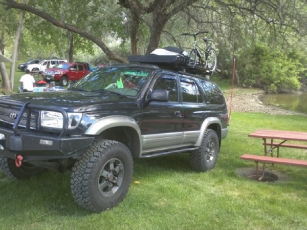

Memorial Day weekend trip to Banks Lake. Bike rack and rooftop bag in action... this rig always fairs well

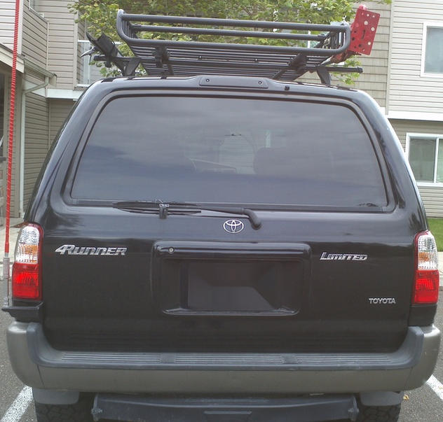

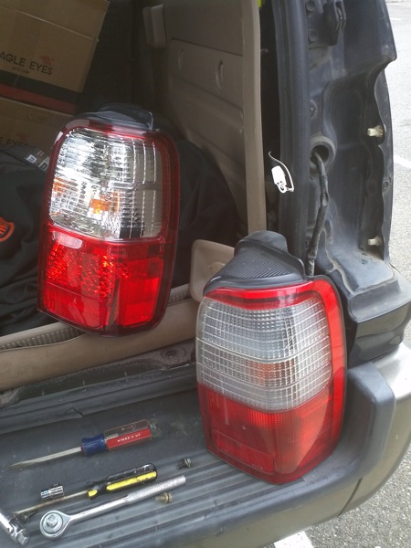

Late 3rd Gen Tails New-in-Box for $75? Yes, please.

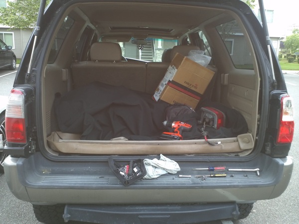

If you haven't changed your tails before, you'll find the harness and the 10mm ground behind your interior panel. Take off the bottom plastic strip at the front of the cargo area. Pop the panels, remove the ground, unsnap the harness. To remove the tail light, remove the two screws, and pop the light toward the outwards side of the truck. Pull the wire, rubber boot, and harness.
The new one goes on in opposite order. Make sure you get the rubber boot on correctly of course. Cake walk!

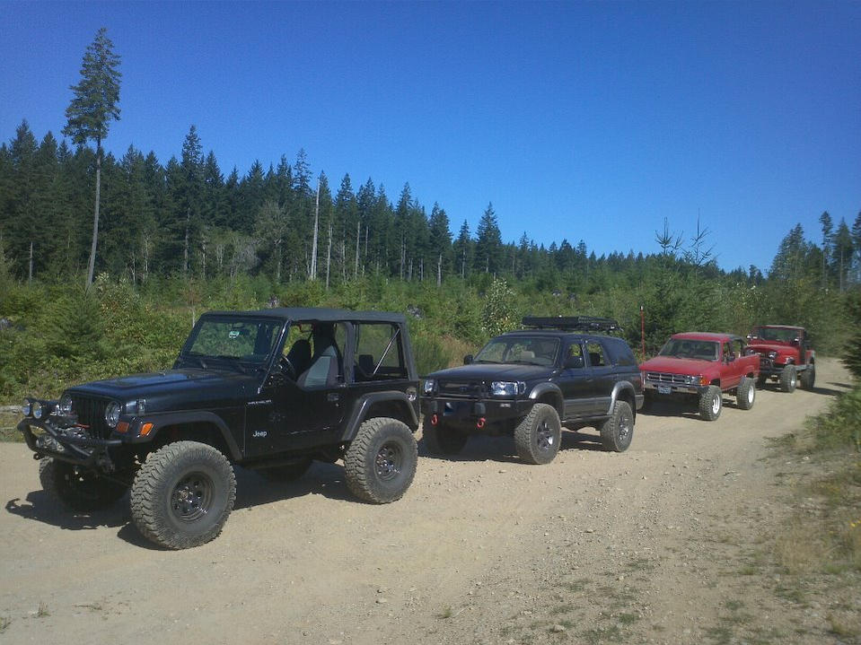

Tahuya Run last weekend with a TJ ('97), a CJ ('86), a -Xxd- 1ST Gen T4R, and my 3rd Gen T4R

Yes, good call. This is the first time he had his hard top off replaced with a soft top. I love the soft top! Sure was dusty though!

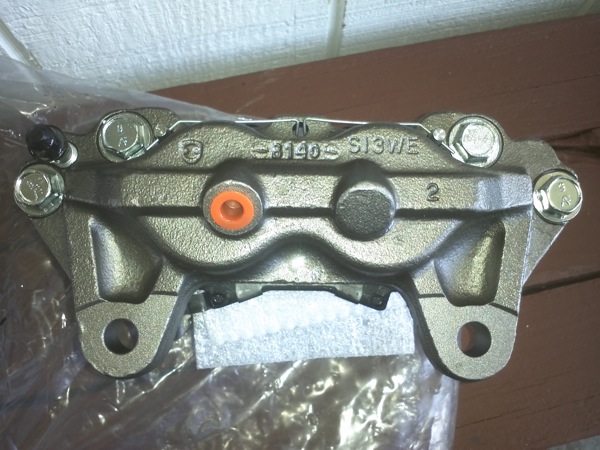

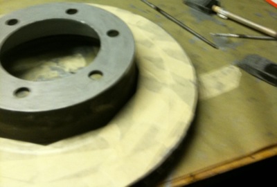

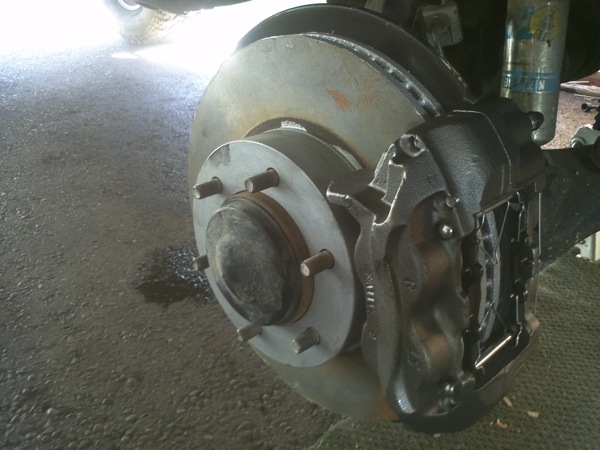

I did a Tundra brake upgrade last weekend. I decided on the 199mm S13WE. I sourced an entire set up at a yard for next to nothing.
I took the near perfect rotors and calipers home and decided to clean them up. I decided that I didn't want to gamble with the calipers so I got a reman set off Amazon for $150 shipped to my door (Raybestos RC11039 and RC11040).

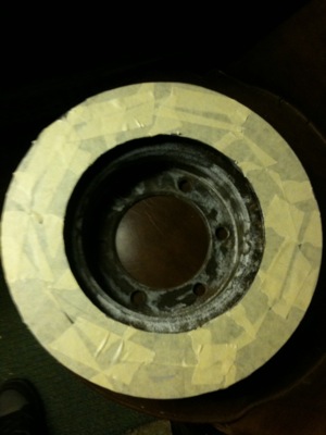

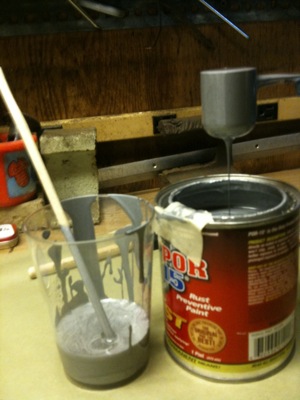

The surfaces of the rotors were great. I restored them with some POR-15
POR15, Inc. - Stop Rust Permanently - Repair Gas & Fuel Tanks
If you've never used it, this stuff is great. From consistency to application, it really couldn't be a better product.
The assembly was a complete bolt-on as you already know. Get the truck on some jack stands and swap-a-roo!

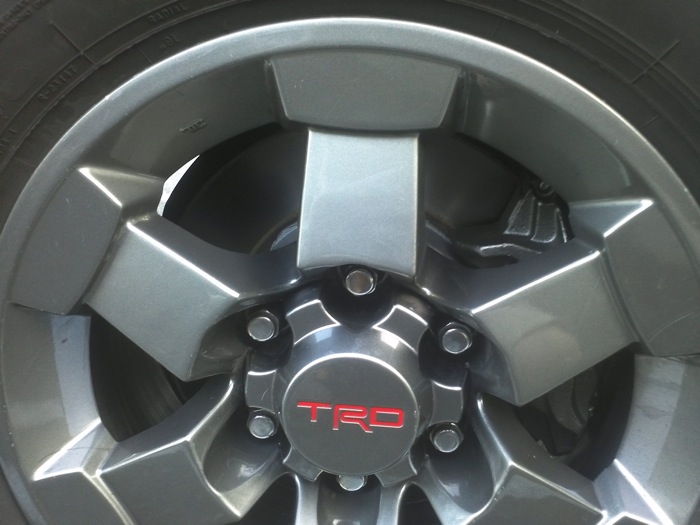

...and Finished!
These completely improved my braking and are a huge improvement with 33's. I've always felt my braking was less than perfect since I put bigger shoes on the rig. Now it feels much more solid!
