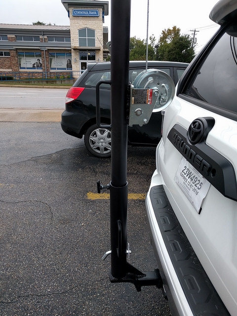

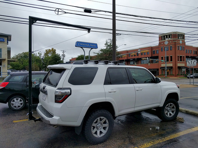

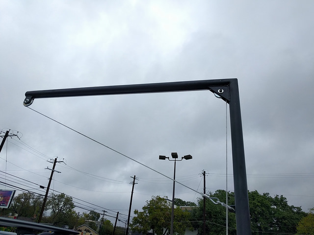

So I picked up the RTT Crane today but will not get to use it for a day or so. It is beefy and heavy. It is basically two parts. I will need to develop a practical way of installing and uninstalling it. The hitch is a little loose, need to find an anti-rattle kit for it.
I will let everyone know how well it works or doesn't.

Not to beat a dead horse, but I successfully used the crane on Saturday to place my RTT. It worked as intended. I didn't have the tent perfectly balanced, but was able to keep it level with a hand on it and it swung around very easily.
The hard part was taking the crane off the truck by myself. I ended up using a drywall step and straddled the bumper and the step to pick the crane up. I will need to try a different technique next time I use it.
I think a folding arm or fabbing from aluminum would be better, although more complicated. The long swing arm just makes it awkward.
