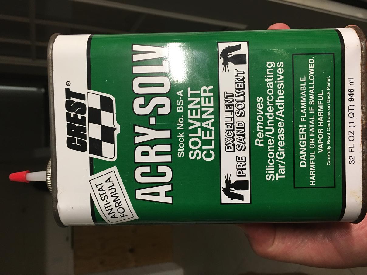

Acry-Solv. This stuff is the best! Use gloves and flush immediately with water once you remove the adhesive. Cleans up very quick and will not hurt your paint. I use it all the time. Also great to get tar off the paint from roadwork. Good luck.
Googled Acry-Solv and Amazon and couldn't find a retailer. Where can I find this stuff?
Thanks,
JDG
I know this is probably a bit late, but it can be found at any auto body supply places near me. Another industry that uses a lot of it is glass/auto glass shops. We used it all the time when I worked in that field. I still buy it from the old shop I worked at because I have him order me an extra case. Great stuff to have around.
3m adhesive remover is formulated for that kind of job. Wd40 works also but will remove wax/protection on the paint.
This is the best stuff you can possibly use to remove adhesive off anything. Won't harm your finish or paint and can be used on plastics as well.
