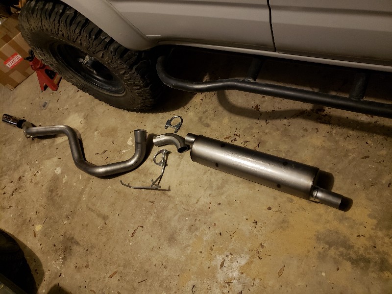

Will hopefully get it installed today!
Got it installed! It ended up being a littlw bit more work than expexted, but it went together.
However, it does sound really nice, at least after a jaunt around the neighborhood. I am going to go out wheeling a bit tomorrow to test the new coils I also installed today, and will try to take a few pics and videos.
I am almost wondering if the PO replaced my exhaust at some point, because my pre-muffler piping was just slightly too large to slide into the muffler as the instructions say. But, it should hopefully be a straight-forward install for anyone else. Be ready to really torque down the clamp between the muffler outlet and elbow!

As to my install difficulty. My OEM muffler inlet pipe was 2.40" OD, and the Gibson inlet was 2.37" ID. So, it just barely didnt fit, and I ended up just welding it. However, I spoke with Jason and he is going to get with Gibson to make sure nobody else sees this challenge. In any case I have never heard of this issue with these exhausts (and Jason said he has sold like 25 or 30 with no issues), which is why I think mine was a fluke. Like I mentioned before, I am wondering if my exhaust had been replaced at some point and the piping was not exactly the same size. But, I trust Jason is still going to dig into it to make sure!

Per JasonB, the OEM exhaust pipe should be 2.25" OD, so I definitely think mine wasnt the original exhaust, then.
