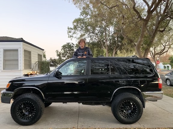

With my son turning 16 this year I've been feverishly looking for a vehicle for him and I narrowed it down to a 3rd Gen about 8 months ago. I looked at more than a dozen before I found a 2000 SR5 2wd (yes 2wd) with 170k miles. It's not perfect but it's pretty clean in and out.
He turned 16 yesterday and my wife and I totally surprised him and he was beside himself. He's a great kid who works really hard and deserves it.
After MANY hours of research I figured out what lift I wanted and which tire/wheel combo to run. I called Wheelers and the outstanding people there really helped me get exactly what I needed. Also a huge thanks to T4R and it's members, what a wealth of knowledge.
Here's what I ended up with:
Bilstein front and rear
OME 881/890
SPC Upper
Pro Comp AT 285/70r17
Pro Comp Rockwell wheels 17x8.5 0 offset
Replaced LBJ with factory parts
New rack bushings
Here are a few before and after pics:

I too am a fan of OEM wheels but with the 285s I need a wheel with more width and offset because it would have rubbed on the upper arm without spacers.

So 285x70x17 tire, and 17x8.5 zero offset rims. Any clearance issues? Would you do things differently next time around?

2wd 3rd gens are still super capable offroad, especially if you air down. How well does the stock 2wd gearing handle those 285s?
