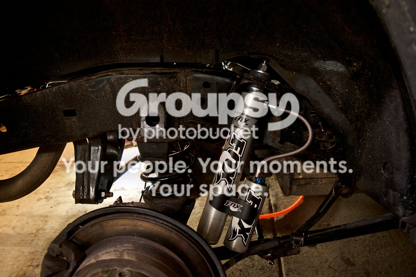

I shopped a lot, and eventually decided since the 4Runner isn't used a lot offroad, and my girlfriend would certainly never benefit from big shocks, we just got some Fox 2.0 with reservoirs for the front and rear. Even though the 4Runner wouldn't be doing anything insane, since I was modding it for her I couldn't just buy normal 2.0 "wimpy" (in my opinion) shocks! It ended up that Wheeler's Offroad didn't have the 2.0 resi coilovers in stock, so I just got the 2.5 non-resi front shocks and the 2.0 resi with compression adjusters for the back. Since we planned to tow a lot, I thought the compression adjusters for just the rear would be helpful. Additionally, since she didn't want a huge lift, I got some Icon springs for the rear off of Amazon. This would theoretically give her a ~2" lift all around, more shock than she would ever need, and the ability to increase rear damping when towing.

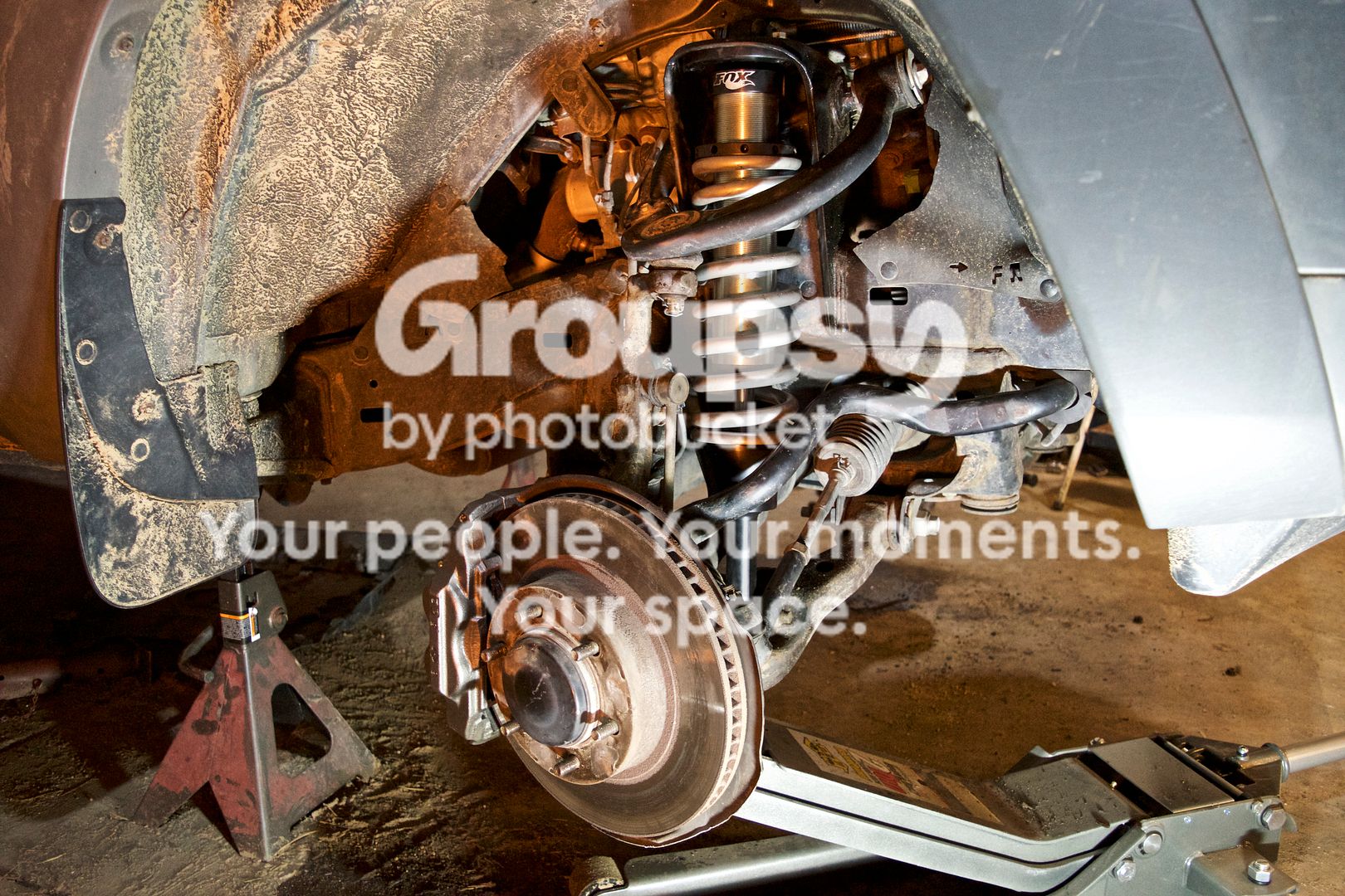

So we drove home, and in a day and a half my dad and I did the front coilovers, upgraded the front calipers, new brake pads, new sway bar bushings, new rear shocks, new rear springs, brake controller, and added a Rocky Mounts roof rack.
DSC_0640_zpsip8ddxky.jpg~original
DSC_0642_zpstpmsk8cz.jpg~original

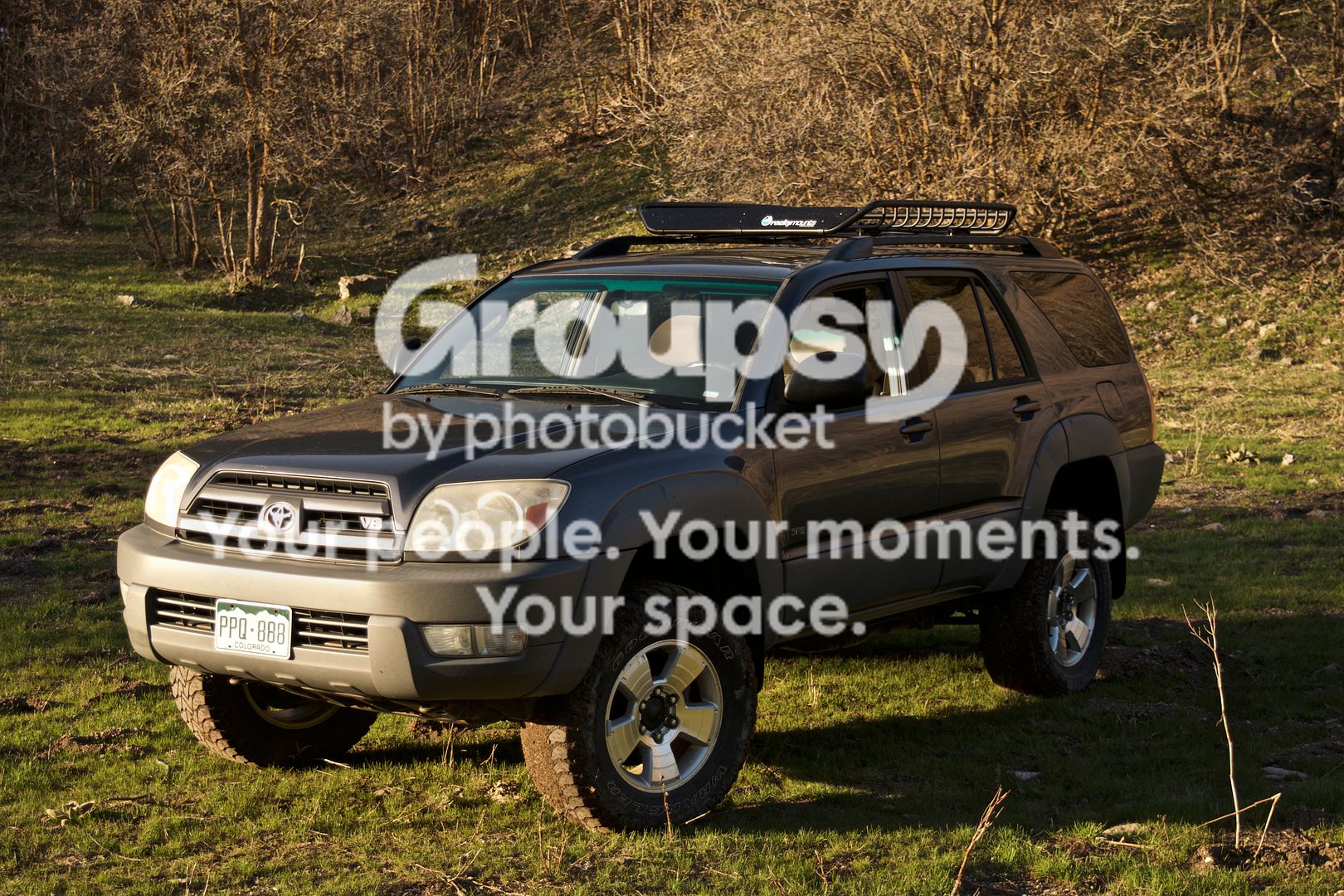

This was the end result:
DSC_0645_zpspru66www.jpg~original
It lifted it higher than I expected, but the old suspension was SUPER sagged out. And ultimately she really likes it, though she says she will bump up the tire size a little, though the lift is the perfect height to not make the tires look super small in my opinion. We loaded the trailer up and headed back to CO.

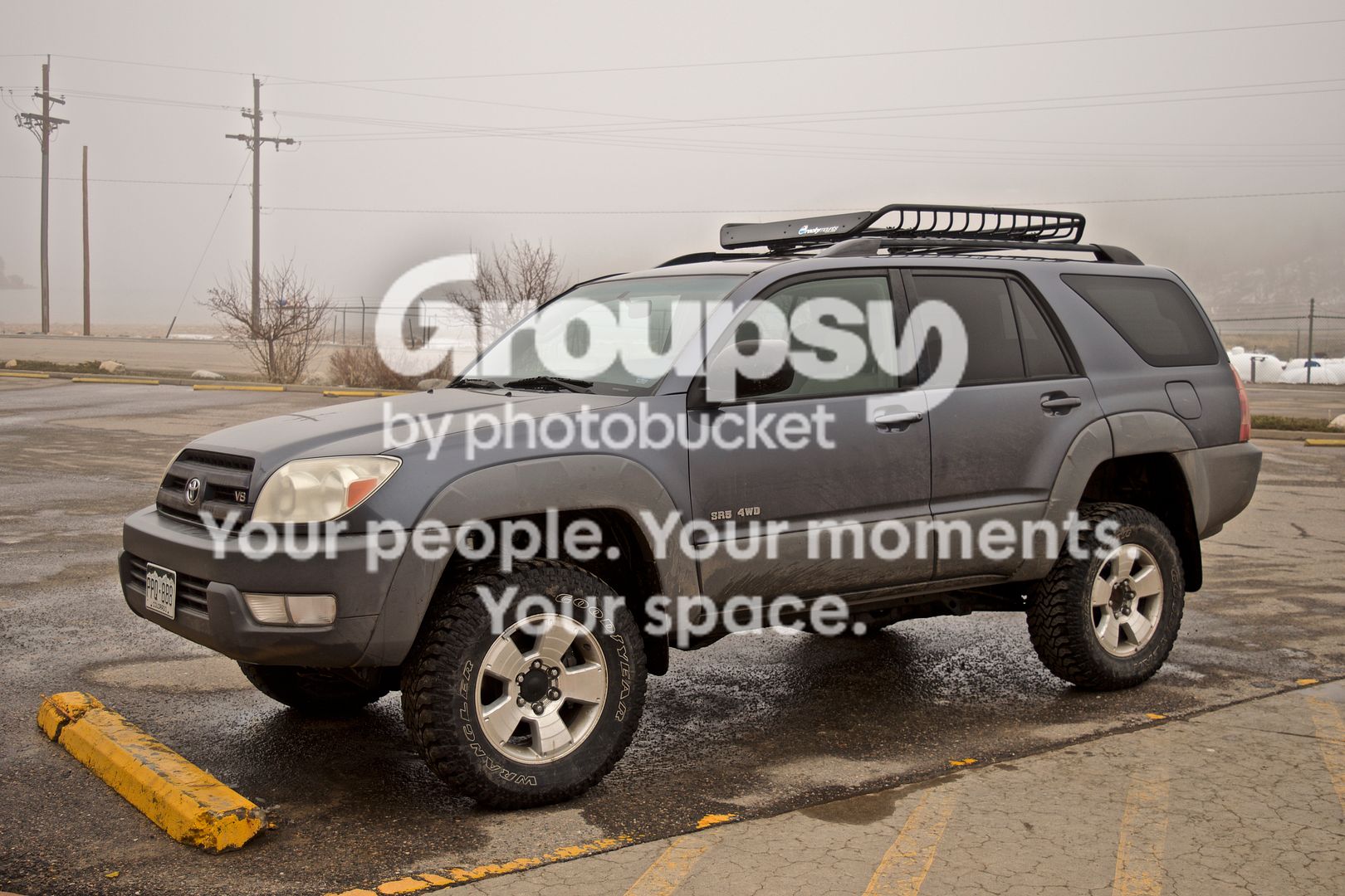

Once we got back to UT, nothing exciting happened since I had finals coming up soon. We went on a little offroading/photo shoot to play with the new suspension and see how it felt.
DSC_0658_zpsetmfq3ti.jpg~original
DSC_0661_zpswpzkor1i.jpg~original
DSC_0674_zpsjuewwe6n.jpg~original

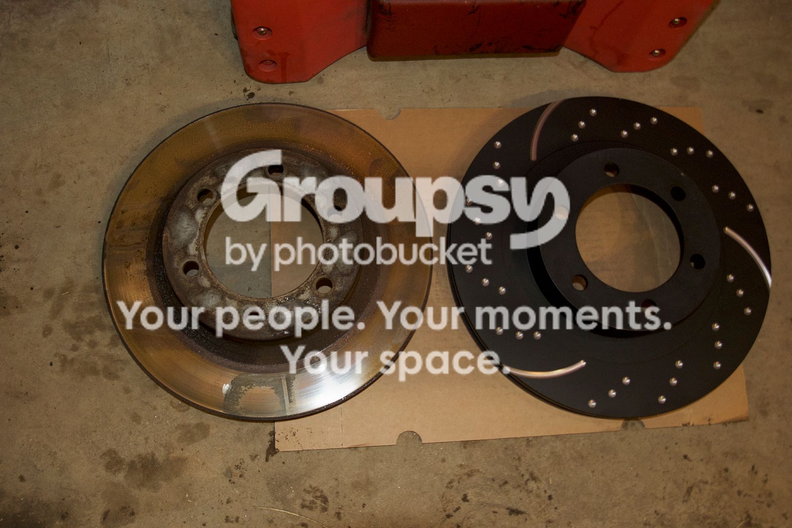

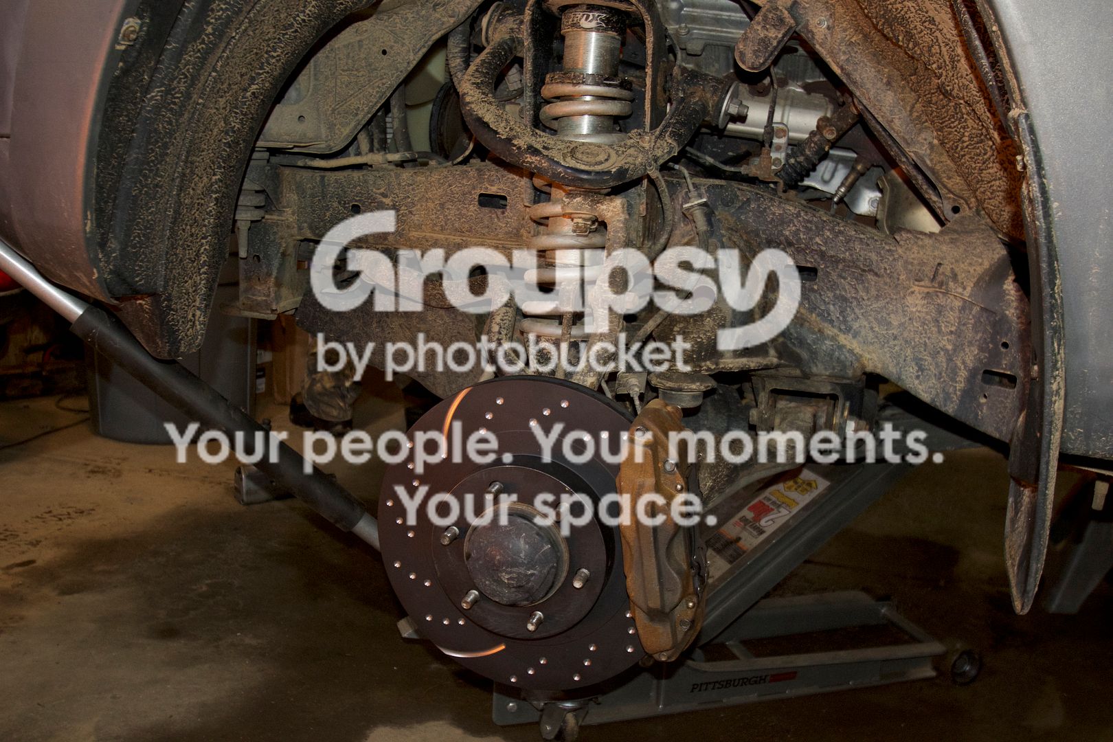

The plan was once we got home for the summer to do new UCAs, wheel bearings in the front (totally shot), CVs in the front (diff side boots ripped since we bought it), and new front rotors (originals were warped slightly when we bought it). So we ordered some Camburg UCAs (with the 1.5" uniball), a pair of wheel bearing assemblies from some dude on this forum, some CVs from RockAuto, and some EBC drilled and slotted rotors. The warped rotors got worse from towing the trailer home it felt like, so although I wanted to do everything at once, we haven't received the wheel bearings or UCAs yet so today we did the rotors.
DSC_0320_zpsjmqd0r2h.jpg~original
Also during the suspension install weekend, I had upgraded the front calipers to the WH calipers which came off the Sport/Limited as well as new brake pads. So when it came to buying the new rotors, we were already set to buy the Sport/Limited size rotors which as you can see are quite a bit bigger in diameter than the original SR5 rotors.
DSC_0322_zpslnnnfys4.jpg~original
