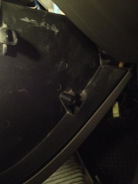

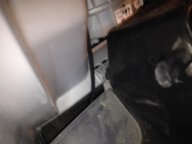

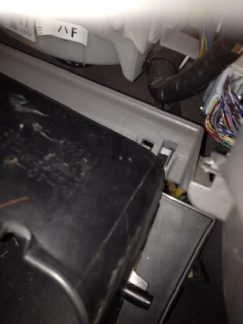

I'm trying to get my glovebox removed. I have got the top loosened, I don't see a screw on the right side as other posts have said there should be but I think I see where the screw was supposed to be (first photo). So now the box is hanging down. The TSB I have for the blower motor says to "lift straight up" to remove. But it ain't comin! I'm afraid to force it and break something. Are the hinges on the left and right bottom of the box shown in the photos open ended so that the box is just a press fit? How do I get this off?

On my 08, from the point where you have it, keep rotating the door down. It'll pop the hinges off. It feels a little uneasy, like you're gonna break it but the hinges are like C-clamps. A little more pressure and they'll release.
On my 04, just had it out last month, give it a good tug should come off! Well you prob have to push down a lil like dawg said

Sparky, do you have a screw on the right hand side or is that just an unused feature from an earlier design? I don't see anything that should attach there.
The screw on the right side is for a little cylindrical damper that lets the g box open slowly/smoothly. It's a little tricky to get it back on if it falls off its top mount. I'm betting someone left it off after an A/C filter change.

he just needs to open the g box almost all the way and tug on it
the bottom nylon tabs will let go
