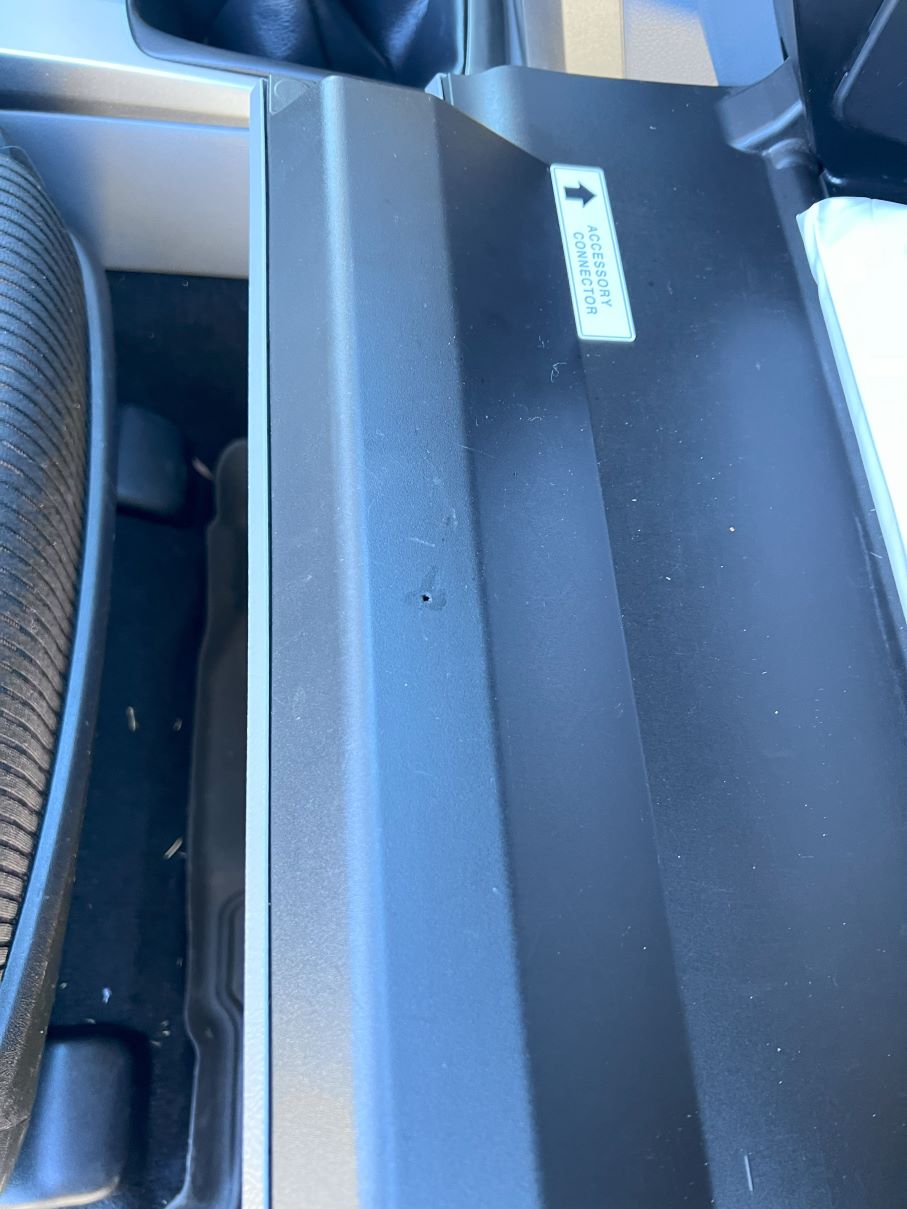

Has anyone worked on their glove box. The two latches are stuck in the :in: position. It wont close. I have to pry them out with a screwdriver. I tried lubricating with silicone wd-40 (dont want oil smell).
Does anyone know how to take it apart and clean the mechanism or change the springs. I have have hardly even opened it in 5 years. BTW, since the extended warranty expired 4 months ago, my glove box failed, the rear coil springs feel super mushy, and I have replaced three door lock actuators. I only have 81k miles!

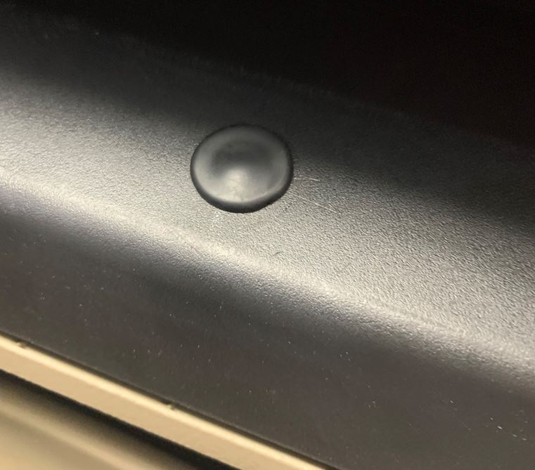

I left my glove box installed and Measured 7 1/2inches in and slowly increased drill sizes, to finish it off I used a rubber firewall plug to cover the hole and prevent any debris from getting in

oh. my. god. Thank you for positing this solution. I cannot believe this is the cause of the problem and how easily fixed it is. Really regretting all the oil I squirted into this damn thing now! LoL

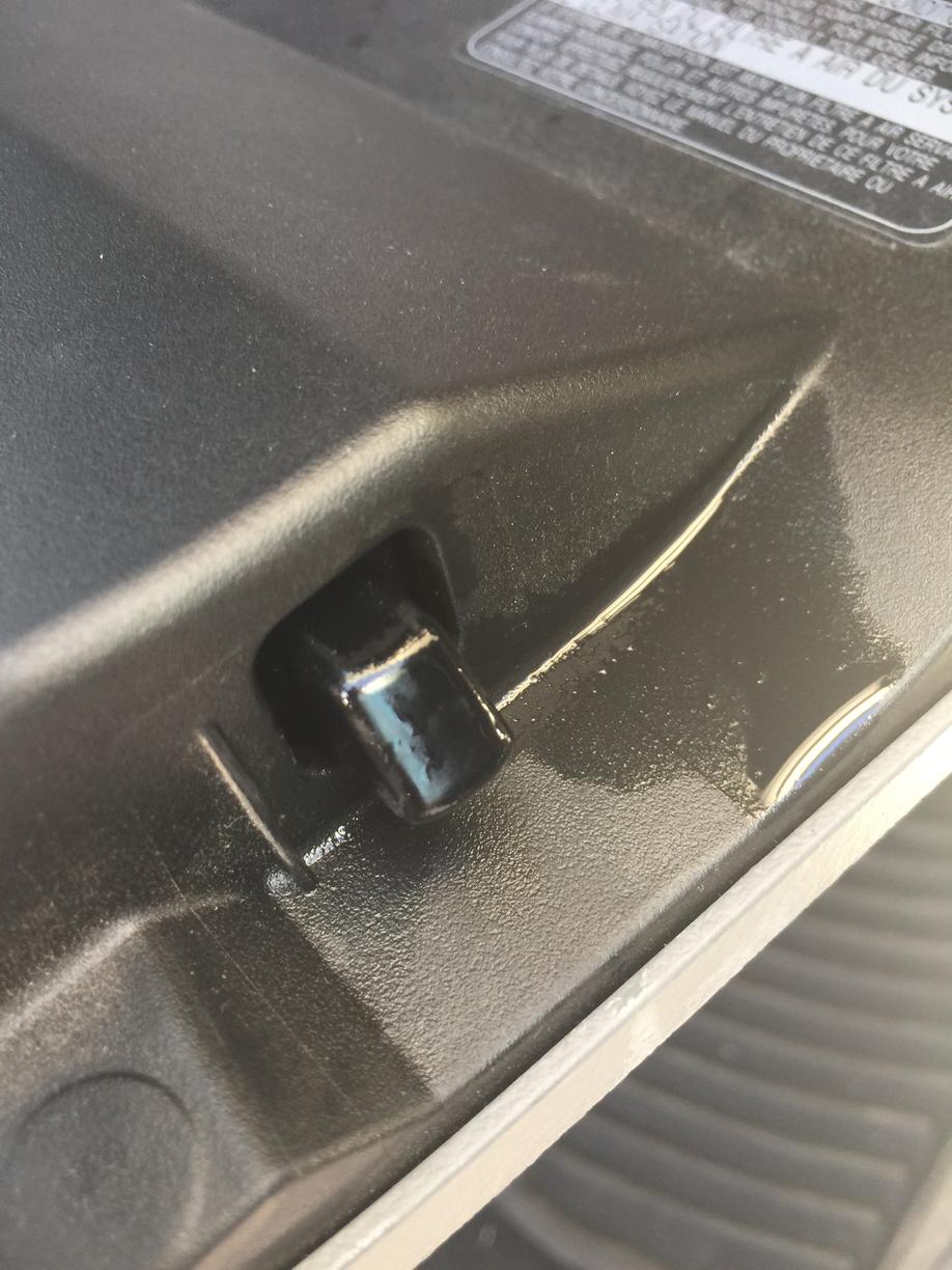

I just did this on a 2010 4Runner, with the glovebox door attached to the vehicle. The glovebox latches have been sticking in every time it gets under about -5c, for a couple years.
The video is great. Just a couple details to fill in for anyone doing this:
I put painters tape near where I estimated the hole would go. Measure 7 5/8 inches from the left side of the glovebox door, looking down at the black inside piece, measured exactly where the left and right spring loaded door tabs come out. This is about 2/16 further to the right from the middle. And just slightly higher than half way from the middle on the raised piece where the mechanism is hiding below.
I used a punch to mark where the first small drill bit would start the hole, to prevent wandering on the plastic. Don't hammer/punch the door off the vehicle.
I worked up to a 3/16 bit to fit in a micro philips screwdriver. You'll probably need to work up to a 1/4 bit if you want to fit a standard philips screwdriver in there.
Pull the stuck locking tabs out, then loosen the screw a couple turns and check if the tabs still get stuck when you push them in. Pull them out and loosen a bit more until they don't get stuck when you push them in. Then slowly retighten the screw until the tabs just barely spring back on their own.
I think loosening this screw too much and losing it in the door would make for a bad afternoon.
Now to cover the hole with some rubber/plastic firewall plug.
