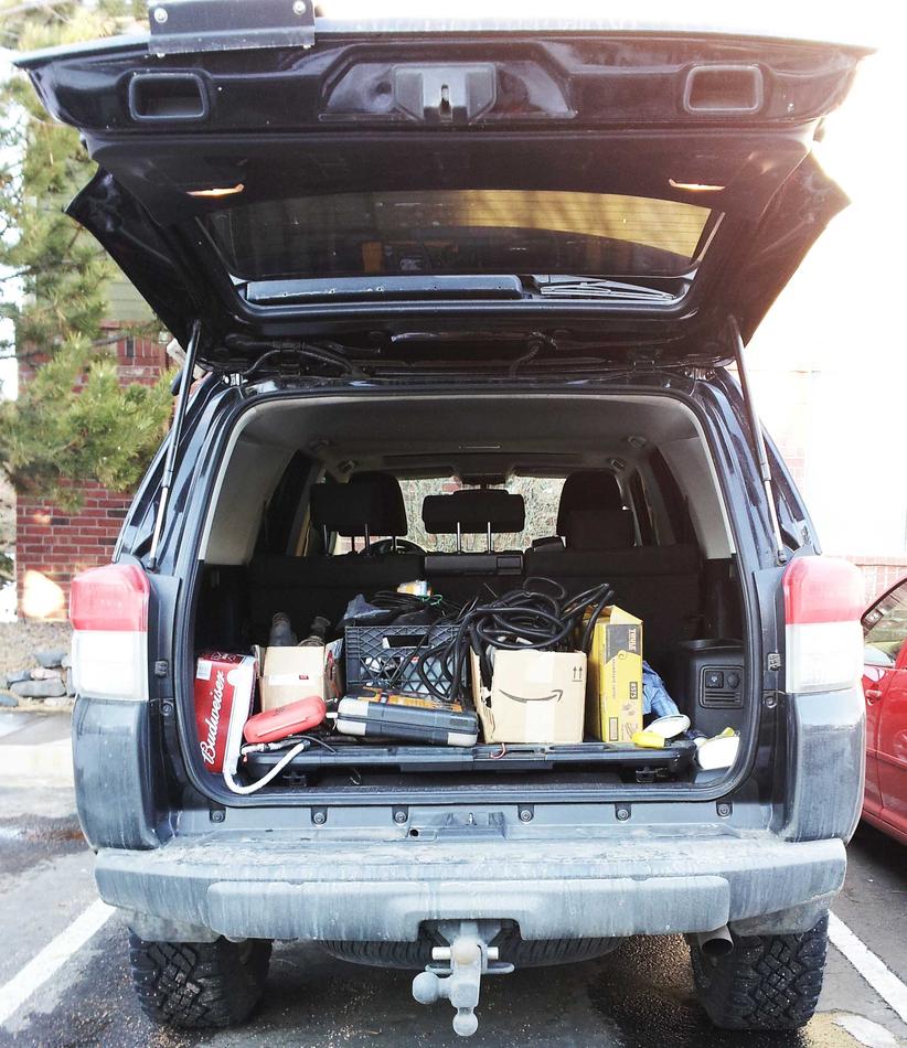

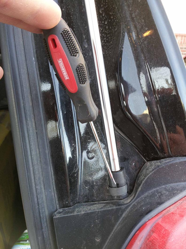

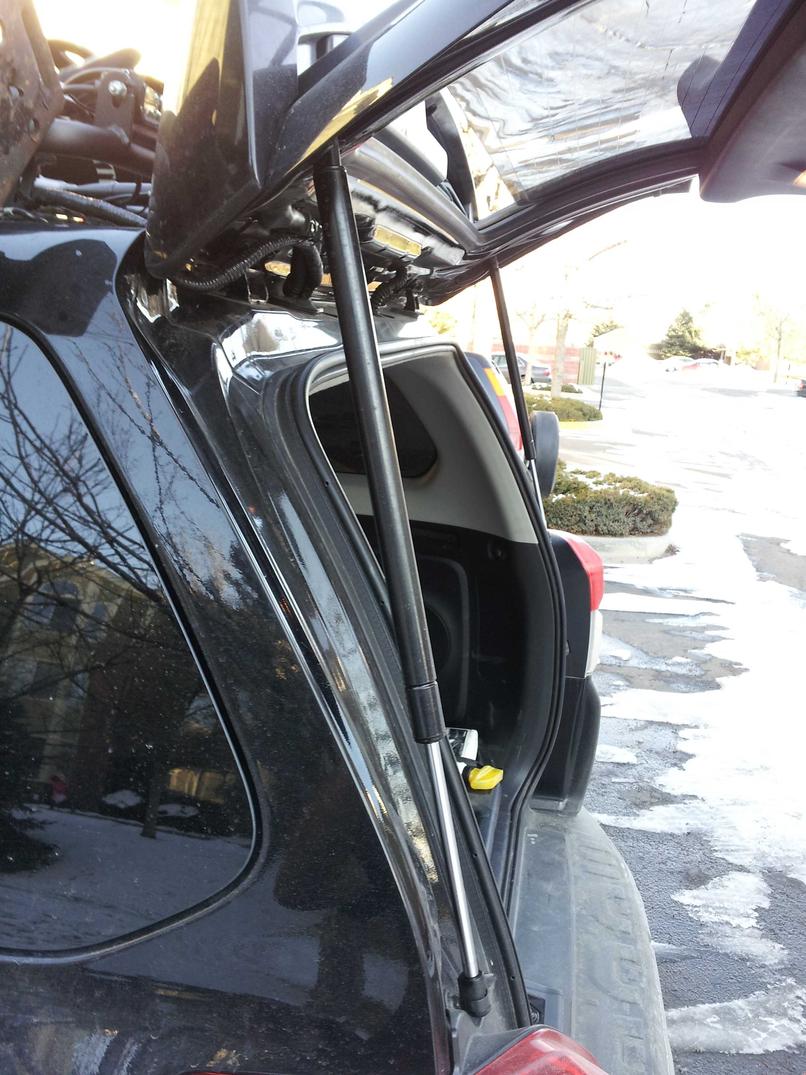

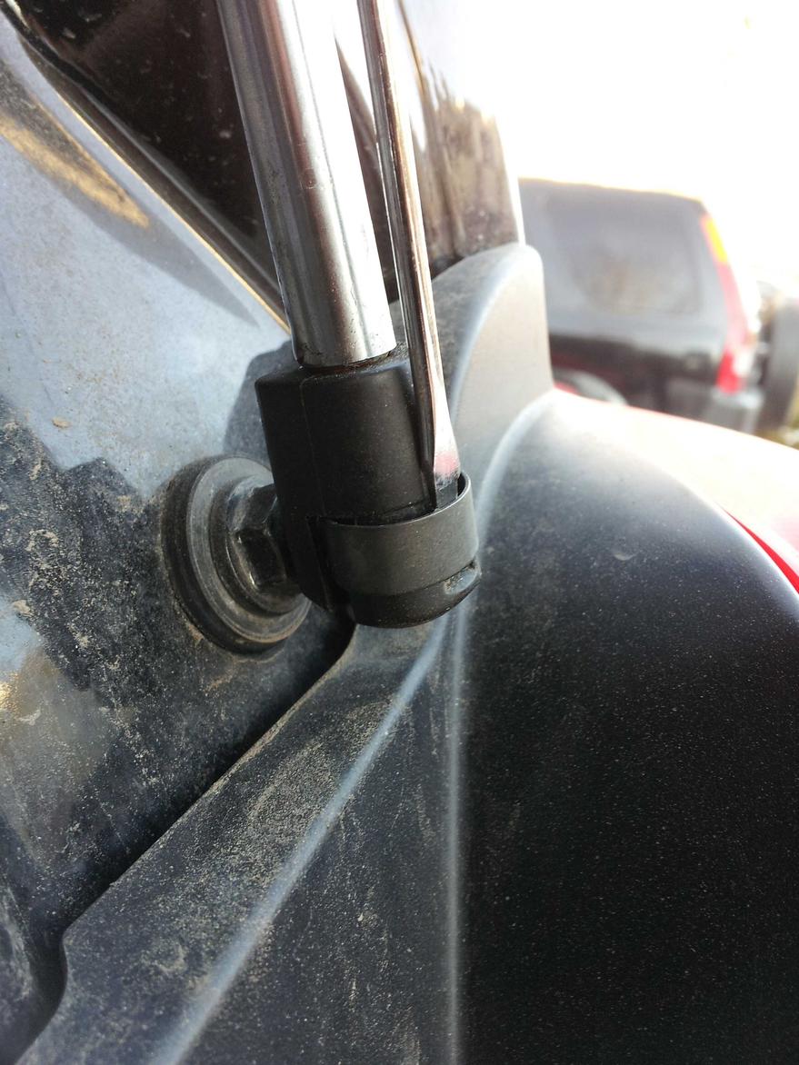

Have someone hold the rear door to the highest comfortable height they can reach. What I experienced was the higher the door was held the easier it was to "pop" the struts out of place. Make sure the person holding the door has a good and comfortable grip and warn them! Then with the small flathead screwdriver place it where image one shows (see image one and two) Then pry in the direction away from the truck, grab the strut towards the bottom and start "feeling" it out, freeing it from the ball-bearing attached to the truck. You might have to give it a good “tug”. NOTE: I would do the bottom ones first, than the top ones. Any Questions, just ask.
To put the new struts in:
Same process, get someone to hold the door open, make sure you have the struts the right way up (see images) and line them up, then pop them in place.

I'm not at my truck to check but does that piece you are prying with the screwdriver come off or just loosen so the strut can be removed?
I'm again loving you :whip2:
Haha!
Good question, no you don't need to remove the little bracket, so to speak. Simply pry it enough to loosen it from the ball-bearing its attached to.

They're pretty stiff, I don't know the exact "weight pressure" of them though. FYI: I pre-installed my circuit box and aux switch's prior to wiring my lights with paul and it still took 10 hours +. Make sure you have the day to take the time.
The Ladder can come off pretty easily. A heat gun and an allan key and 15 minutes and its off. I have had mine off at least 6 times within the year. OCD!
IMO: The news struts have helped to lift the rear hatch beyond mid-way point, and fully open on its own. Before with the stock struts I had to help it most of the way in order for it to open fully.
