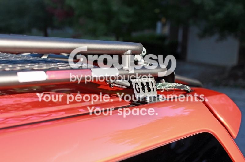

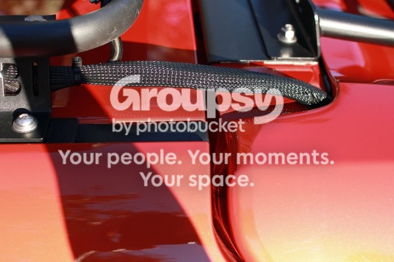

Since Gobi sent me the wrong rack Ive been going back and forth with them regarding fabricating a custom bracket to hold the light bar that will clear the vertical supports. Still waiting for it to come in but in the mean time went ahead and mounted the light bar with some L brackets. Got everything wired with the standard connectors because i wanted to be able to remove the lights and rack if need be. Wires were routed through the factory grommets in the spoiler.

Do you have a pic of where your wire runs to the back of the rack? Where it goes in or if it connects to other lights? Thanks!

Nice pic of the back end, just what I was looking for! And you ran that wire through the hatch gourmet and along the door sills to the switch, and power through the firewall gourmet correct?
