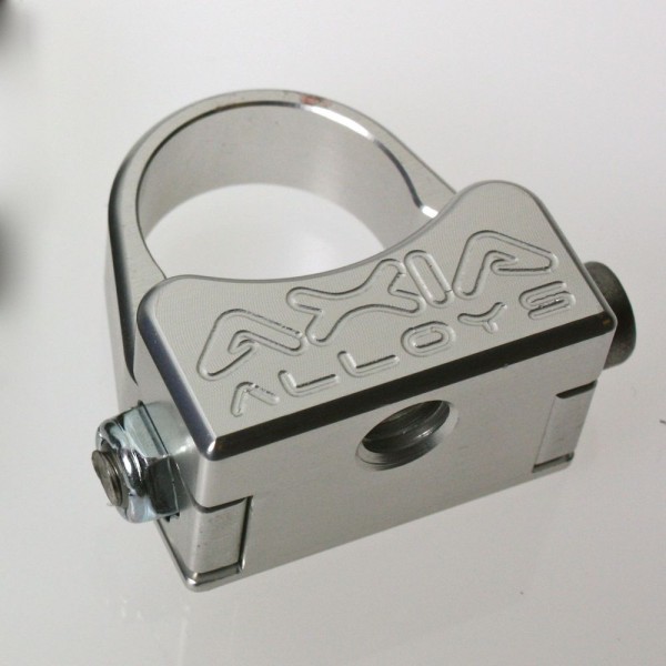

I have also found these mounting attachments. Look solid!
As per GOBI specs the outer rails are 1" tubes and cross bars are 1-1/8" so depending on where you want the RTT to attach to, one could order various size mounting bracket (keep in mind the female size threaded hole into which bolt would go that would attach to your tent, in case of TEPUI it is 3/8")
Universal Mounting Bracket- Single 3/8"-16 Female Thread

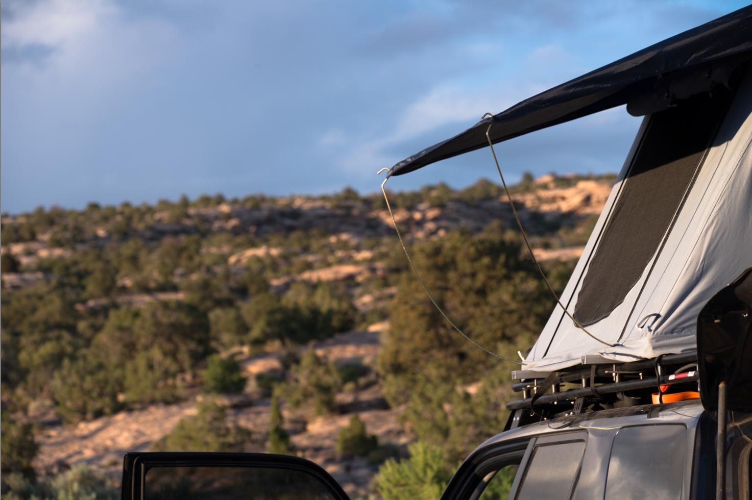

OK. Dug one up from Memorial day, show's the mounting hardware. I left the tent rails long on this side cause I plan on putting an awning up at some point down the road and this makes it easier, per Tepui's experience. They also prove to function nicely as handles when carrying the tent. This is all factory hardware included with the tent. Out of frame are 4x Rotopax mounted to the Gobi rack behind the tent. Hope this clears up some questions.

I ordered those AXIA brackets for 1.0" outer rails so that's what ill mount to. In worst case it doesn't work I also got Yakima wraparound coming that will work on cross bars (only $10 so I didn't care).
