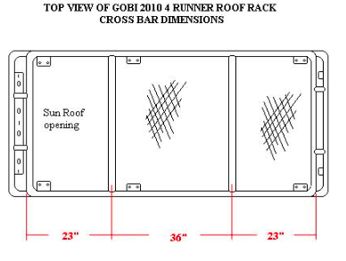

this is the stealth..and this is how you mount it to a clamshell...

So you mounted you RTT on the middle two rungs or the very rear rung (edge of roof rack) and the next one closer to the sunroof?

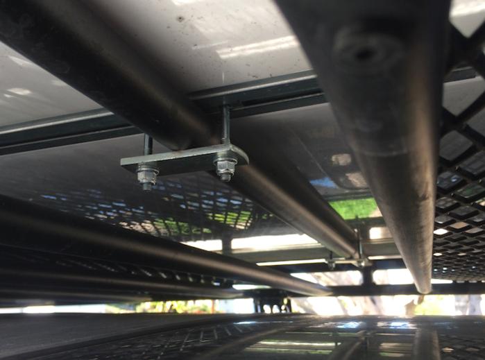

If you haven't ordered the gobi yet, i would recommend having the crossbars deleted and having the mesh floor installed all the way through. I ended up using a set of Thule cross bars that mount to the top of the gobi. This way, when you don't have the rtt on top, you have a full floor for cargo. IMO, having the gobi cross bars limits what you can put on the roof rack.
Here is where you can see the thule cross bars mounted to the gobi.
Here you can see the full floor of the gobi.

they can put the cross bars where you want... but this is the standard setup... works fine with the autohome maggiolina model i have. this tent has buckles up front that i can't open all the way because the rack rises up in the front. it's not problem though with this size tent. the longer ones would not work. you could push it back but that would interfere with the tailgate...
