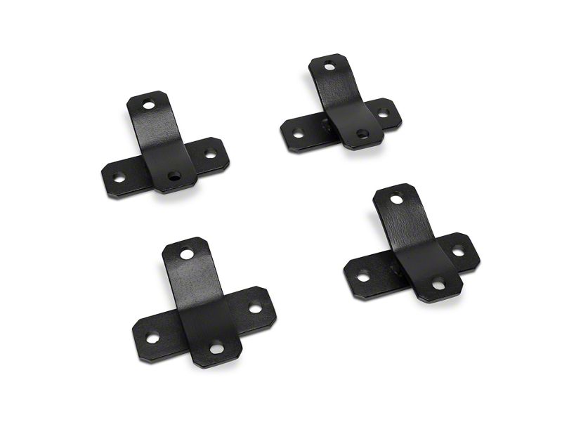

I got two 58" Yakima crossbars and this adapters to raised the crossbars up.
J110540
Took me a while to find the right part but here they have IT.
J110540
i have been looking for an adapter like this for so long! how have they held up to the elements / use / loading? thanks for posting.
anyone know of other similar 90deg round-to-round-bar adapters? (don't particularly like the yakima rail grab tower things)

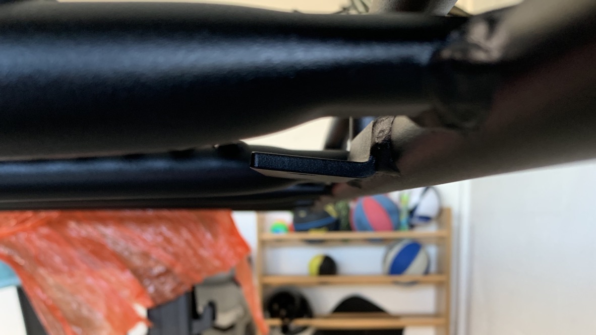

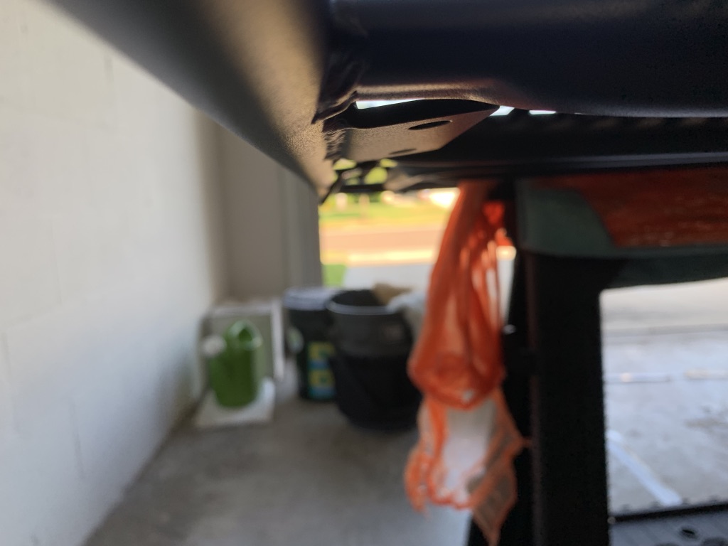

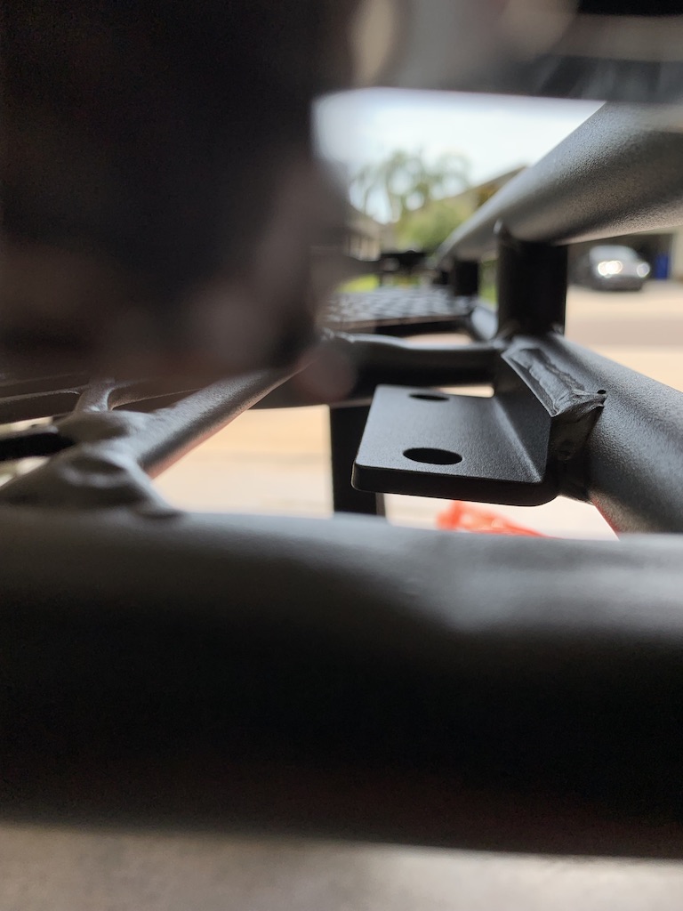

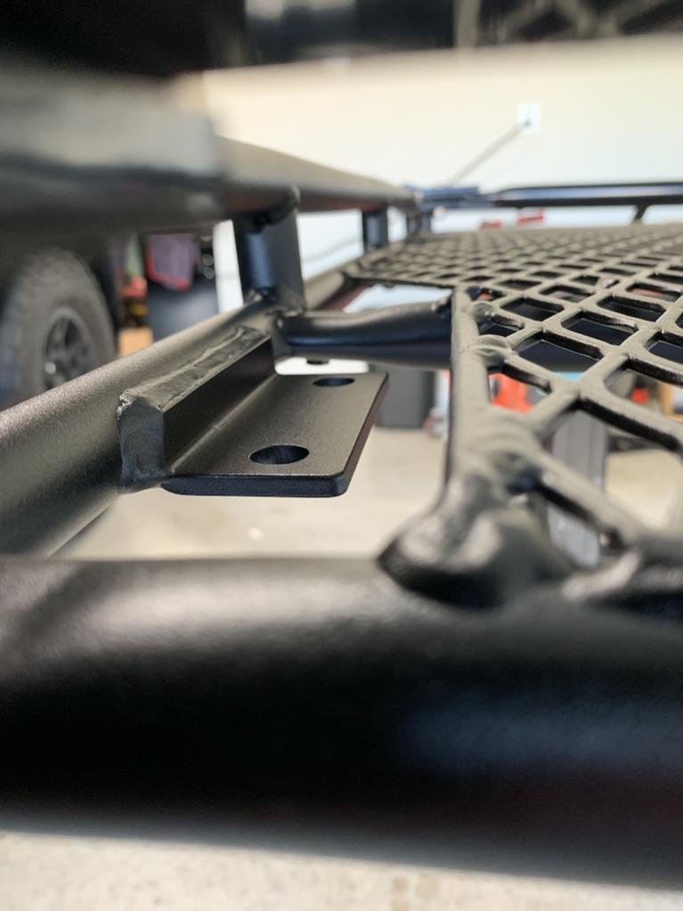

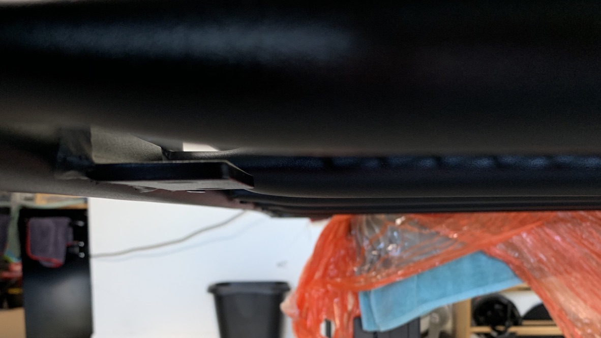

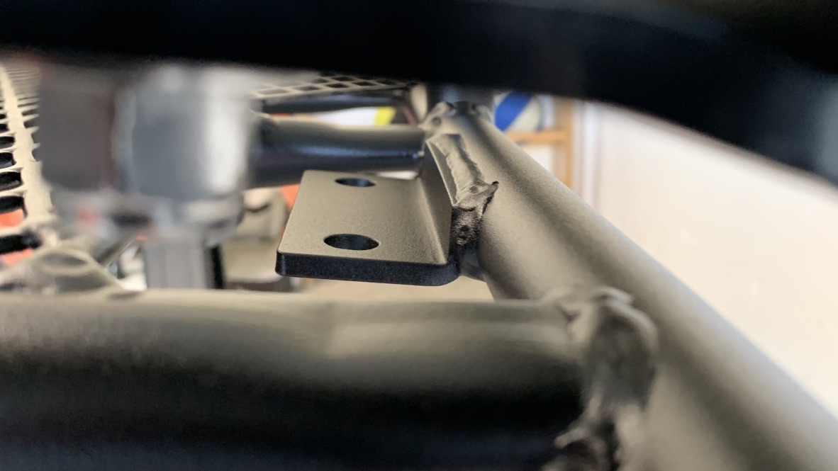

TLDR: Should the driver's side bracket be welded on at an angle?
I appreciate the creation & contributions to this thread. It's been helpful in preparing for my install.
I received my rack a couple weeks back and plan to install tomorrow (6/7). Though I opened the box and did a general inspection the day I received it (making sure it's still in one piece and all required hardware was included), it wasn't until a couple days ago that I completely took all of the packaging off. I put it up on two saw horses so I could begin applying a weatherproof coating.
That's when I noticed the driver's side bracket that has been welded on is at quite an angle, as opposed to the passenger side which appears level / flat with the rack. I don't have a level small enough to seat on the bracket, however just eyeballing it, it's definitely not sitting "flat" like the other side. Hopefully that is depicted in the pictures below.
Correct me if I'm wrong, but this can't be normal can it? Has anyone else noticed this? I'm contimplating calling GOBI however, as many have experienced, their customer service isn't exactly top notch. I give some details of my experience in a different thread.
Anyway, I'd hate to get that far into the install only to realize this isn't going to work. Especially if it will be already be a challenge to getting the rack to lay flat on these brackets, as other members have mentioned in this thread. Also, note the 4 pictures below are all of the angled driver's side bracket. I took a couple pics and then decided to rotate the rack 180° in preparation of the install.

Images of the "level" passenger side bracket for comparison.

hey there! are you saying the adapters you pictured will allow me to attach yakima bars to the gobi rack? if that is the case can you give me a link or a name? I don't want to have to buy the $300 elevation kit from Gobi when I already have several sets of yakima bars and they won't sell the brackets without the bars... thanks in advance
J110540
well I found them on the Garvin site, but I can't see how these will attach yakima bars to the Gobi. Do you have a pic of your yakima bars installed?? that would be a HUGE help! thank you!
had to dig back to figure out what I was even talking about then lol.
I never actually bought them, [MENTION=130622]puckitpuck[/MENTION] was the one who found/purchased so he could answer best.
but from what I'm looking at in his link, the answer to your question is yes:
Garvin Jeep Wrangler Yakima/Thule Crossbar Adapters for Adventure Rack 44087 (07-18 Jeep Wrangler JK)
