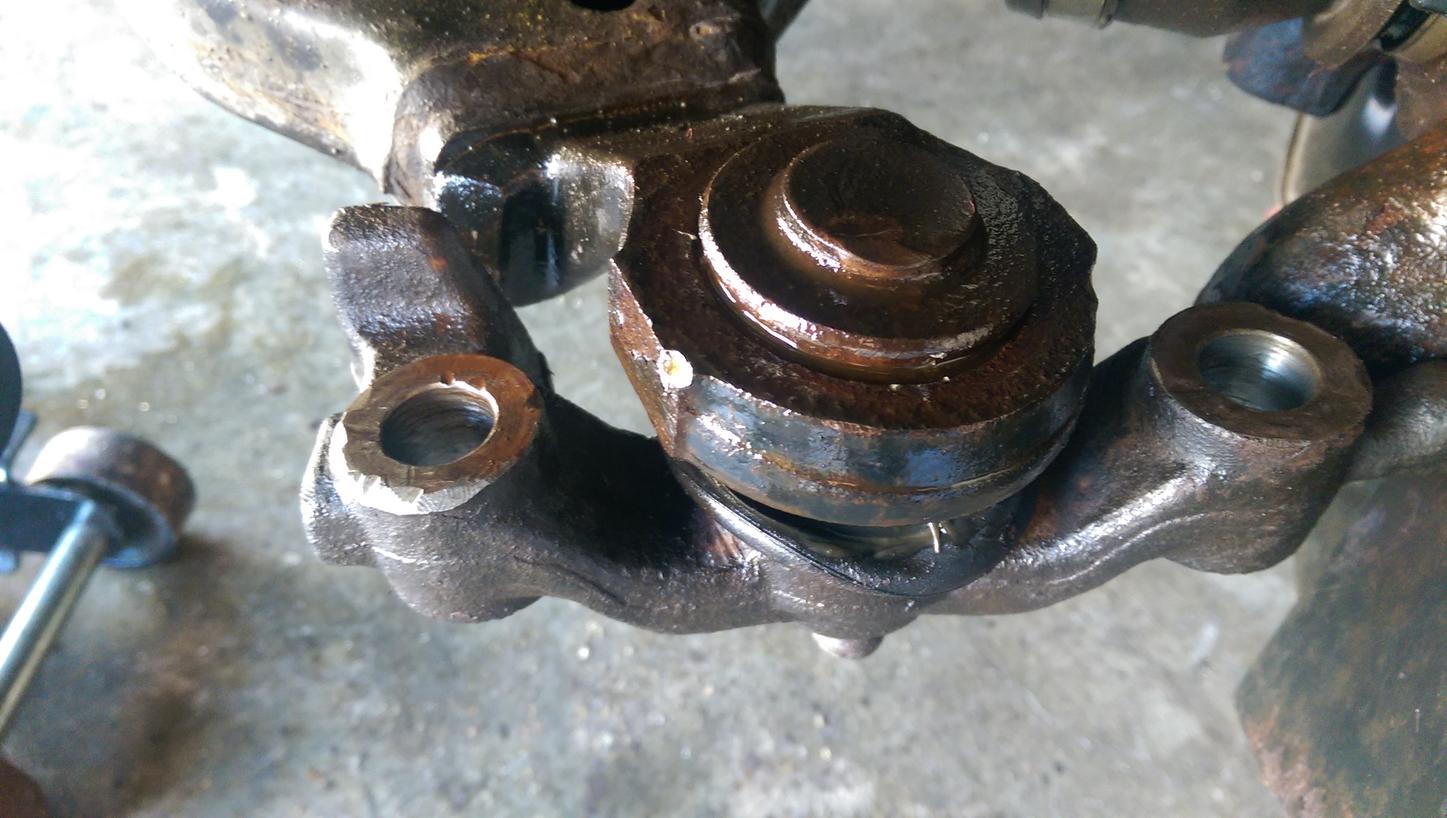

Going after a ball joint today, but can't get this piece of the steering knuckle off off.
Recommendations?

I did both of mine last week. I sprayed them down with PB Blaster and turned that 90 degrees so that steering stop was pointing outward. I supported the lower arm with the floor-jack and a couple of swings with a sledge hammer to the steering stop and that steering knuckle attachment came right off. The big ball joint kit from advanced auto / car quest made easy work of the ball joint.
