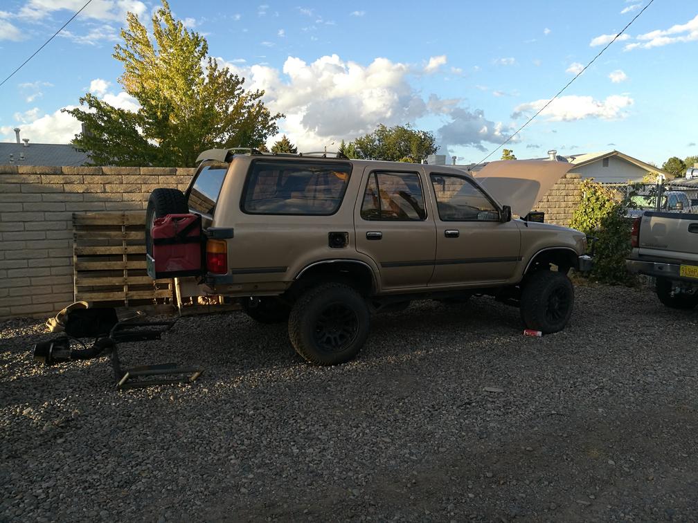

I'm 3400 into it. Would need 3000 to stay out of trouble

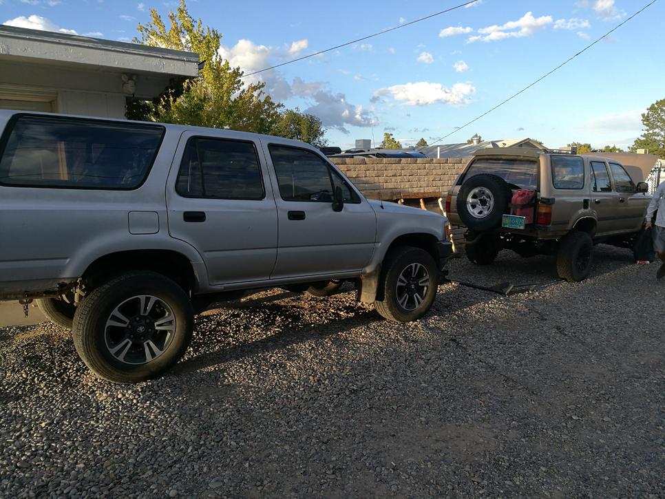

Shes a beauty. I just got gold runner to my house today.The guy i bought it from said the computer was fried and wouldn't turn on and the transmission was seized but i put a battery in it and it turned right on and went into neutral easy. I hope this guy is just and idiot and i put the engine back together and it starts.
