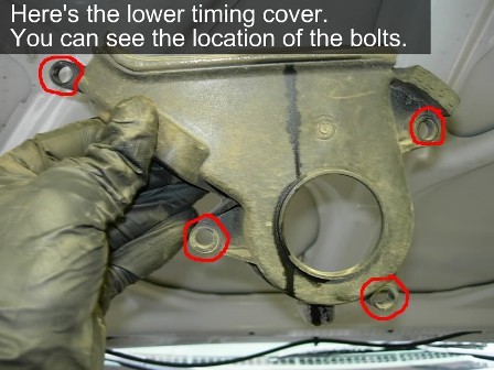

Hey guys for the timing cover is there a gasket that needs to be replaced that goes behind this timing cover?
IIRC, the upper cover is plastic; the lower is metal. On the upper I replaced what was there with some 1/4" foam weatherstrip tape which was quite similar. But leaving as is would have probably been fine. I think I just bolted the lower back up.
The lower is plastic as well. The metal part is the center section with the pulley on it.
