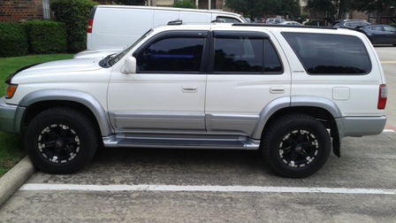

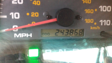

I just bought a used 1999 4runner limited with 243,XXX miles on it. The previous owner didn't know if the belt had ever been changed, so I'm gonna just gather up the parts and get started.
