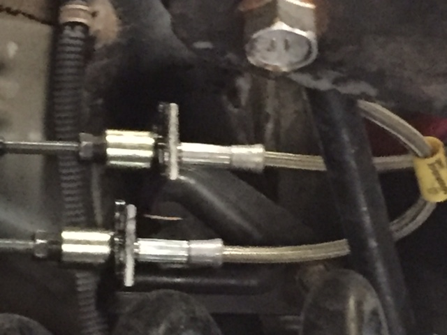

Rear Center Brake Lines - on these lines we ended up using a C Clip and a bracked clip. without the C clip the line would slip through the bracket.

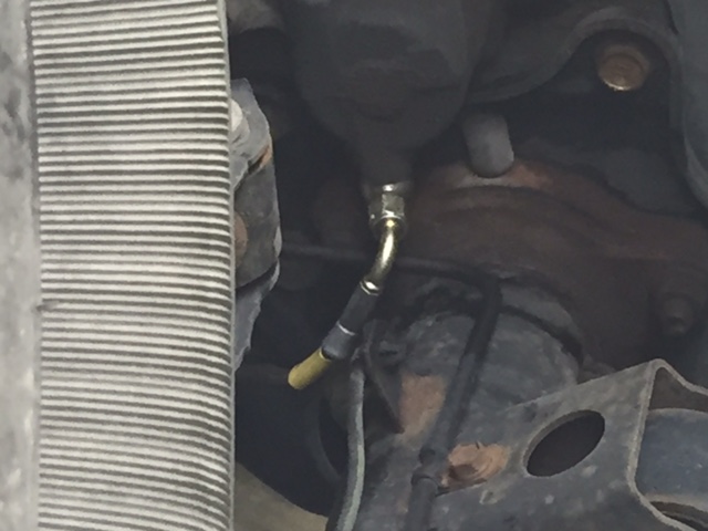

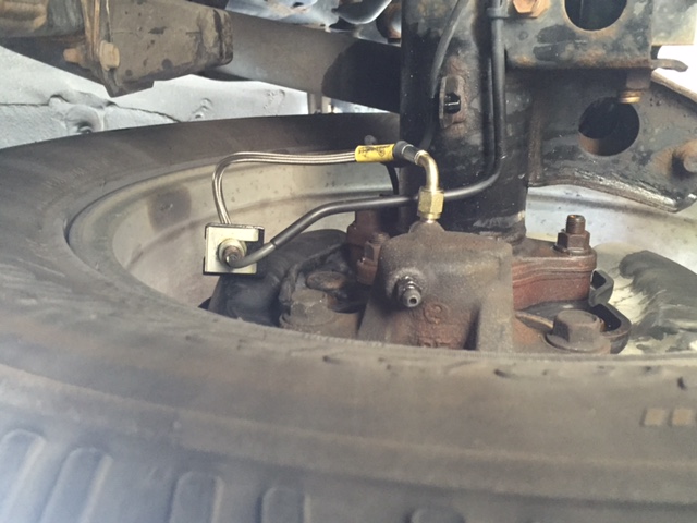

a few potato quality photos ...
the elbow on the rear calipers and the center rear.

I think the kit fits fine, as documented the only difference is the rear lines at the caliper. The Goodridge have an assembly at the elbow that prevents the line from fitting in the notch on the calipers, but no big deal (OEM is all one piece there). You can see the nut at the elbow--that's what wont go in the notch. You don't really see the notch in the picture.
Only difference in my install is I routed the SS line inside the fixed line instead of around it, more like the original path of the line. Just rotate the fitting at the caliper up about 60 degrees. I made sure nothing touches, don't want anything wearing due to rubbing from normal vibrations. If the line doesn't lay (bend) right, rotate the fitting at the bracket with the clip 180 degrees.
