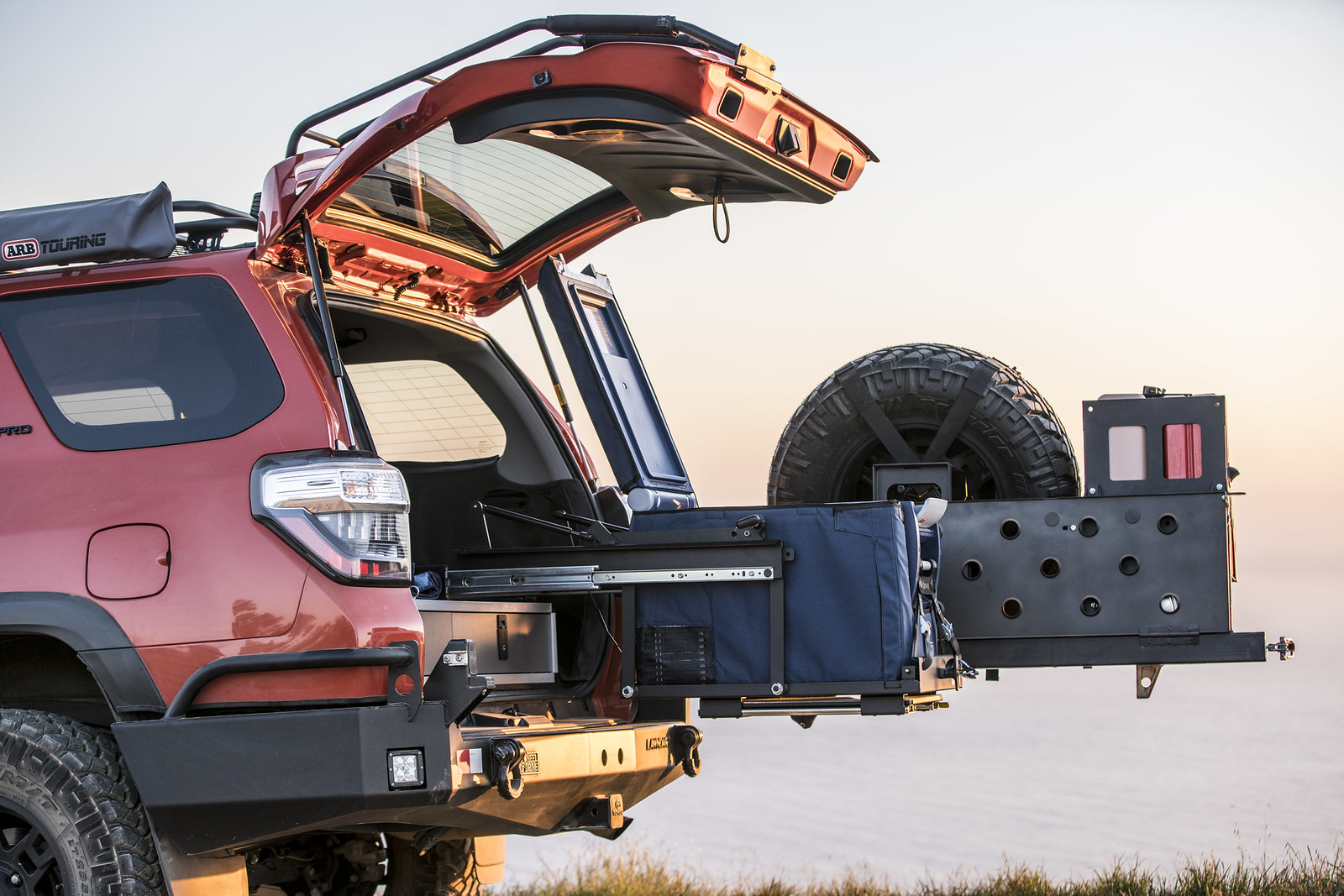

Being mechanically linked into the subfloor removes any doubt about stability. I'll tell you everything was strapped in for Mojave Road (no goose gear at the time) and everything came loose and threatened to smash out windows.
Looks nice. What kind of weight can the drawer system hold? And does it have locks on it? (I think it does but little hard to see) I would love to put a collapsible rifle in it if I got one. But here in CA we needs locks on everything and just tough to follow the rules cause there are so many of them.
Looks like this was answered above, but my crate is 50 pounds and the dog is 87. No problems perceived. The drawers come with locks.
Looks real good. Hope one day we get a group buy on them.
Looks like this was answered above, but my crate is 50 pounds and the dog is 87. No problems perceived. The drawers come with locks. Thanks bud!
I love GG products, they are a solid company. I just wish they weren't so over priced. Looks good!
I priced ARB and others. I also priced doing it myself. GG came out the best and cheapest bang for the buck.
What is the advantage of the plate system vs. just putting it on the floor?
IMAG0123_zpsomlg29oi.jpg~original
The plate system was appealing to me for a couple reasons. First, it is a DIRECT bolt in to the floor and creates a perfectly flat space. The bottom of the plate system has been shored up and engineered in the "voids" to create a flat surface, level with the loading area. Second, the system is fill with mounting attachment points for various modular systems from GG. You can have two or three "setups" and simply bolt them in and out.
Try doing THAT with something like this hanging off the top:
