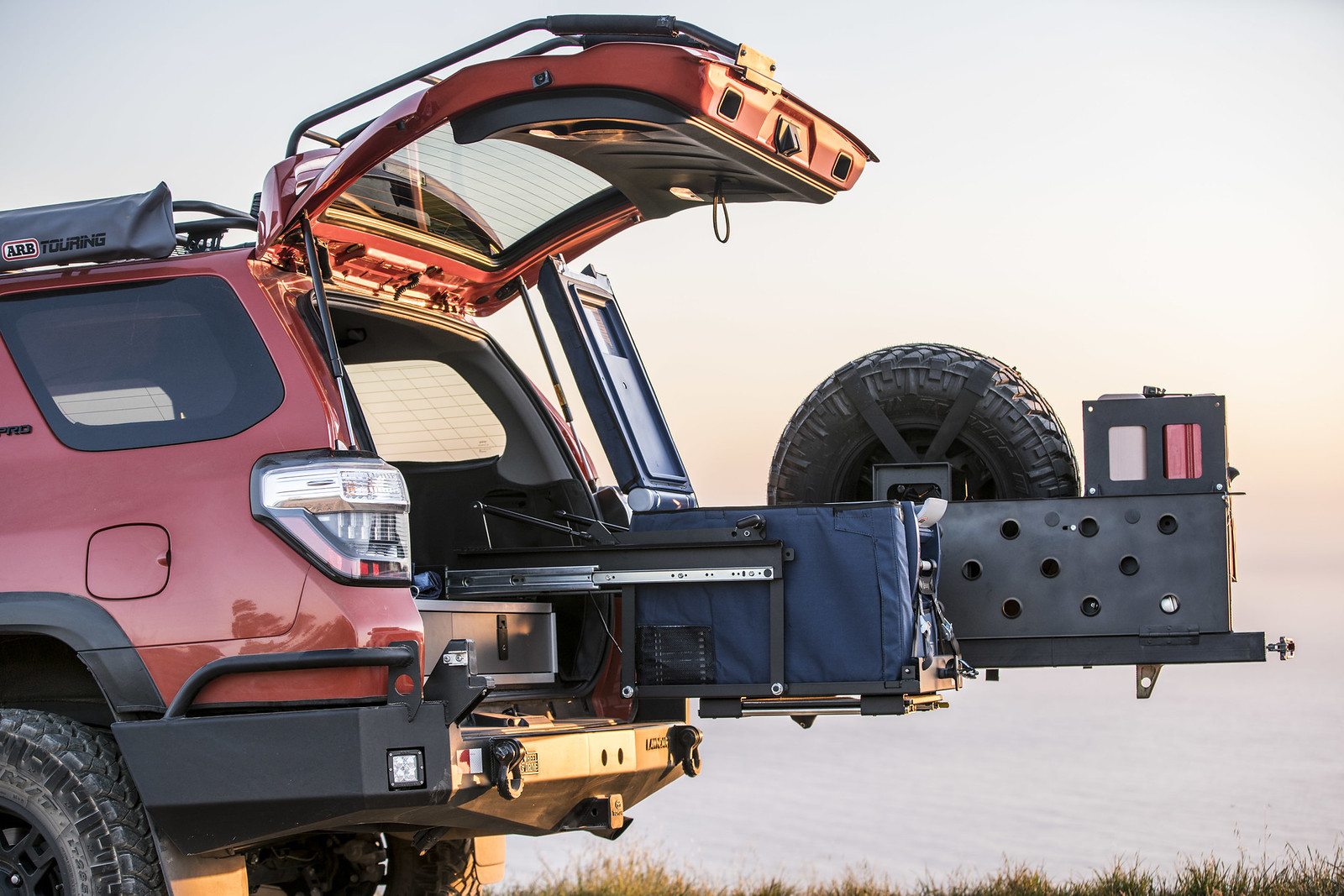

Try doing THAT with something like this hanging off the top:
What fridge slide is that [MENTION=124732]LawnDart[/MENTION]? Is that the Tembo Tusk slide? How does it handle the power cable in the extended/drop configuration? been looking at that slide for my upcoming fridge project.
Okki
Okki
Correct. It's the load spotter. Also heads up jerry/tembo will be discontinuing this slider. It's just incredibly complex to make so if you want one act soon. The cable goes between the triangle created by the gas piston and the slider. It won't cut snagged or pinched. It is an amazing slide. Not cheap. But amazing.
