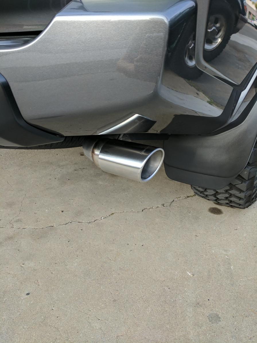

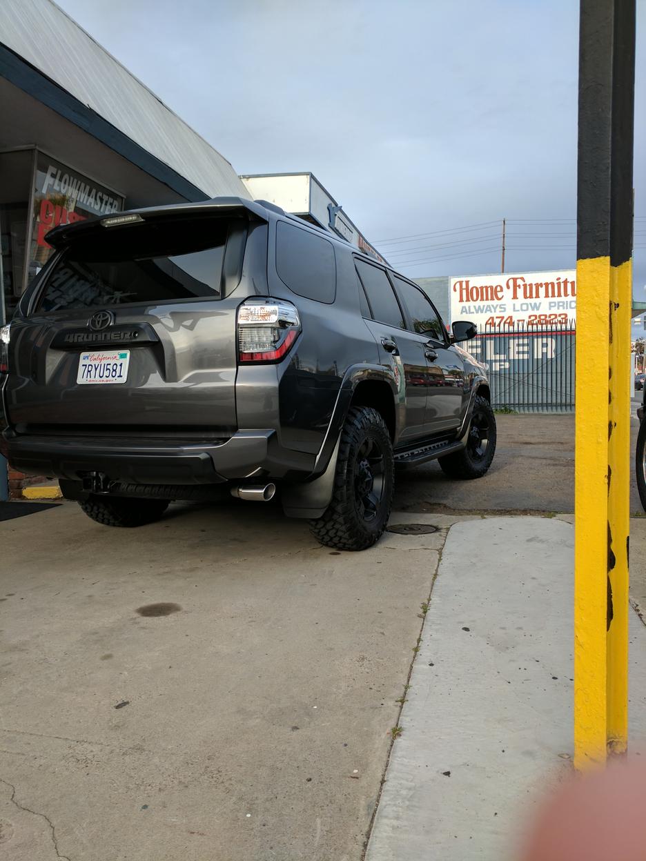

Feels good to finally have this thing in today after a year of owning the truck. I made a video of the sound, will attempt to link it. The sound is great! Very throaty!

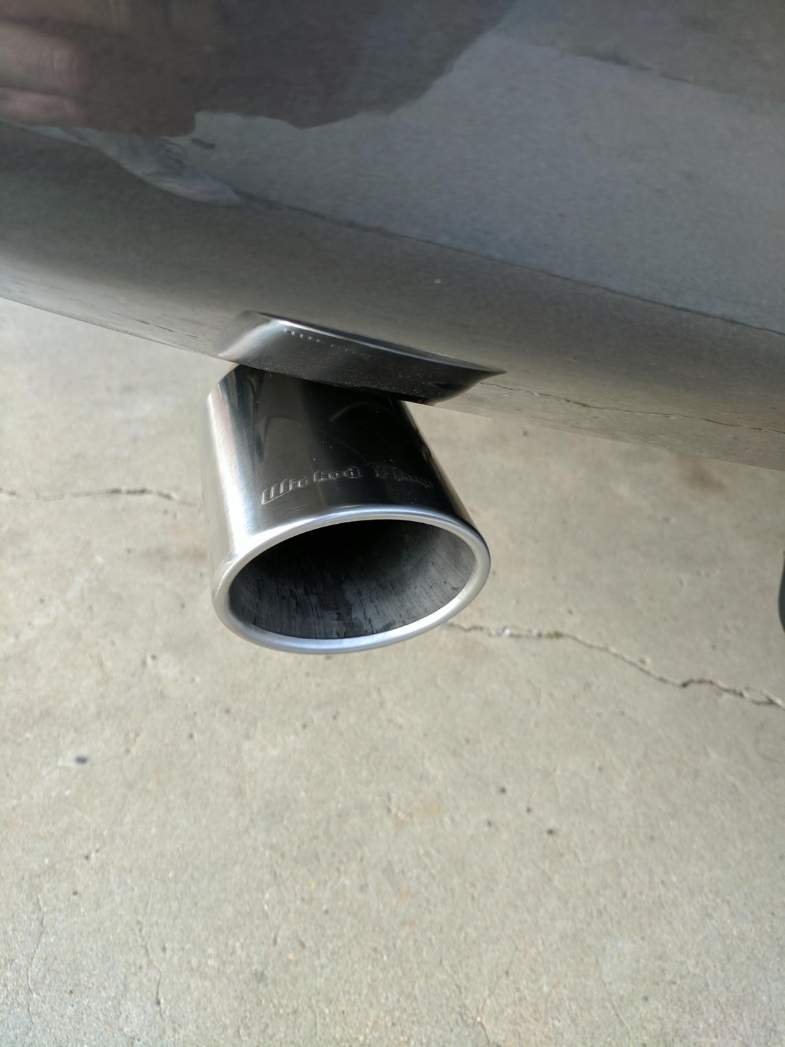

The muffler plus the install was $340 and the weld on tip was $60.

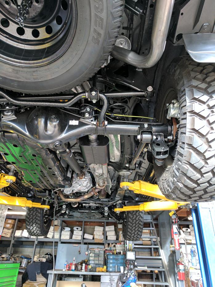

Negative. The stock piping is 2.25 inch and I moved up to a 2.5 inch pipe in the hopes that l would get better sound and I would get better airflow in turn giving me more horsepower and an increase in gas mileage.
From what I noticed you cannot go any bigger than a 2.5 inch pipe because of the way it's routed up above the spare tire. In my first picture you can see how it goes up and above the tire. It becomes a very tight fit. The 2.5 is perfect.
