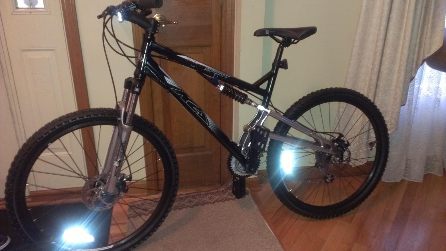

Got me a new set of wheels anyone have any idea how to make a mount to put it inside the car with the front wheel off

for almost no money you could use an old front hub with a quick release and fab yourself a mount that is secured to the floor. Bike would go in backwards (so front forks were facing the back).
I've seen pics of this very thing on this forum somewhere.
i have a temporary bike mount in mine. i dont have a final plan yet but i have just a scrap 2x4 with a fork mount attached. then i have a set of straps going from the handle bars to the rear cargo hooks and then one going from the front hooks to the center of the bike nount. i put a towel against the back of the seat and push the bike as par forward as possible. fits quite well but im working on trying to fit two bike on a mount. i can post some pictures tomorrow if you want
You can buy fork mounts for around $20 at bike shops that you can mount to anything. I have one mounted on a 2x4 that I keep in the back. I then use one bungee cord to keep it from sliding.
