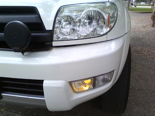

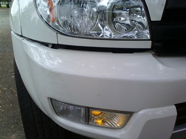

Well here are a few pics. I now need to figure out how and where to fix this gap in the bumper. The pass. side seems to have more than the driver side does for some reason. Also I now have a rake again of 39R &37F, not sure why and does not make any sense to me. Maybe I am missing something.

Maybe this will help, I know the gap and moving the bumper was discussed. I see you've posted there, but maybe give you an avenue for more info. Looks good, although that rake is odd.

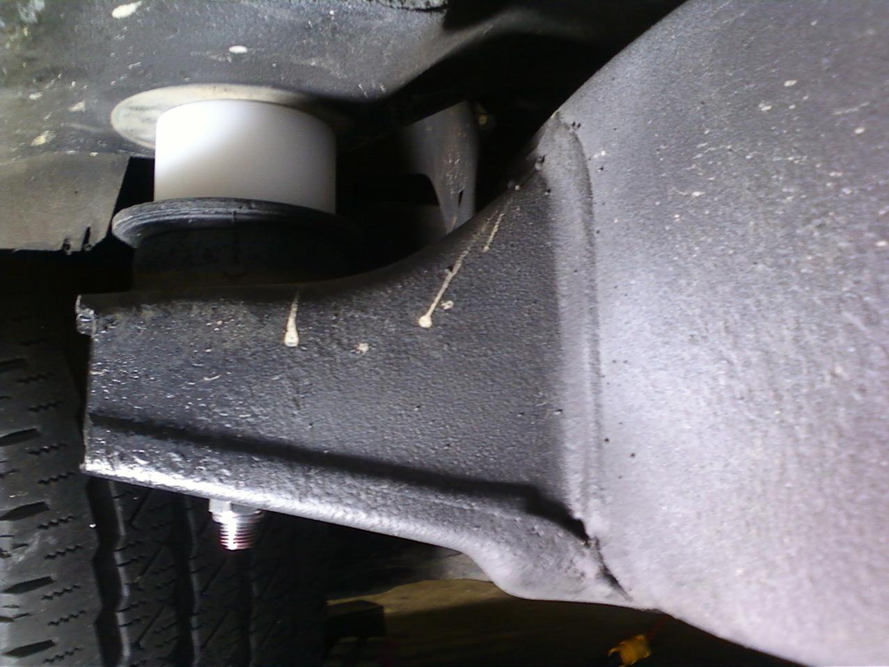

Did you take the bumper off for installation? I didn't, and I don't have a gap like that at all.
Also did you take note of the different sized pucks for the front body mounts?
I kept the bumper on then entire install. As far as the blocks go, I had [email protected]" OD and 2@2" OD. All were 1.5" tall. Just kind of odd to have a rake after all is said and done. Owell, no biggie.
The bumper will have to be adjusted by moving it up a notch but will most likely hit that on Monday. My hands are shot.

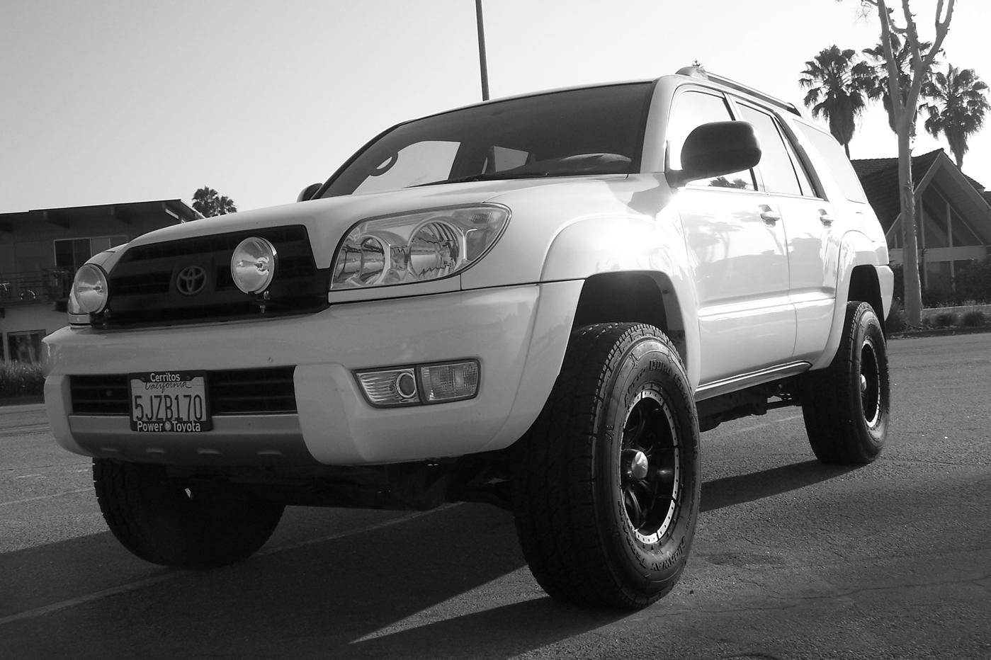

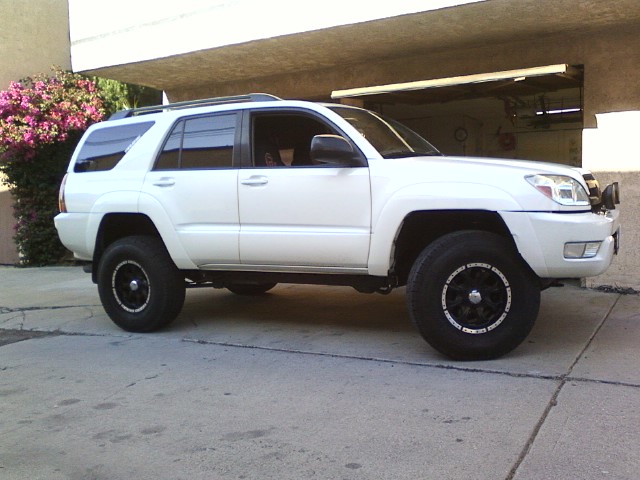

Here is a photo from my phone of the BL, Nitto 285/75's and Helo rims. Test drove it earlier and those E-Load tires are certainly stiff.
It does look good, esp with the larger tires, but are they rubbing? Looks like it rubs in the front in that last pic
I did some pretty serious trimming to solve 99% of the rubbing. there is a small small area that needs to be done but it is only on the inner wheel liner. I will most likely just move it forward like I did before and it should technically solve the last 1%. truck rides super good even with the E load tires.

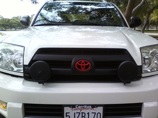

As far as the gap goes, I think I have it figured out why there is a gap there. My light bars are squashing the front bumper down so i will take those off today and see how much it lets the bumper come back up. I hope that is the problem, if not then I will move the bumper up a notch. You can see how the lights are over firmly sitting on the bumper.

Well that's good. You should probably get yourself a grille guard/bull bar or better yet a shockworks bumper or one from here: :: Tactical Armor Group :: Store It'll add the aggressiveness factor to your rig. If i ever lift mine and add large tires i'd probably do the same! Overall that looks like it took alot of work to lift by yourself but it looks great! BTW how did you make the front emblem red?
Thanks for the link 4Runners. Texas huh. Boomer Sooner here but stuck in California!
I have done all of my own work. Just dont see why I would pay a shop to do it when I like to think of myself as pretty good with a wrench. The BL took me a super long time by myself, almost 9.5hrs but that is becuase I ran into a few issues and the kids and neighbors kept coming down to the garage slowing me down. All in all, a great learning tool doing it myself.
As far as the front toyota being red, Carefully unsnap it from the grille, take some 400+ wet/dry sand paper and scuff it up a little. Not too much becuase it is plastic. I then took some rustoleum primer with 2 light coats and then hit it with 2 coats of rustoleum red gloss paint. let it dry over night and snap it back on. total cost..about 10 bucks in material with plenty left over for other things like my custom skid plates.

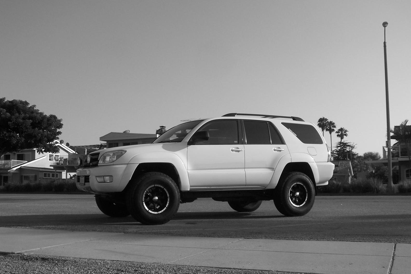

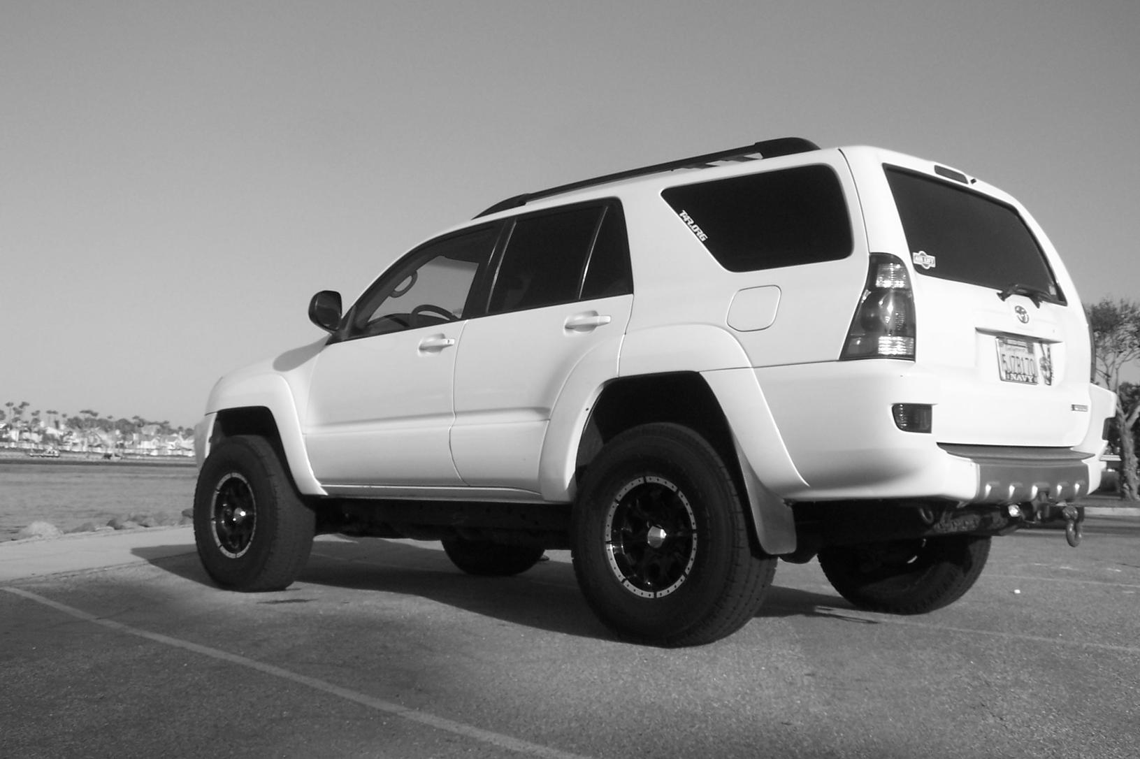

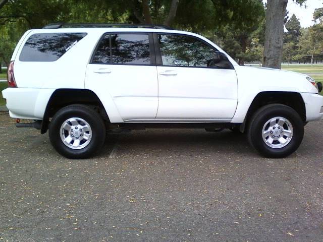

Lift and tires done
So the 1.5" BL is done. 285/75-16 Nittos and Helo Max rims on. Bumper relocated and sittin pretty now.
I had some more plans but some jacka@# hacked my account and took all my money. Bas****!
Any hoot, I still have more to do but for now I think she looks sweet.

Very nice! Glad you got the bumper problem fixed. I was wondering, how did that happen in the first place?
my understanding is that the front bumper is mounted to the frame itself so when the body goes up, the bumper stays in place. i unbolted the 4 bolts on each side of the bumber rail, moved it up a notch and now all is good to go.
