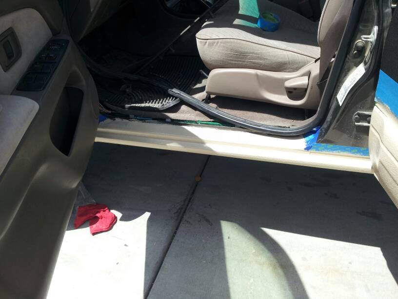

the door jams are not finished yet. I'm planing on spraying them to match. I felt if we used the liner in the door jam it would build up too much and might damage any seals that rub on it, we masked off at the inner door seal and allowed some over spray to make a nice transition from textured to smooth
It doesnt. I used it for the bottom of the jambs. It's been there for a while with no damage done to the seals.

Did you liner the jams as well? (Including the rockers and the inner door) Or was the liner too think that it rubs?
No, and when quoting pics I recommend deleting the photos from the body of the quote so that users don't have to see the same pics twice.
