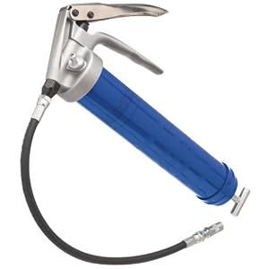

I tried to grease the drive shaft zerks with my new grease gun, but the tip of the hose would not stay on the zerk and grease was coming out of the sides without being pumped where needed.
The question: are all the gease gun tips standard? Or should I look for a specific size/model to fit tightly on the zerks?
I think they're pretty standard... My tip is adjustable so that I can tighten it to make it hold onto the zerk better, or loosen it so it'll pull off easier. I find there's a happy medium where I can put it on the zerk and take it off without too much effort. Any tighter and it's a big pain in the butt to get it off, and any looser I experience the same situation you're describing.

Nah, they're all the same. You need to keep the tip exactly vertical to the zerk in both directions and you need to use force to hold it in place. Forget using two hands to pump. One hand needs to stay on the tip with a hose type tip. Sometimes the zerk is just effed and needs to be changed out.
This is MUCH easier to do with a pipe tip than a hose tip. Unfortunately, the pipe tip only works if you have a lift available. My pipe one does all the 40 or 50 zerks on my tractor and its implements and it's a pleasure to use compared to the hose one that I only use on the 4Runner.

A grease gun - is a grease gun, heavy duty or regular, does not really matter to me, mine pumps grease ok. It's just the hose coupler gives me problems. If you put the right coupler on the hose it will work. And vise versa - if you put the bad coupler like mine on any gun, it will be a mess.
Pistol grip grease gun FTW. No need to have both hands involved pumping the grease.
Better yet is the cordless Lincoln, but not exactly justifiable unless you have equipment with lots of grease zerks requiring regular lubrication.
This is only $26. If you're paying $13 for a grease gun you're gonna have problems.
This. I hated using grease guns with a passion... grease leaking out the sides, never getting it to disengage... generally a horribly unpleasant experience...
I then bought a second grease gun for the Moly grease points, as its easier having one loaded up with each grease type... I got a Draper one and it was a totally different experience to use.

I do tree work, lots of grease fittings to keep up with. We just picked up one of these:
LockNLube | Grease Gun Coupler. Free US Shipping over $25
Locks on to fitting with spring loaded jaws, keeps grease in the fitting.
Works great, except for the fact it is too bulky to get in some tight spots. We just run a few dif gun setups, the straight pipe is definitely nice when you can get away with it.
OP, your fitting may be bound up. Try replacing the zerk, or hit it with one of these:

That was for the tip the op provided in the link. He said it costs twice what a gun costs. He must be buying some cheap guns. A good gun starts at $40.
Yeah, this thing is like $30 plus shipping and taxes. I admit, I bought one cheap gun, it cost me like $16.
But the problem is the coupler, not entire gun. Or the zerks. Like the last post says. I bought my track at 95K in 2011, and yet to grease the shaft. I doubt that the were greased before either, so I might need to replace the zerks I guess...

I only asked a question about the coupler, why doesn't it stay on the zerk. And customer rep replied, they will be sending a new gun to me. It's already arrived. I guess I will give it a try.
Great service they have...
