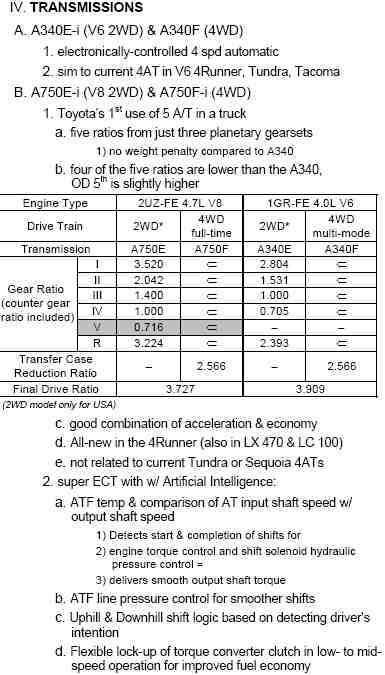

I have 2005 V6. I love it and do think it was the great choice. I think if do not need extra 2000lbs of towing, you do not need V8, plus I like to have 2WD option especially in snow and other sleepy conditions, gives you driving fun. I do have 265/70R17 Revos - no rubbing. 4Runner is a great though truck, I've friends from off-road club who driving 1st and 2nd Gen for years without any problems. The idea is to maintain it well and the truck will thank you for it.
What about axle ratio ? That link show's 03's which do have different spec's than the 06..
Also that chart show's 91 octane ...does that hold true today for the 06 ??
I can tell you one thing, after selling the same vehicle you are driving for my Runner, I would never go back. Toyotas are the shiznit. I used to hate how my Chevys doors would creak when I pulled on them to close them, how the steering would clunk every 15k miles or so, and how the leather looked old after about 2k miles. I did not realize how much all of this bothered me until I drove the 4Runner and saw how solid it was. In terms of refinement, it is truly in a different league. I am happy with my V6, but if I bought another one I might get a V8. Both engines will smoke the Tahoe. My V6 actually maintains higher speeds up long grades while towing the same trailer than the 5.3 in my 'ho. As to the gas, you can use 87, 89, or 93. The ECM will adjust accordingly. I am sorry, but I dont know the rear axle ratio. It is probably in between the 3.73 and 4.10 you can get in the Chevy.
The differential ratio is the axle ratio. To the best of my knowledge, this spec will not change from year to year for the 4th gen. For 5-speed tranny the axle ratio is 3.727

1. I'm pretty sure the axle ratios listed in the table have been the same all the way through '06.
