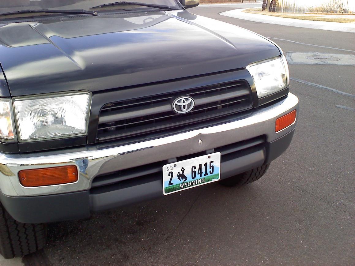

You just gotta prep it better man. That chrome is still really shinny under the paint. Mine was chrome until I painted it black as seen below. After I was done sanding it just looked completely dull. It gave no reflection whatsoever. I drove 1000 miles across country after painting it and hardly anything chipped off. Also, how long did you wait before putting that tape on? Paint needs at least 24 hours sitting in 70 degree + temps to cure. So its def possible to paint the chrome. Its all about the prep
